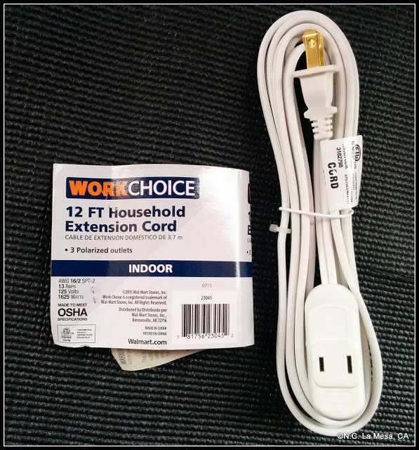

    If you're going to have your dash apart for another reason, I would definitely plan on doing electrical at the same time. My advice is this, make a plan beforehand, and specify whatever outcomes you want before you take the dash apart. Scope creep tends to be an issue for me when the panels are apart... i.e. Gee, I can run a wire into the center console for powering accessories in there too... Mmmm k...
    Also, If you need wiring for in the cab, I recommend skipping auto parts store, and going to your favorite home store, and buying some extension cords, cut the ends off and you got yourself some quality 2-conductor 16AWG copper. :thumbsup:
    This one pictured below is rated to 1,625 Watts! :eek: :)

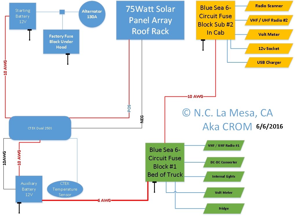

    Crom - From Battery: do you run a neg cable as well from the battery, or are these grounded to frame? Same question on the Sub #2 fuse box: Do you run a neg cable from Sub #1 fuse box to #2? Its looks like its grounded to frame on your new diagram. Just double checking.
    Also, would you mind sharing exact Bue Seas Fuse Blocks that you use.?
    Thanks again!

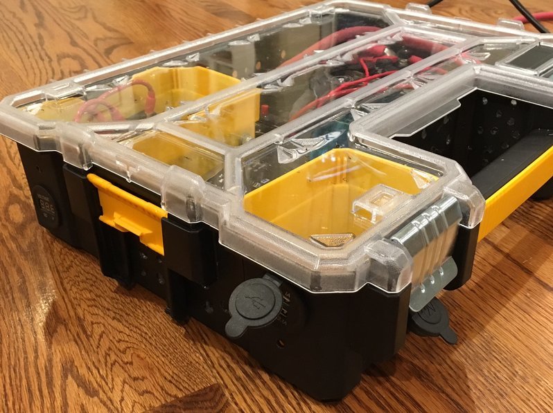

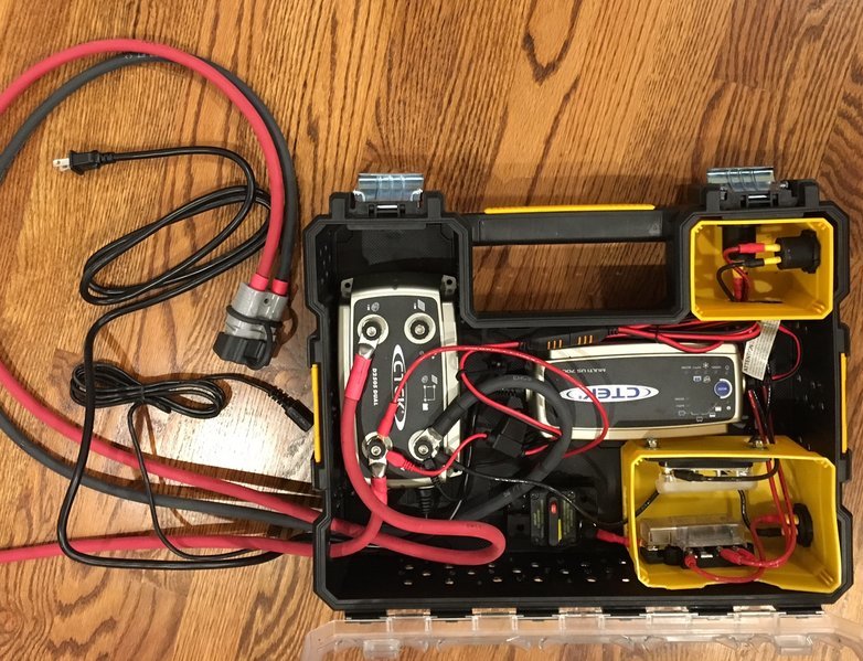

    I'm putting the finishing touches on my cover of Nick's second battery setup...

    That is an interesting looking setup. I see that you have a CTEK dual d250s and also what looks like a CTEK 120v wall charger in that case. How are you using this thing?
    ChadsPride likes this.

    Run off battery, and run from fuse block. I'm using 10-AWG zip-cord to make my connections. But you don't have to do it this way. It's not better, and it's more expensive, but perhaps more convenient. I think it's best practice to keep the grounds as short as possible. You can use the frame, cab body, or run off the battery.
    EDIT: Here is the fuse block I'm using
    A great tool for finding suitable grounds, is an automotive test light.

    That looks wonderful! Well done! I'm a huge fan of making things modular, portable, and easy to service for maintenance, upgrades, changes, etc. It's a big time saver.

    This is Nick's idea for a second battery setup that I adapted slightly. I will use this in the truck bed along with a deep cycle battery to power my ARB fridge, lights, chargers, etc. I saw the Dewalt toolbox while at Home Depot and my cerebral gears started turning.
    I really like how the Anderson connectors allow rapid disconnects to free up the entire truck bed quickly. Can also do a quick disconnect and reconnect to jump start the truck if needed. I ran a 2 gauge wire from the starter battery to the rear setup.

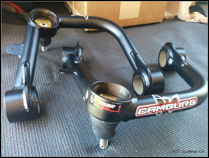

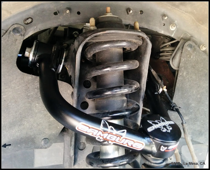

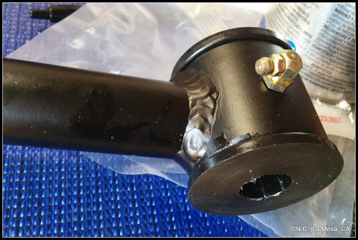

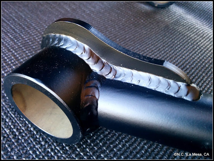

    Camburg Ball-joint UCA's are in! (~67,300 ODO)
    Over the weekend I tossed in some new Camburg Ball Joint UCA's. It's really great to have some caster back, and my rig drives and tracks great again.
    The Camburg arms come with a Moog K80811 Ball Joint pressed in.
    There is some additional setup time involved with these UCA's which makes them a little different from a factory arm. I had to thread on six (6) self-tapping zerk fittings. One for each ball joint, and two for each arm. Easy to do. The poly bushings got greased and press fitted into the arm with light pressure from bench vice.. It was somewhat difficult to fit the washer in between the frame and bushing for final assembly on the truck.
    Fit and finish on the Camburg is excellent. Everything was packaged really well. The instructions were detailed such that I was told what to do, what not to do and in some cases why. Very good IMO.
    I don't know what manufacturer made the grease for Camburg, but it was unlike any other grease I've worked with. I know it's PTFE based synthetic. It was incredibly tacky and waterproof, like I couldn't wash it off my hands! lol
    I speculate that it was Prothane Super Grease.
