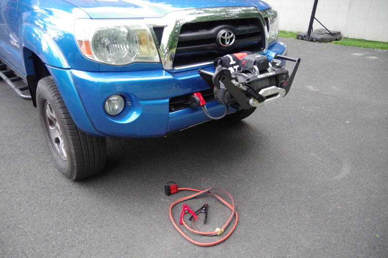

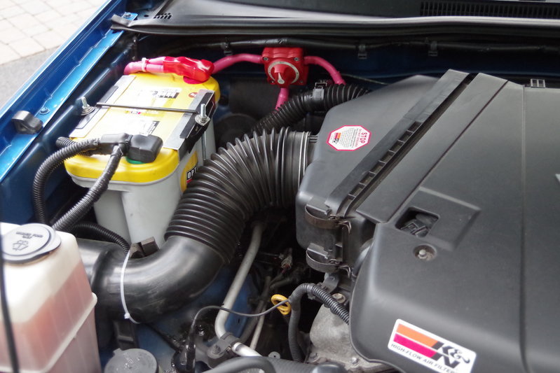

    Ya it's the heavy gauge wire running to your CTEK that had me confused. I have a CTEK installed in my truck too and it only calls for #10 AWG wire.
    So you just ran the heavy gauge wire so that you can disconnect it from the CTEK and connect it directly to your deep cycle to jump start the truck from the second battery without having to remove the battery from your bed?
    Neat idea.

    Thanks!
    This is now officially on my list of things to do: I'll install the Blue Seas fuse box in the cab with Pos and Neg cable from my aux battery to power up accessory doodads. Blue Sea recommends up to 125AMP circuit protection between the fuse box and 12V Battery.

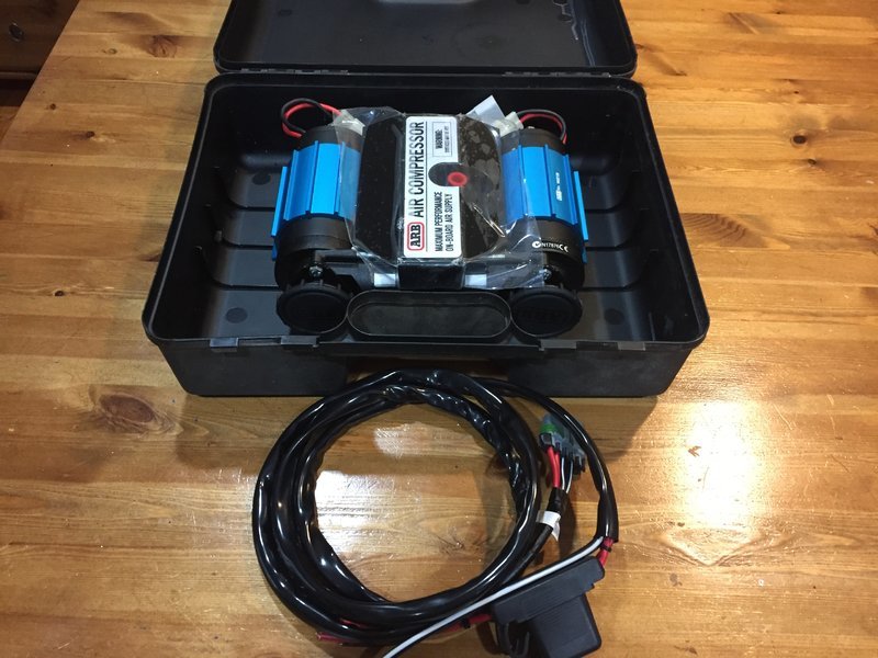

    Nick - My ARB twin landed on my doorstep and need your advice... again.
    1. Will be permanently installed in an old pistol case. No plans to hard mount.
    2. Power will come from the power that supplies my portable tray mounted winch. Aux Batt to Blue Seas switch to 2 AWG cables front and rear of truck.
    I will attach the appropriate Anderson Quick Connect to the dual red wires and the dual black wires of the Compressor Harness (instead of the battery clamps that you used). Similar connectors are on my jumper cable.
    Questions:
    What is this jumper wire that you speak of?
    I'd prefer a switch because those Anderson connectors are not easy to disconnect. Takes real effort to pull them apart.
    If you were going to install a switch. Where would you put it and what kind switch?
    What else would I need to do to make this work?
    Thanks so much!!!!

    What winch set up is that? Going that direction. Like the second battery location, too. Sweet.

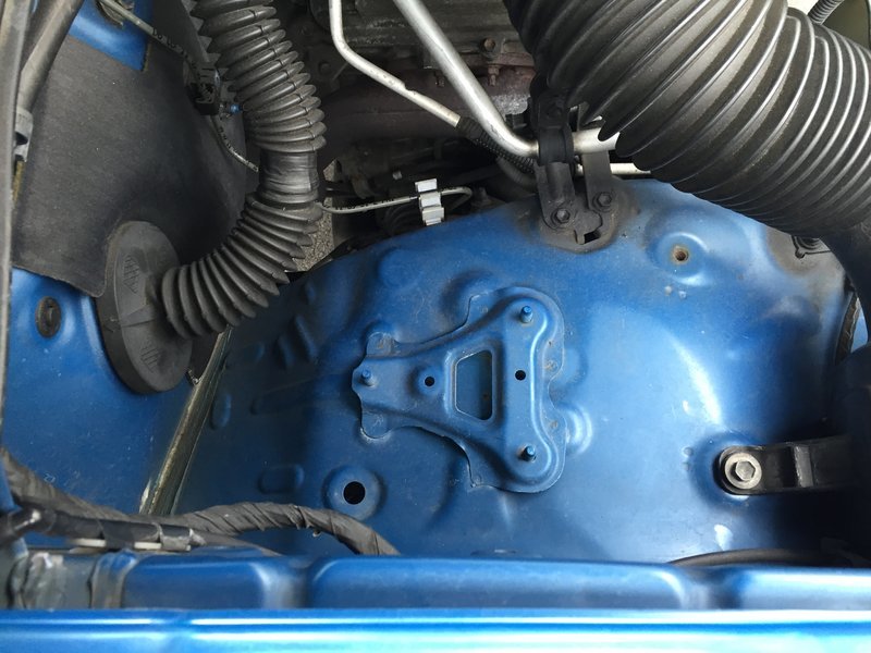

    How's your battery mount working out? Mine broke loose and I have yet to figure out a solution.

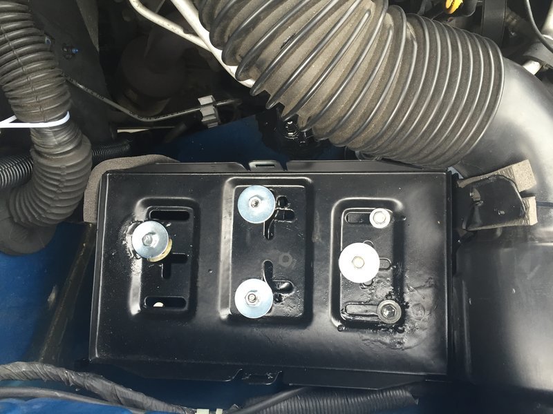

    It pretty solid. I used the three studs on the fender, the threaded hole at 2 o'clock on the pic, and also the threaded hole that's used to secure the air intake. Its about 4 o'clock in the pic. I cutoff the plastic mounting arm of the intake.IMG_0014.jpg IMG_0120.jpg

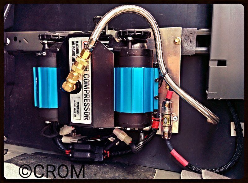

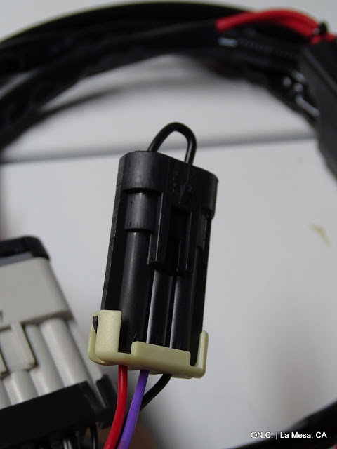

    Of all the topics in the forum we discuss, none are perhaps more difficult to speak to than electrical. I advise making your own thread, because answers often lead to more questions until an understanding is reached. If you do make a thread, you can tag me in, and I'll try to help.
    What I did in my portable install probably isn't that relevant to you, but I will explain what I did...
    I rejected ARB's switch and wiring harness and didn't use it all, I rolled my own instead.
    In my case, a jumper wire is a small piece of wire used to complete an electrical circuit.
    I used a short piece of 16 AWG wire.
    The jumper wire was inserted into the switch harness connector, to create an electrical path between the red wire (which supplies +12v), and the purple wire.
    The red wire is not used at all in a normal install of the compressor. It's only there for diagnostic purposes so ARB can validate the product sans wiring harness, at assembly time in their factory, or warranty diagnostic, etc.
    In this configuration, the compressor will run, and only the pressure switch will interrupt the circuit and stop the motors.
    Once upon a time, I pulled the compressor apart and took this photo. I just marked it up for you.
    Hope it makes sense.
    You can't see the switch harness connector in this photo; it's tucked in there, but the jumper wire is still there! I secured it with some dry vinyl tape then normal electrical tape. My own hillbilly engineering! :D
