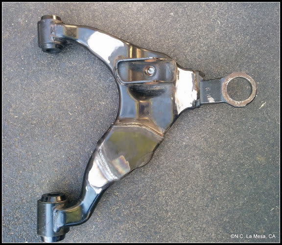

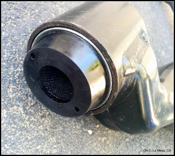

    Whiteline W53312 Front Control Arm Bushings fit in the Tacoma LCA!
    I am super excited to report that [​IMG]Whiteline W53312 Front Control Arm Bushings fit in the Tacoma LCA!!!
    I had these pressed in about two weeks ago by Jeff @jeffz0rz of JTA Metalworks, who is local to me. Thank you Jeff!
    I also had him weld shut all the drain holes in the LCA and fill in / reinforce where the arm attaches to the bushing eye.
    I'm so stoked! Finally way out of LCA maintenance hell!
    After some ball joint pressing, I'm gonna slap them in!!!
    Enormous thanks to @Milowilli who advised me on the bushings!

    I like those bushings! I am curious to see how they do and how you like them. When the time comes for my truck, they look like a good upgrade.
    However, I seem to missing something.
    On my truck (a 2015 model) the lower ball joints are bolted to the LCA not pressed. Did Toyota change the design?
    Crom[OP] and ChadsPride like this.

    As far as I know the design has never changed. :notsure: LBJ is pressed in, and steering stop bolted to LBJ, and steering stop bolts up to spindle. Take a picture of yours and post if you like...
    ChadsPride likes this.

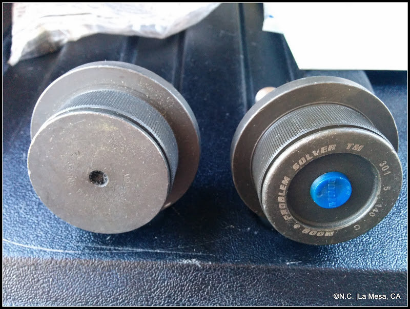

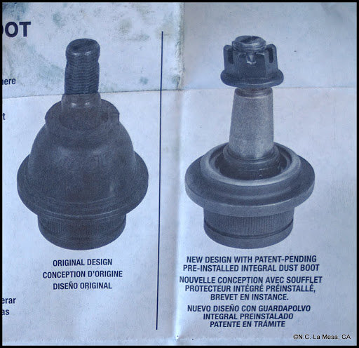

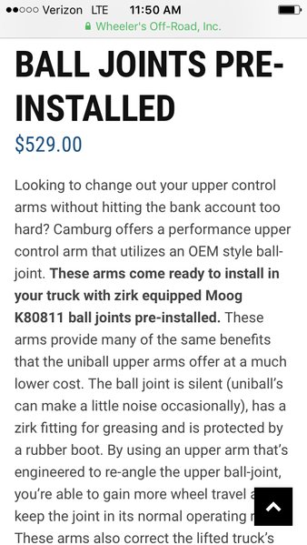

    The Moog UBJ grease /dust boot split on my passenger side, on the new Camburg arms. :( Moog sent me a new dust boot, but f*** what a pain.
    Now switching topics to lower ball joints...
    These LBJ pictured below have identical part numbers, Moog K80827
    The one on the left is of older design, newer one is on the right.
    And the one on the right is complete, no more umbrella dust boot.
    Moog K80827 Ball Joint

    That's right. The Moog K80811 is the aftermarket replacement for the Toyota UBJ, and that's what Camburg is preinstalling in the arms for us. The boot splitting might have been partially my fault, but I very much feel that the boot design is just too large, which makes it wrinkle up and eventually it splits. I'm gonna ask for pics from other owners of the Camburg arm to see if there are any visual differences in the boot. AFAIK, I haven't heard of any troubles with them.
