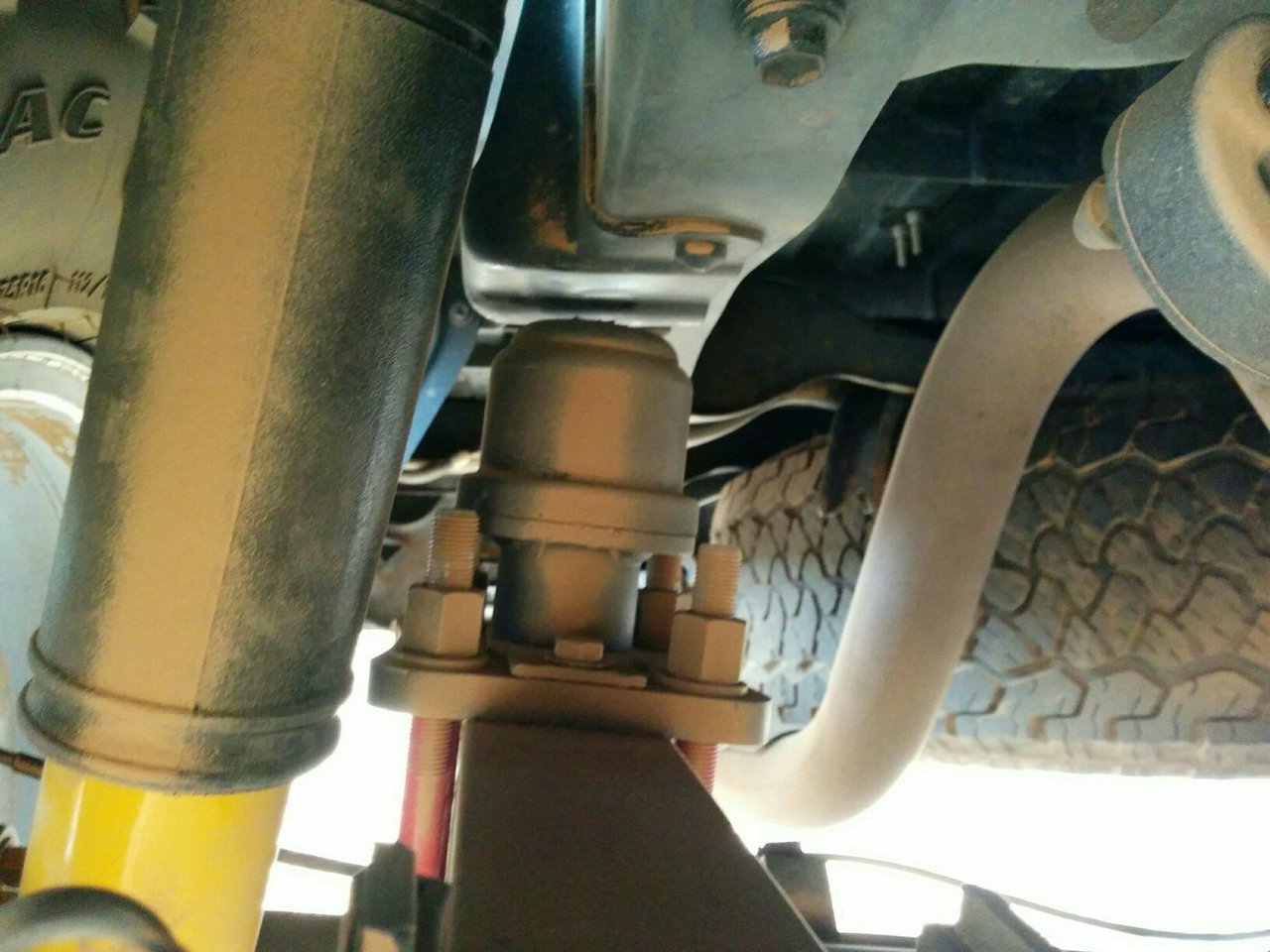

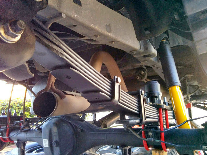

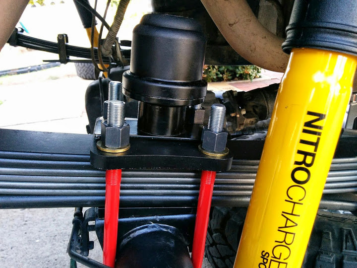

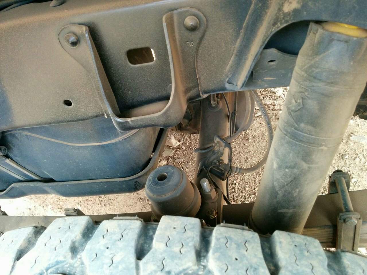

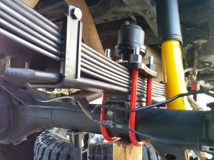

    Rear suspension is done. Truck drives amazing. Zero unwanted vibrations 0-70 mph.
    EDIT: 2016, August. I swapped to longer brake lines and Bilstein B110 shocks in the rear in December 2015 which gave me 3" more axle droop at full flex, with no reduction in shock uptravel. The Nitrocharger shocks suck, because they are stock length, and I do not recommend them.
    See this post for more info about the current rear setup: Bilstein RCD/BE5-B110-T5 Shock

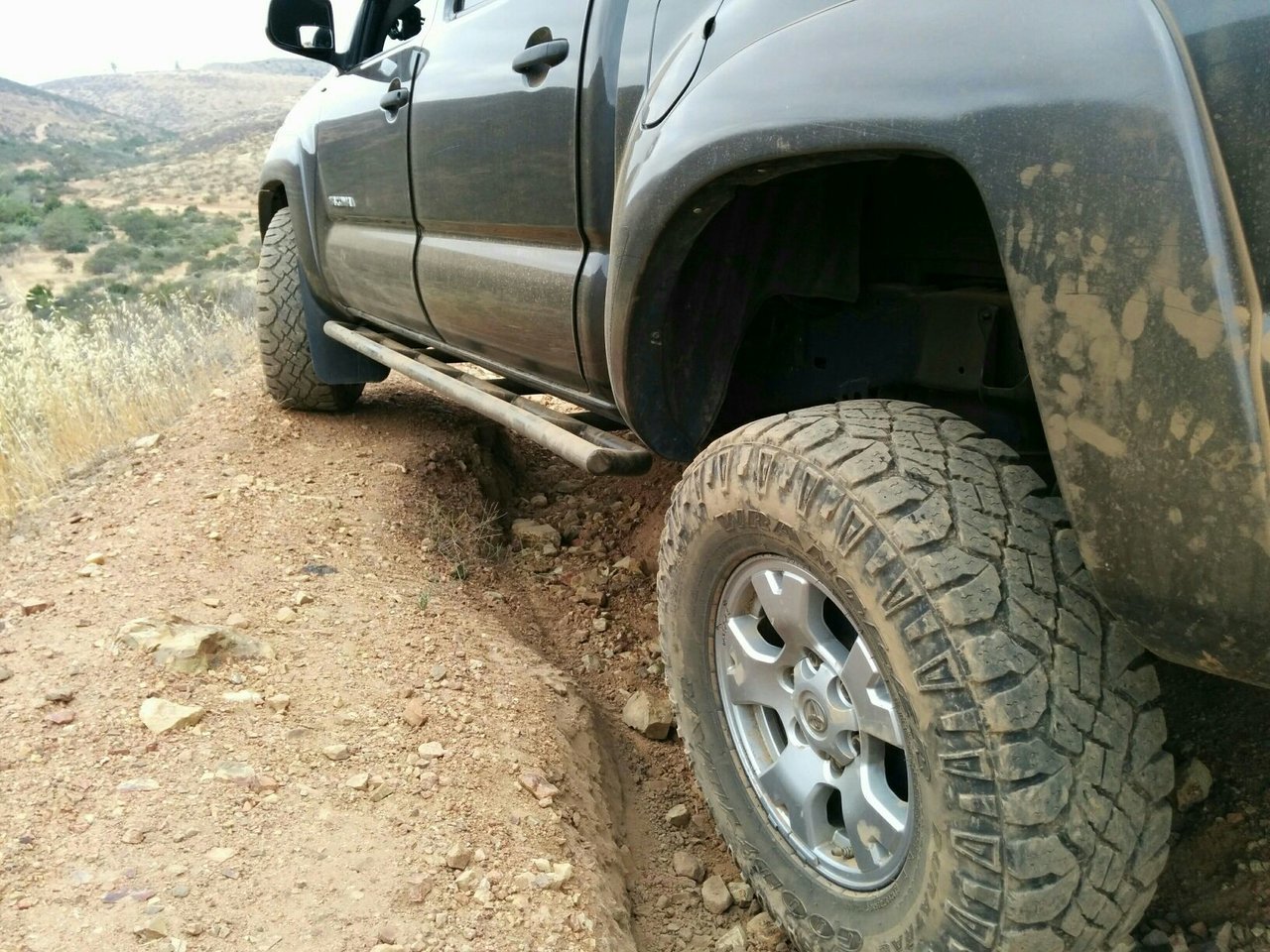

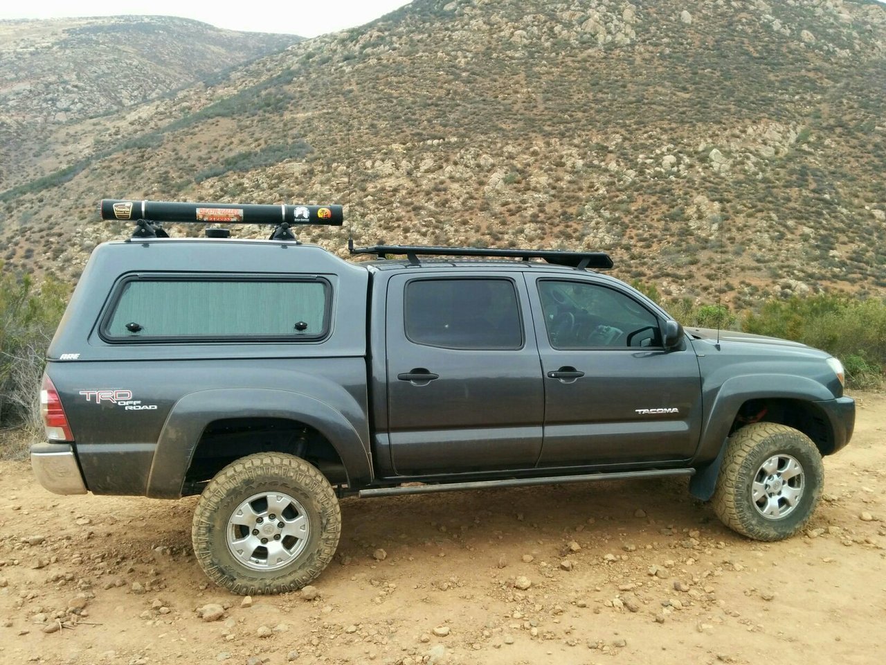

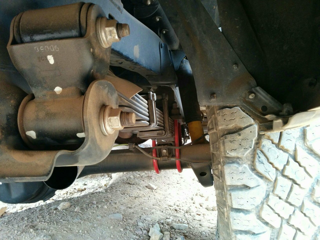

    Went to local trails to test suspension. (turns out the a-arms had a bad design and were contacting the coil buckets under compression!)
    Flexing the rear.
    Compressed side:
    Compressed side:
    lol - one of the leaf spring silencer pads I put in the pack was already coming lose. Haha.

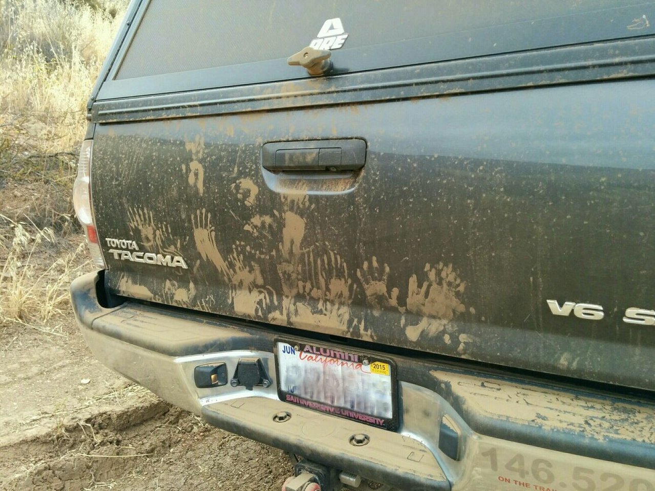

    There was lots of Mars lunar dust in this location. It stuck to all the previous invisible handprints. Lol

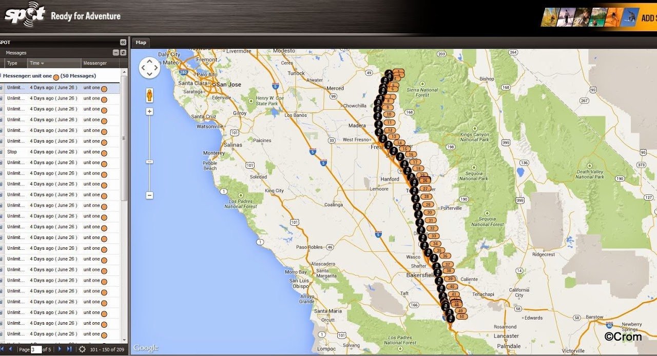

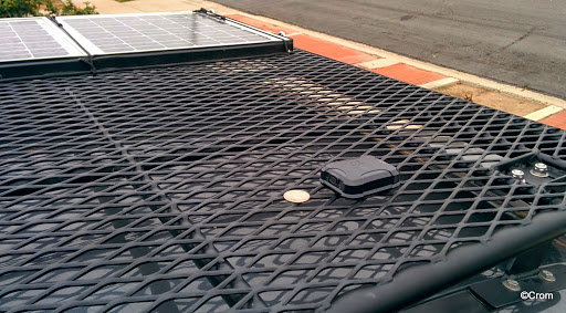

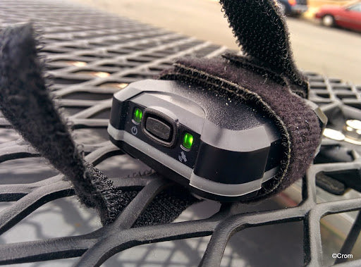

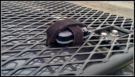

    What do you do if someone steals your rig, or tows it away?
    My answer for that is SPOT Trace. I did this mod about a year ago, and I love it. I receive a txt message that movement has been detected after the vehicle has been sitting for more than 30 minutes. I can track the movement from my mobile phone or the internet. I like that it's purely a satellite comm device and not in anyway dependent on cellular service.
    At the time, I had a rebate which made the device cost free with 1-year of service.
    Super small device. It's powered by lithium batteries, or +5v USB wired power. It is concealed inside the vehicle and fed from +5v USB constant power and backed up by said batteries. It even sends me email each day telling me it's working correctly. This is useful for when the truck is sitting for a period of time.
    Some pics of me "product testing." while driving to work last year. I put it on the roof rack for testing.
    Ready for the drive!
    Data from one of our family trips.

  9. May 4, 2015 at 3:47 PM

    would it still work if mounted inside/hidden behind some interior panel?

    I would think so. I would recommend emailing their tech support. It operates at 1610-1620 MHz L-band frequency. The product user guide says that it should be mounted so that a particular side (with printed satellite logo) facing the sky. This is because it has a directional antenna.

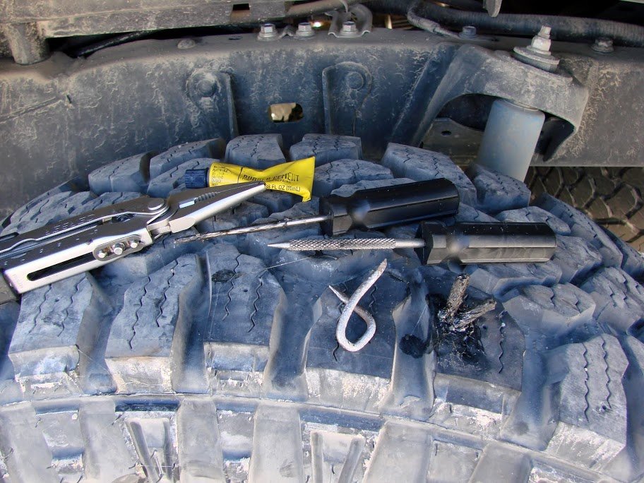

    I recently found time to take a picture of my tire care kit I put together.
    When I poke holes in tires, I find the holes and I plug them right on the wheel. No need to swap to a spare for a simple puncture. Plug it and keep going.

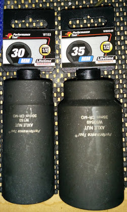

    fully zip tied
    ...dang made me go dig up the one big socket I have to see what it is, a 1 and 7/16, roughly 36mm. a three-quarter inch drive, has a dedicated breaker bar. used it on the hub nut of a VW transporter. also in this forgotten tool stash is a 17mm allen wrench, opened the transfer case fill plug.
    what is the socket size for the ball joints?

    Yes. I do. The hub nut is the largest, and the next largest on the Taco is 30mm for the rear diff flange, AFAIK.
    When you say socket for the ball joints are you talking about the castle nut? The Toyota factory castle nut on the UCA is 19mm. I have the JBA UCA with the big ass moog ball joint. The castle nut on that is 26mm.
    EDIT: You must be talking to the nut on the top of the ball joint for the LR UCA? That is unique to LR, so doesn't apply here.
    I don't carry any special tools for the ball joints, I do have a hammer :) , although I may pick up one of those $15 puller tools when the chance presents itself.

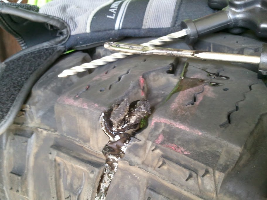

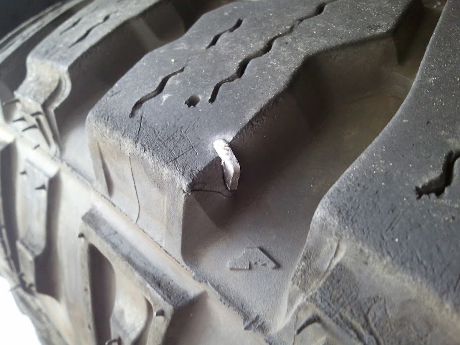

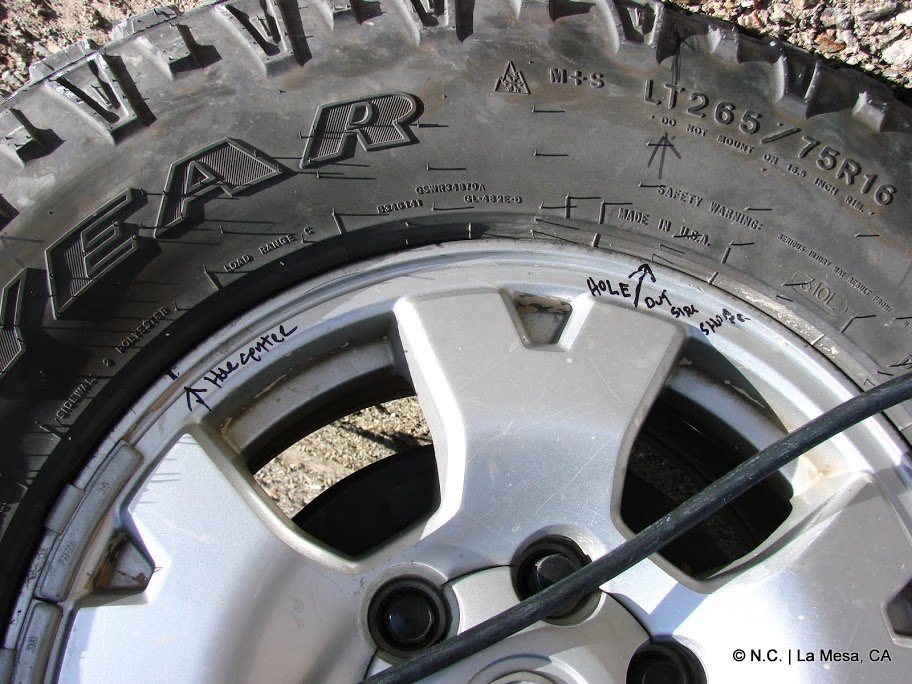

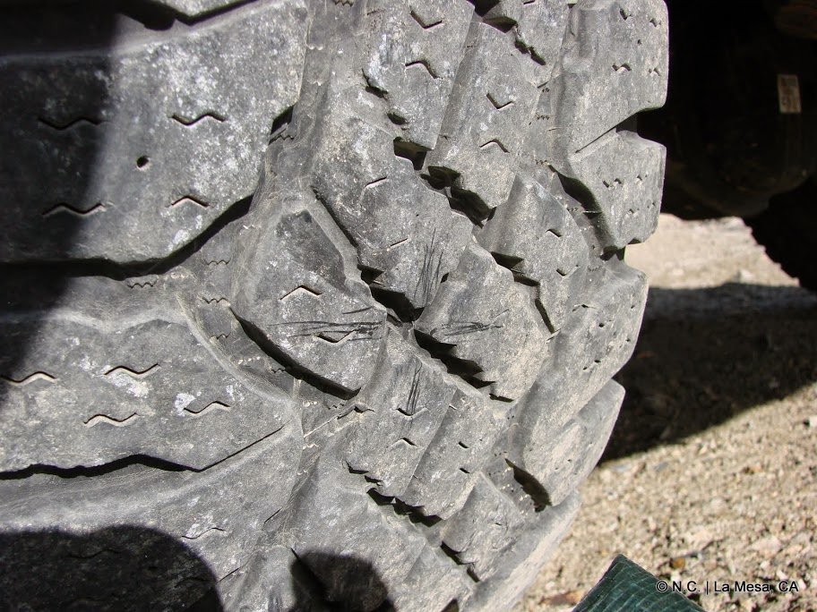

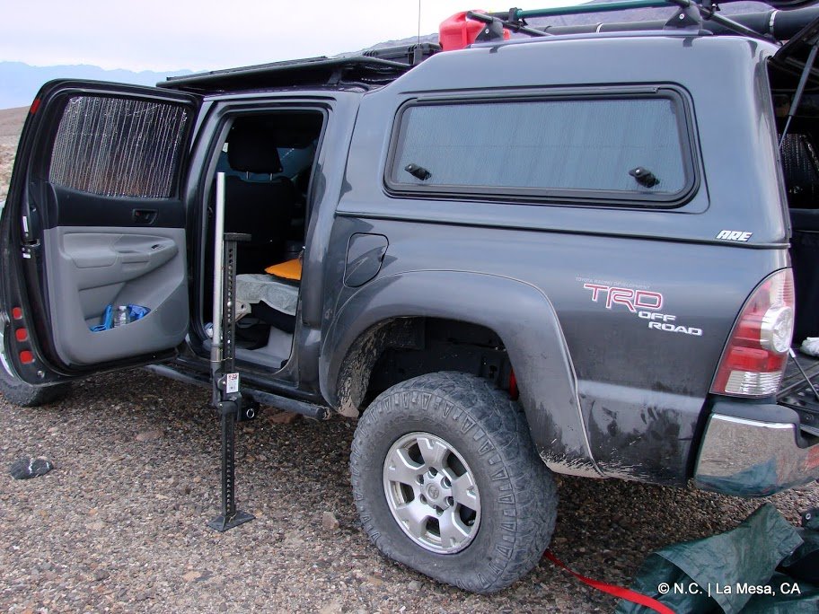

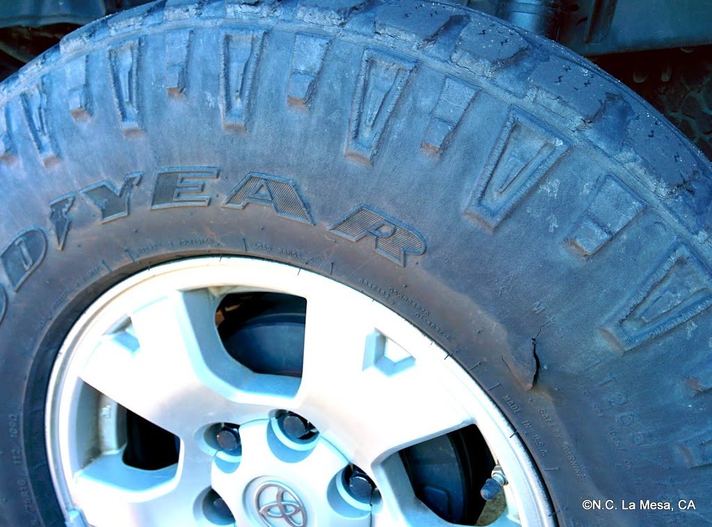

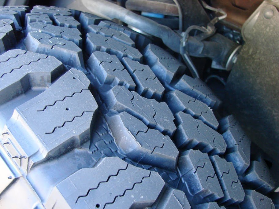

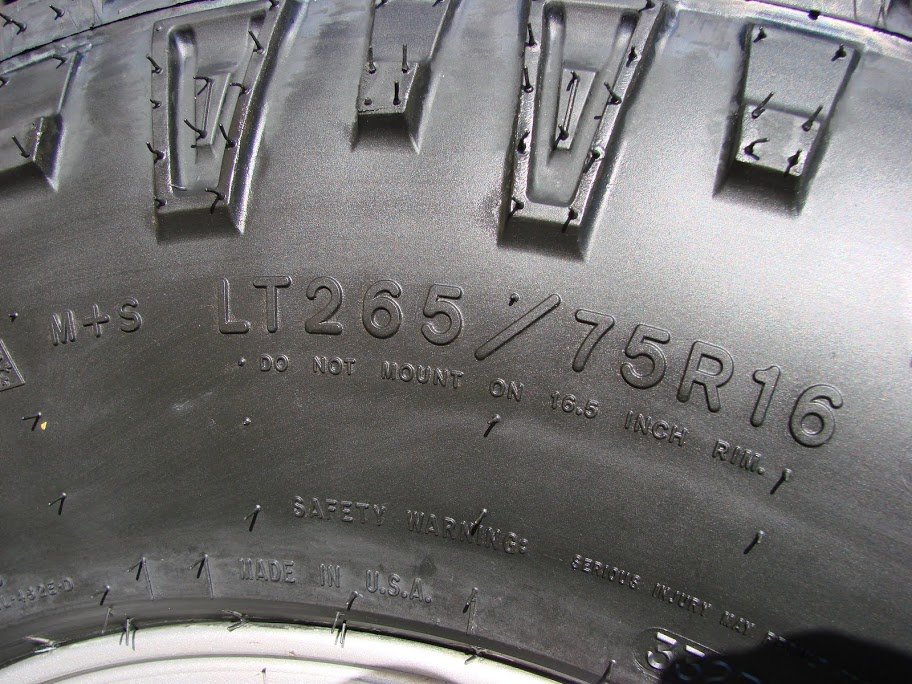

    The Duratracs. I have them in LT265/75/R16 load range C. They went on the truck in summer 2011 with 20K miles on the odometer. I loved the meaty lugs, and the excellent traction. I believe that my truck can go almost anywhere with them.
    In (4) years I have put 40K on them and I have 5/32" of tread left. The tires are still okay but they are getting quite beat and I worry about them. I'm currently saving for new tires.
    I've poked numerous holes in them since owning them.
    Shard of aluminum through the shoulder lug after (1) year of ownership, hole plugged and tire still ran fine. Shard was from the street.
    Mangled fence staple from first trip with new tires, into Death Valley in summer of 2011. Hole plugged and runs great to this day.
    In December 2014 while in Death Valley I poked two holes in the same tire. Full write up on the event is here. Once found, I plugged both holes and continued on my way. :D

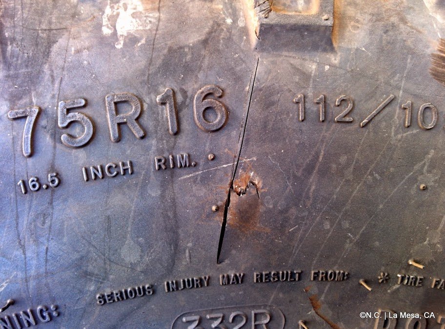

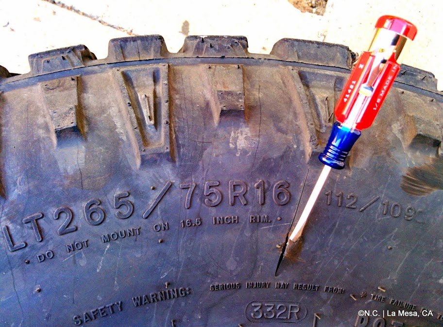

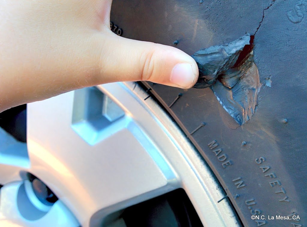

    I found a sidewall slice a while back. Not sure what did it? Sharp rock?
    I probed the slice with a screwdriver and although it looks bad, it appears okay for the time being.
