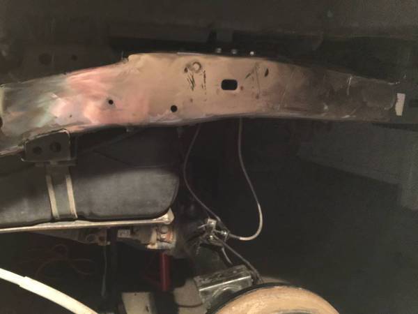

    A little teaser from the prep work. So much grinding and so much more to go! Also installed my new 26" brake lines from OCTaco.

    26"?? Why so long?

    Na, with the shock relocation and shackle flip the droop is ridiculous. They are only +4" over stock

    Interesting, I don't remember my stock ones being that long when I went steel lines. One day I'll go back to steel lines.

    Are you relocating the shock mounts on the axle? Or leaving one front, one back?

    Relocating to front. It's the Pelfreybilt relocation kit. Uses hoops

    I haven't looked that up yet but I was told you can limit wrap by doing that.
    Take pictures! Very interested in what you are doing

    Nice!! Did you cycle and measure?

    Yes sir, should have more pics up later. It was a long process. Glad I had Tyler to help and show me how it's done/ do the welding. Learned a ton!

    Pic before tires went back on.

    wow wow ^^ :thumbsup: how is your e-brake cable liking that? Kind of my worry as I'm about to go this route

    Looks like a lot of droop. What is the limiting factor? Are you going to strap it or do the shackles do that for you?
