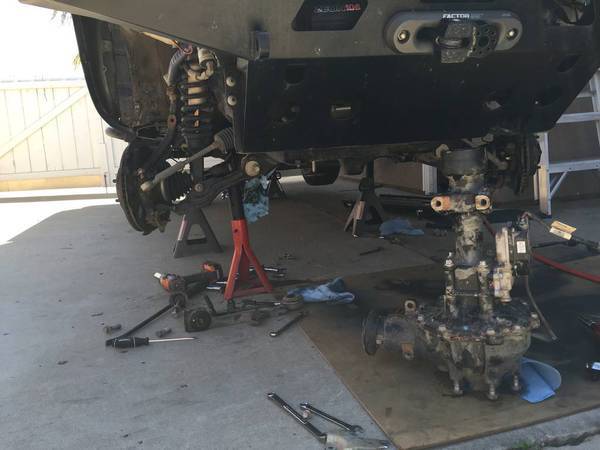

    Install is in progress.... The stub shaft to clamshell weird headed 11mm bolts stripped out. Was able to get three out with a impact, had to cut the third off. All apart though, just waiting on the new bolts and a gasket for the rear carrier to housing.

    Yeah, needed a bearing splitter. They are hard to come by, until I realized harbor freight had them. Hate getting harbor freight crap though. Should be done tomorrow night though
