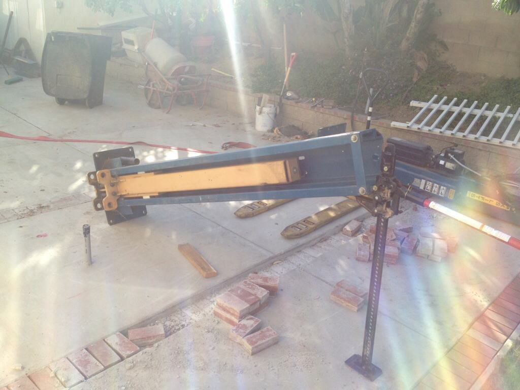

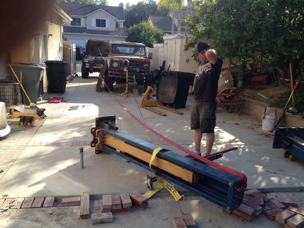

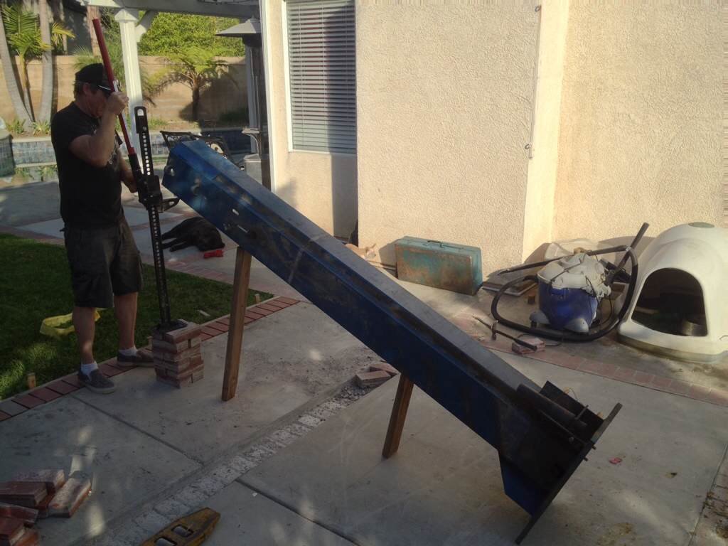

    Thought of everything EXCEPT how to stand up the 2000 lb hoist pillars. Simple in concept but....

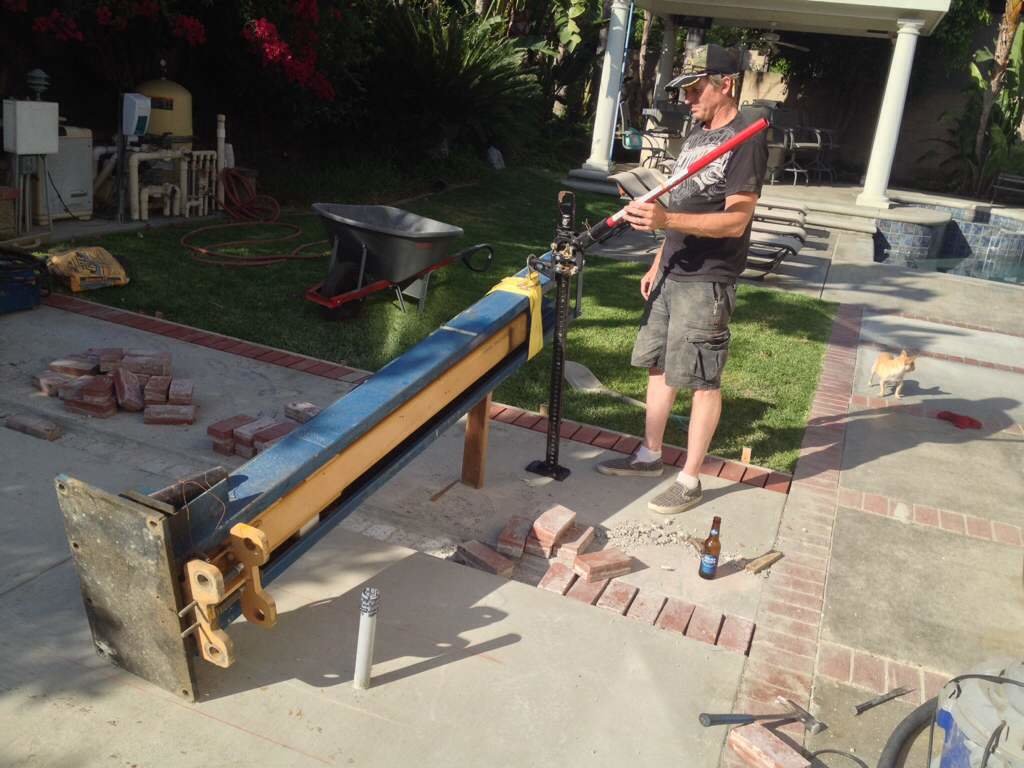

    Hi lift and a strap and scrap wood to hold it up
    That was nice and all but it got up about two feet and the hi lift slipped and almost dropped it on my feet. Not pictured is myself in steel toe boots for that very reason

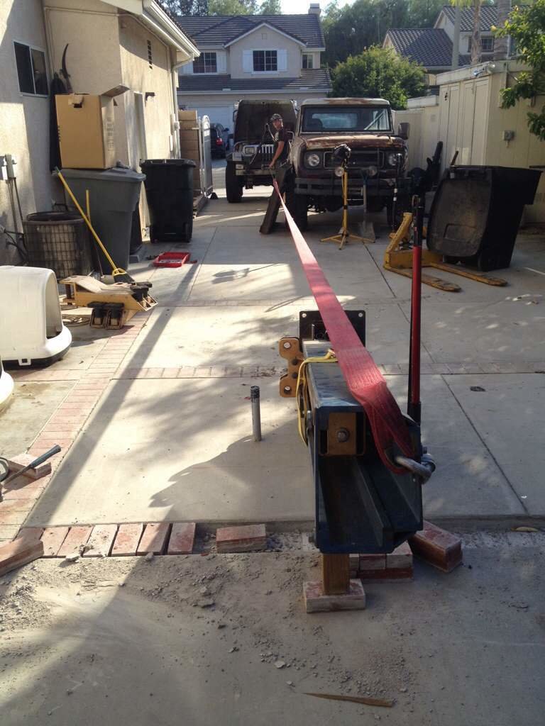

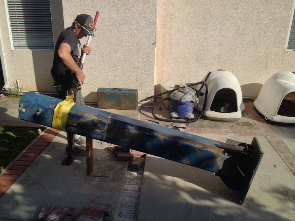

    Then we decide let's use the damn winch off the jeep! Duh.
    Which lifted it quickly so the bottom slid out and almost immediately dropped it on the ground and bent my hi lift...

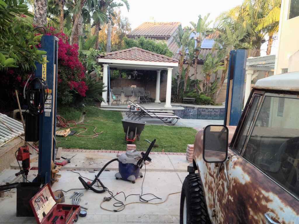

    END RESULT.
    We've got a little more work to do, but the lift is up and ready to work!

    "What could be better than having your truck on a lift ten feet from the beer fridge?" Not having it near the beer fridge would be my first recommendation.
    So.... I've got to ask. Is your concrete thick enough to support a lift like that. If not here's to hoping you don't get under it.

    Haha yes the concrete pad is thick enough and the footings below the lift bases are reinforced and 30" deep because digging and pouring concrete is easier than doing that twice.
    We did everything right
    except plan the execution of this last part.
