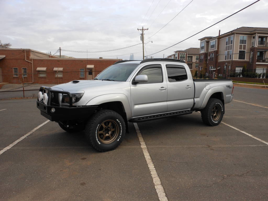

    Damn those new wheels and tires look good! *DROOL*

    and are your rims gray?

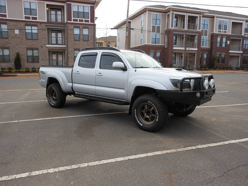

    Old rims are matte black, new ones are matte bronze.

    Wheels look good! Prefer the Konig Six-Shooter myself, but that's splitting hairs.

    Thanks man! The Six-Shooters look really good as well but I prefer the Type X :D

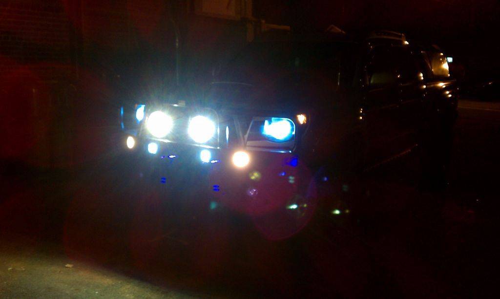

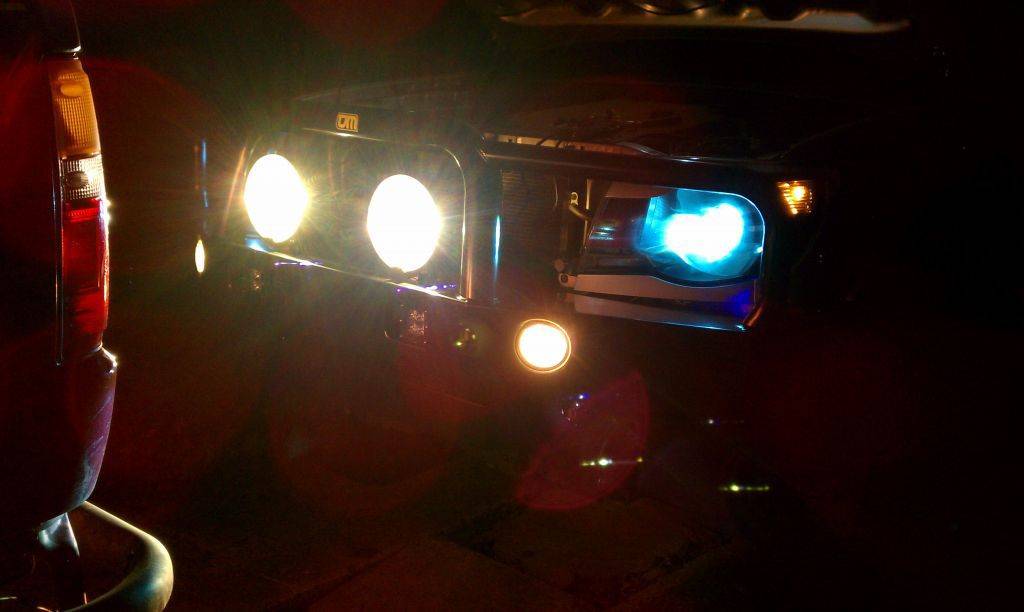

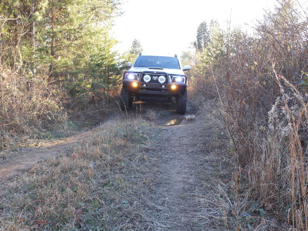

    I trimmed some front flap but will probably have to trim some more tomorrow. I really don't want to remove them.
    I finally wired the fogs in the TJM. I spliced them into the stock fog wiring and installed Nokya 2500k H11 bulbs.
    Here are pics of the fogs lit up, and then the 35w HID 6000k projectors with the fogs:
    HID's FTW.
    edit: I still need to wire the Rigid Dually's and Hella 700 HID's.

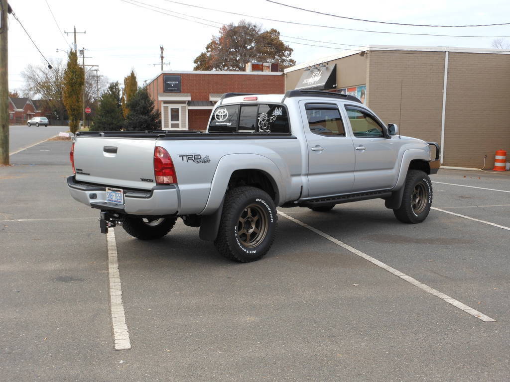

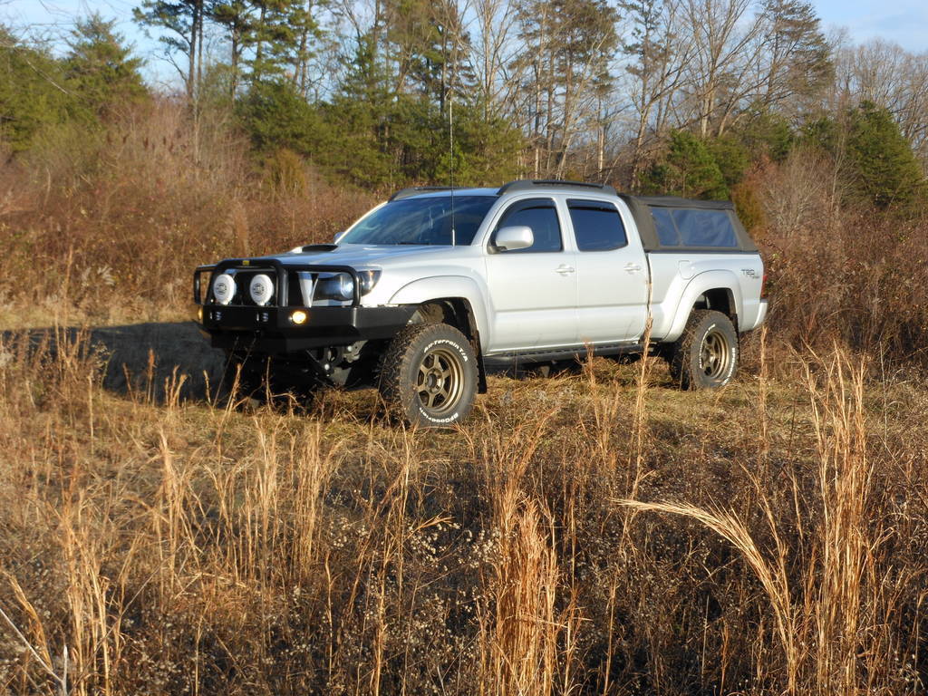

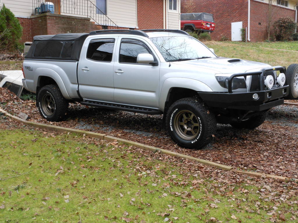

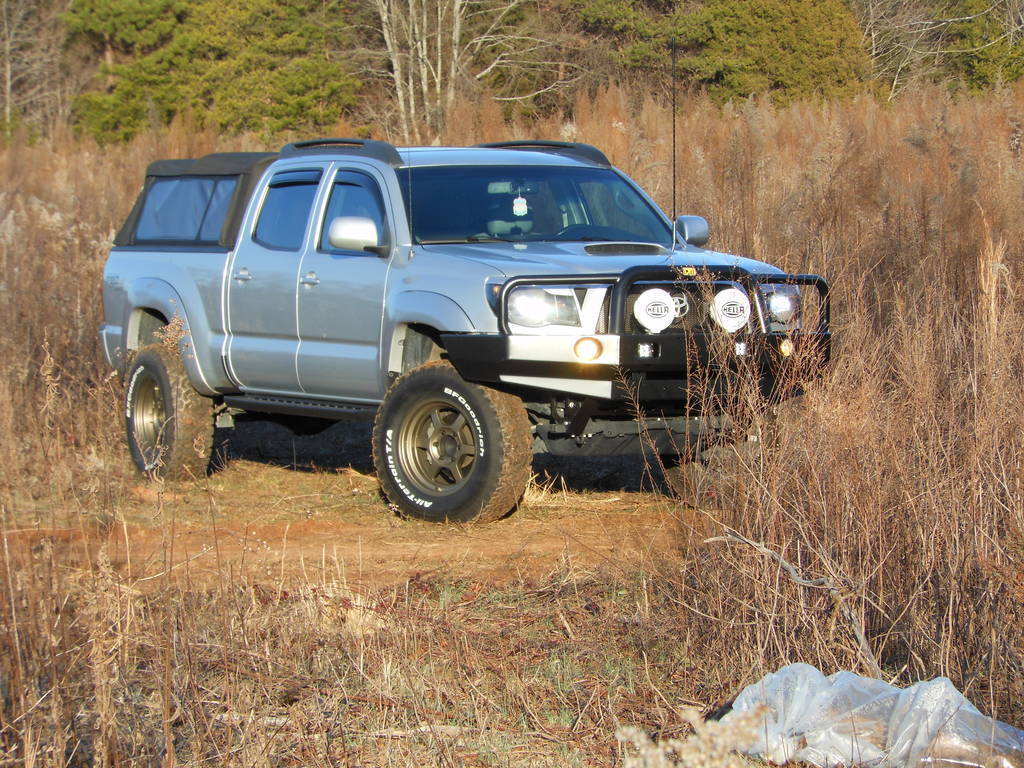

    I took the top off for cleaning but I haven't gotten around to it yet. I finally got a memory card for my camera and decided to snap some better pics of the new bumper and wheels. Enjoy.

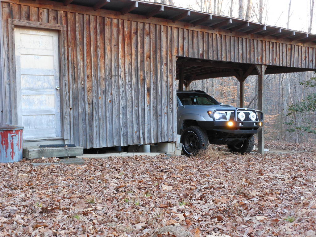

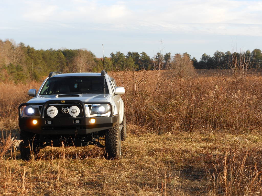

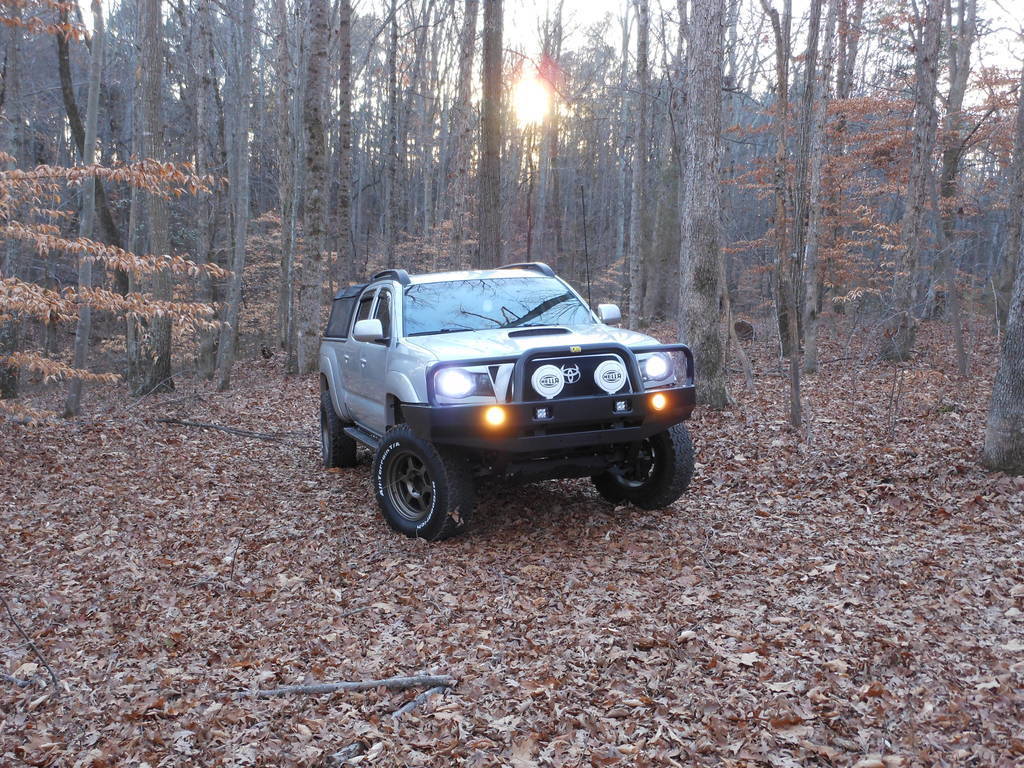

    Got my Relentless hood mount for the CB antenna. Did some exploring outside of the city yesterday and tried to tune it. I need to sand the mount and see if the Firering will ground better.
    At my late grandmother's property. I am hoping I can hold on to this lot.
    And finally wired the 55w HID Hella 700's.

    I finally got the CB tuned. I could not get it below 3:1, tried a couple things, got frustrated, then finally switched the 3' Firefly with a 4' Wilson flex and I got it to 1.4:1 on channels 1 and 40.
