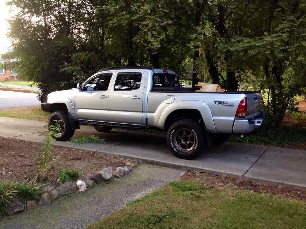

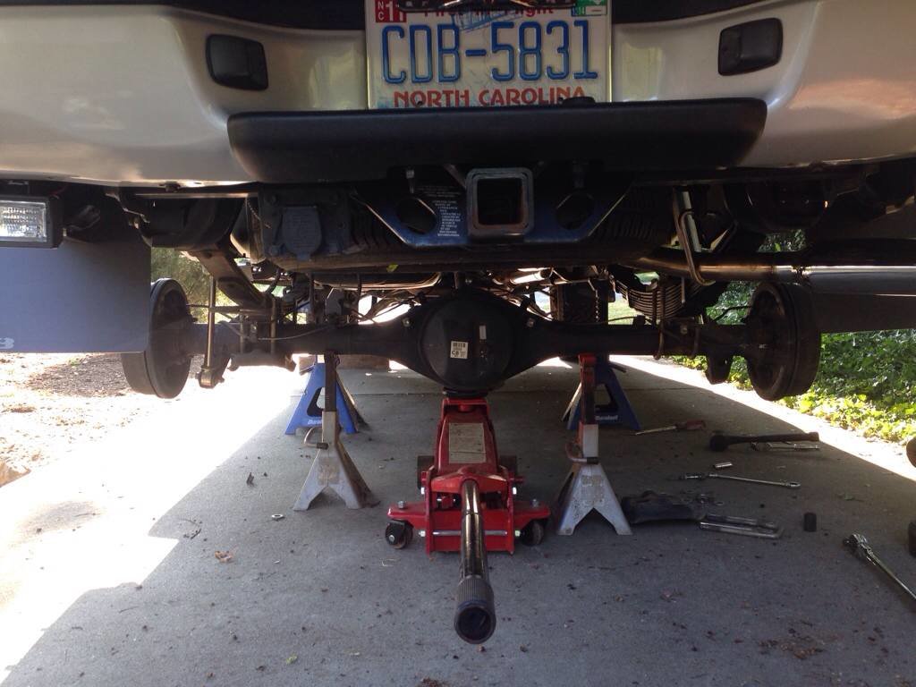

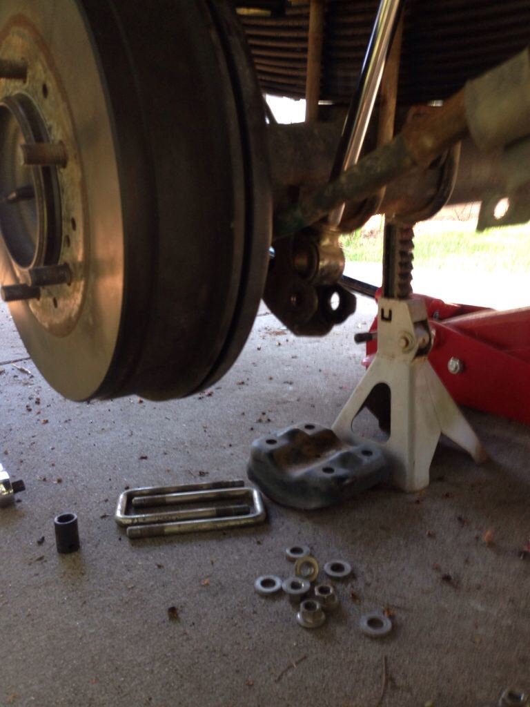

    Dammit man. I changed the oil/filter yesterday, and started pulling out the stock leafs. Got the airbags off and one leaf pack before realizing I needed a set of bushing sleeves for the expo springs. Lurry was using greasable bolts with no sleeves, I should have known to get a set :facepalm:

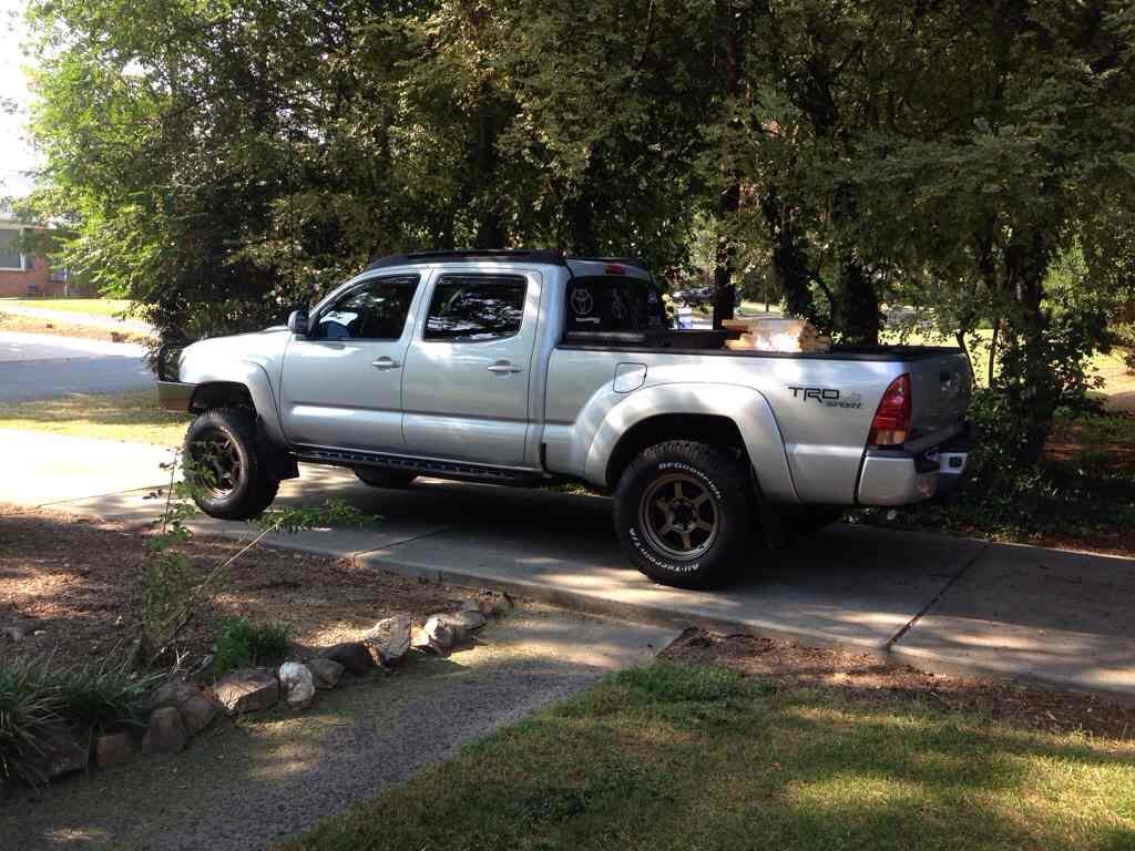

    No bags, non-TSB pack w/ 1.5" AAL. About 250 lbs. in the bed. The front was jacked up, it is not at ride height in this pic

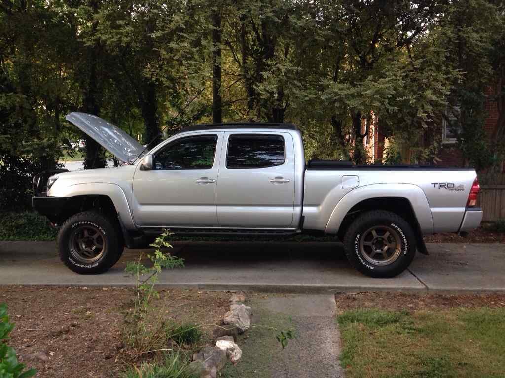

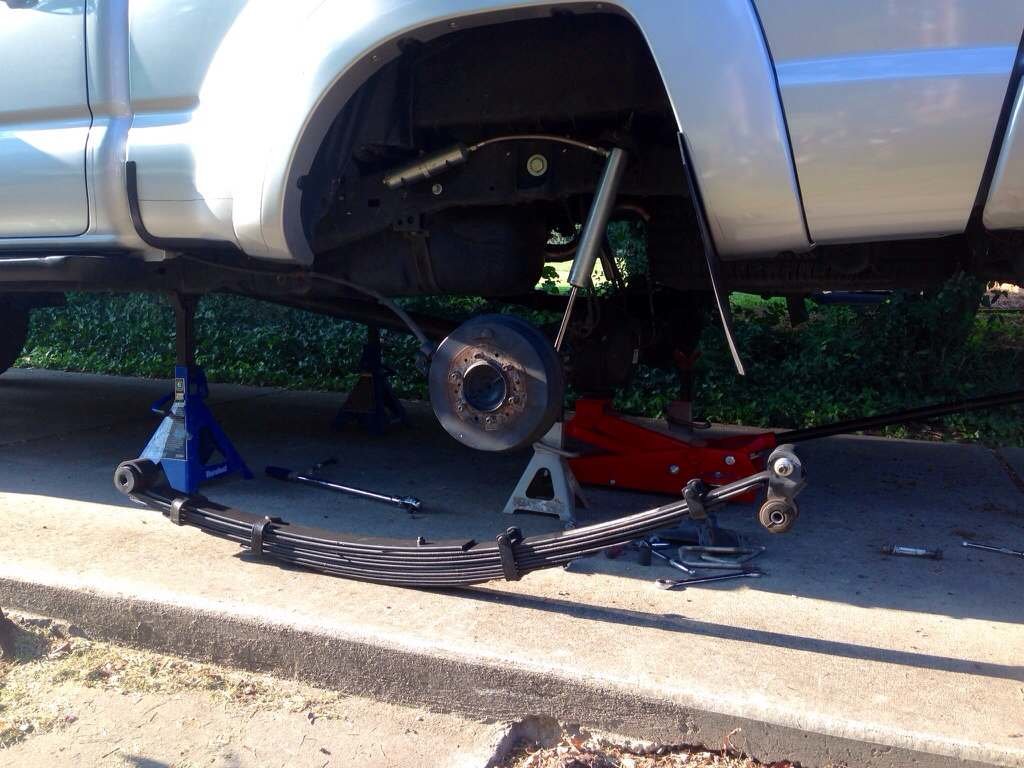

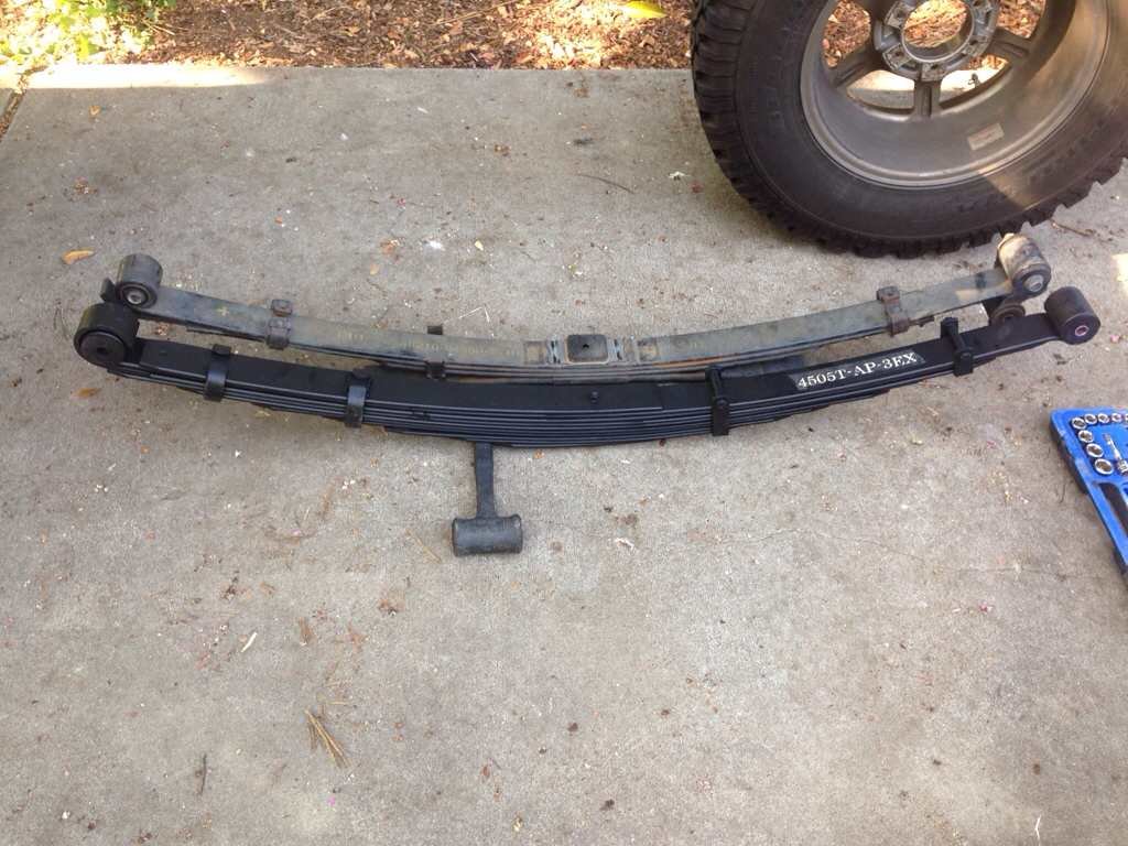

    :woot: got the expo springs installed this evening with no issues, only took me a couple hours and a few beers.
    Passenger pack replaced
    Allowing 1.5" more droop than the shocks with stock shackle setup
    Before
    After

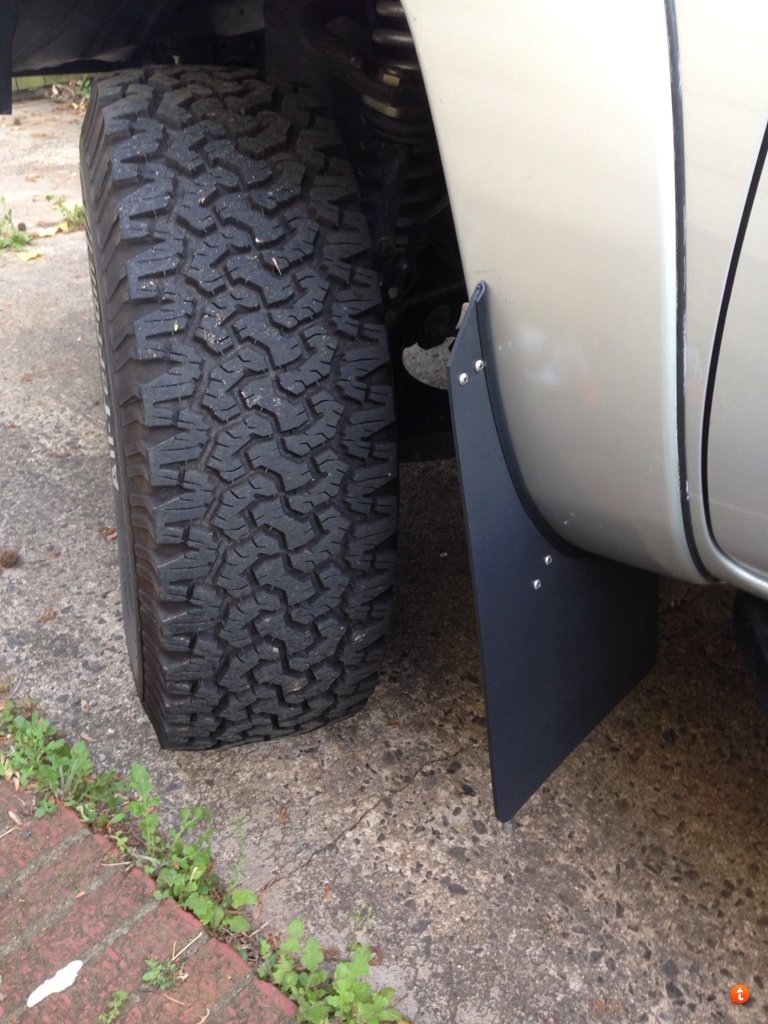

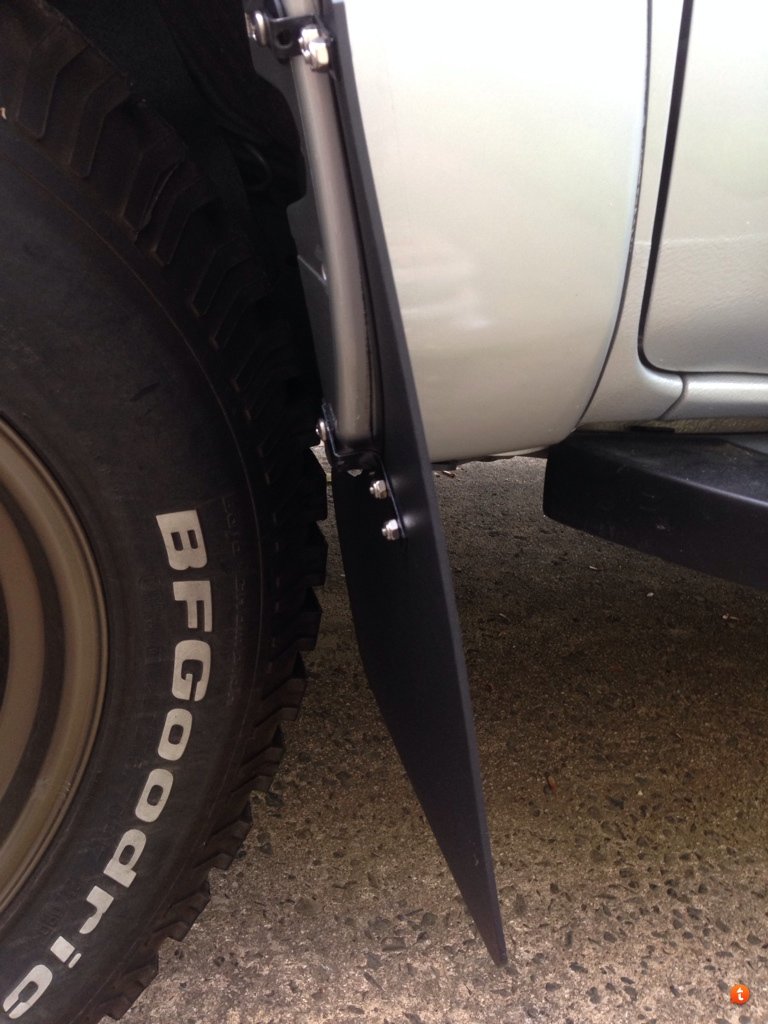

    I see how you mounted those fronts, thats pretty slick. :thumbsup:
  20. Nov 10, 2014 at 7:31 AM
    #460
    ajohnson
    ajohnson [OP] Glamour Shot
    Apr 19, 2009
    #16145
    8,496
    Andy
    Charlotte, NC
    07 DCLB TRD Sport Prerunner 4x4
    Things and stuff and such
    That's how the oversize tire kit mounts up front, comes with all that hardware.
