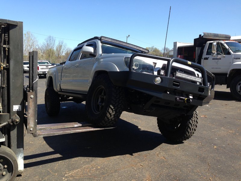

    Damn Andy, lot's of progress here. I just had to swap out my TJM control box because the wireless remote stopped spooling in.
    Looking good, you will def love the 4.56's :) Still need to catch up. Hopefully once I get my spindle gussets ordered we can get together. Oh and the forklift guy, he must have thought he was an off roader or something, lol.

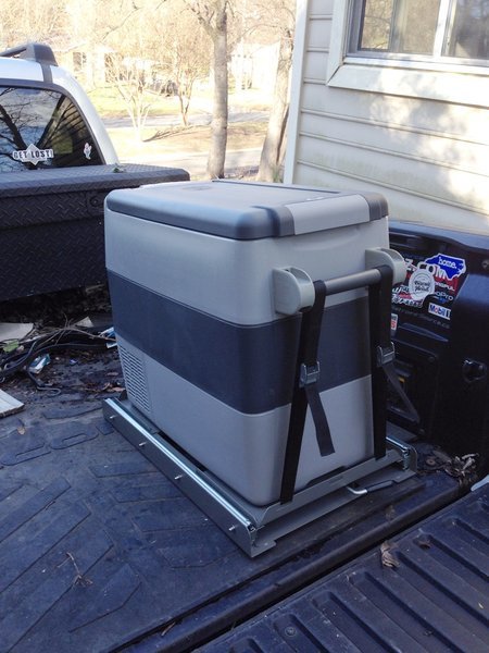

    Dude, pretty nice. What brand did you go with? I plan on throwing a cooler on my gas can carrier attachment for URE. Just not the same though, lol.

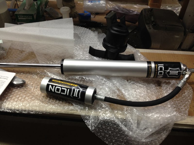

    More goodies came today. Rear Icons, 11" travel, and Wheelers superbumps. Thanks @YotaDan !

    This thing 4wd yet? I see fridge but what good is a prerunner with a fridge?!

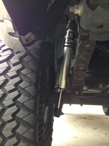

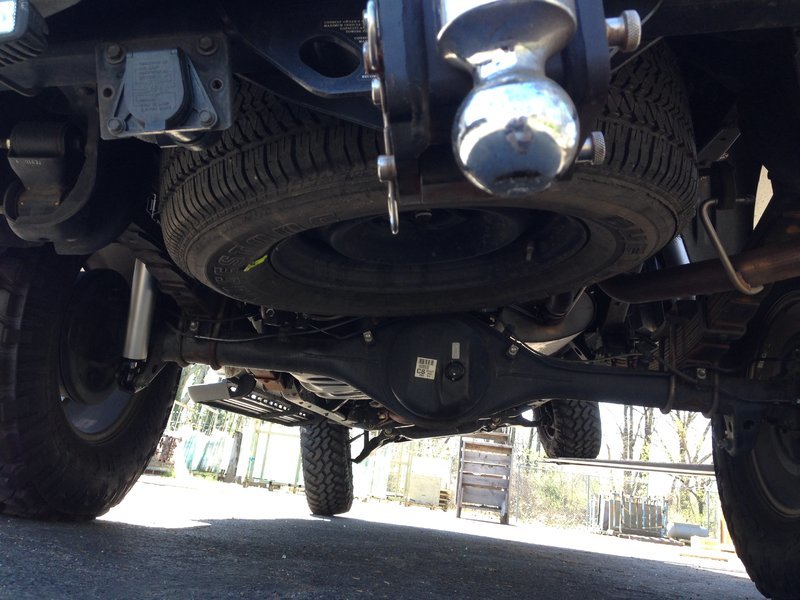

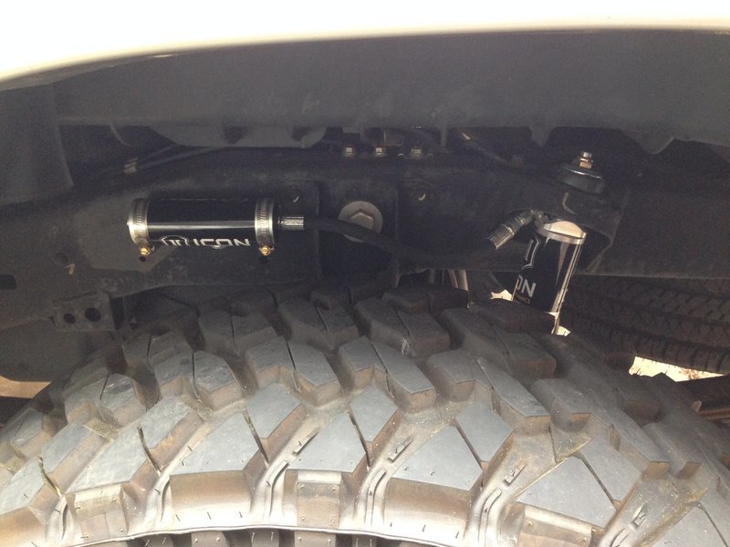

    Finally got the new shocks mounted. These are '07+ tundra 0-3" lift rear shocks, same specs as the the Tacoma 2.5-3.5" lift shocks that Wheelers sells, but $100 cheaper. Had to shave the lower bushings and sleeve to fit in the axle mount. Rides pretty good with the stiff all-poo springs.
    I finally have some down-travel, I just need to check the bumpstop distance.

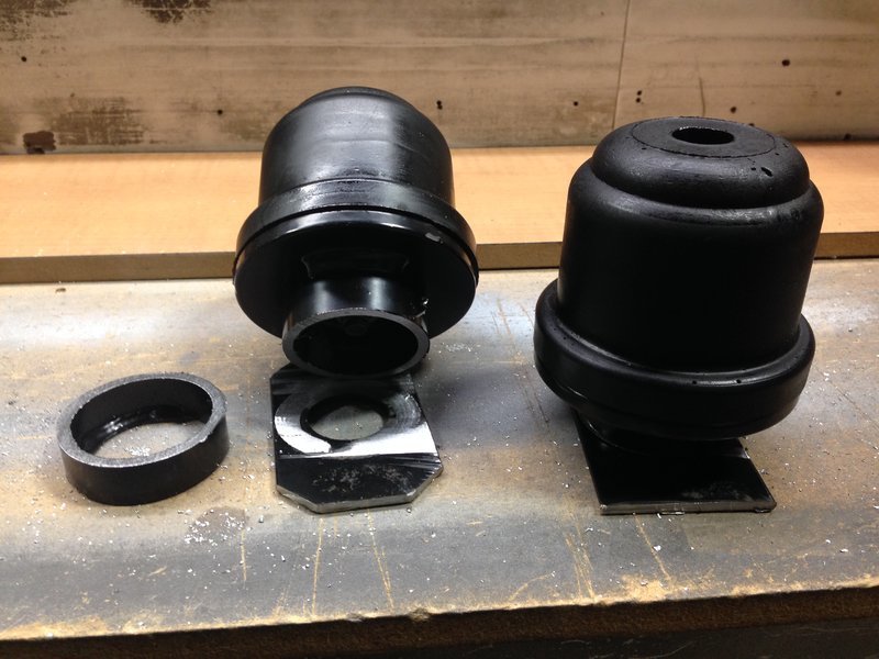

    Measure fer teh superbumps

    Cut my bumpstop mounts and rewelded. Waiting on some Barnes 4wd U bolts and then I'll throw them on.

    ROR. I had stock bumps that were cut down about 1" +/-, they came on teh ubolt flip plates I got from Lurr. They were about 1/2" from the frame with 3/4" shaft showing, as far as it would stuff with the bed empty. 3" between the ubolt plate and frame pad so I'm cutting these new mounts to fit but I allowed a smidge more shock compression.
