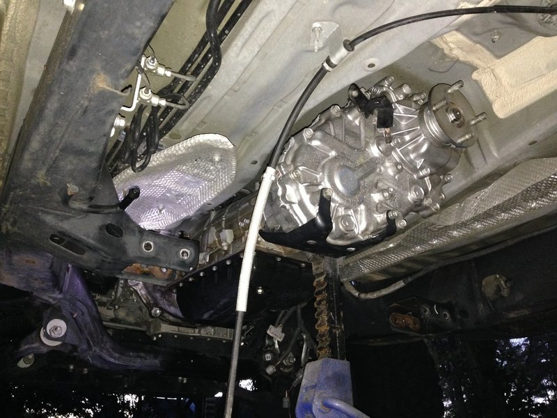

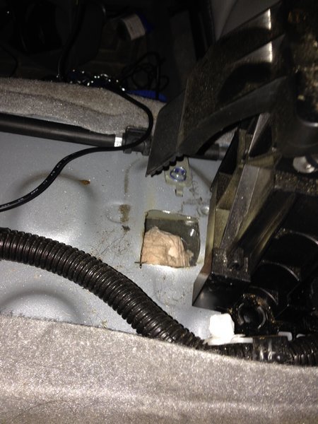

  1. Apr 5, 2016 at 5:47 PM
    #701
    ajohnson
    ajohnson [OP] Glamour Shot
    Apr 19, 2009
    #16145
    8,496
    Andy
    Charlotte, NC
    07 DCLB TRD Sport Prerunner 4x4
    Things and stuff and such
    Shifter hole is pretty damn close

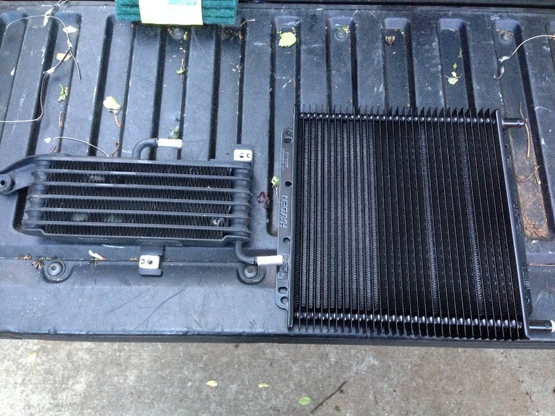

  2. Apr 8, 2016 at 5:20 PM
    #702
    ajohnson
    Apr 19, 2009
    #16145
    8,496
    Andy
    Charlotte, NC
    Finally to mount my oversize trans cooler

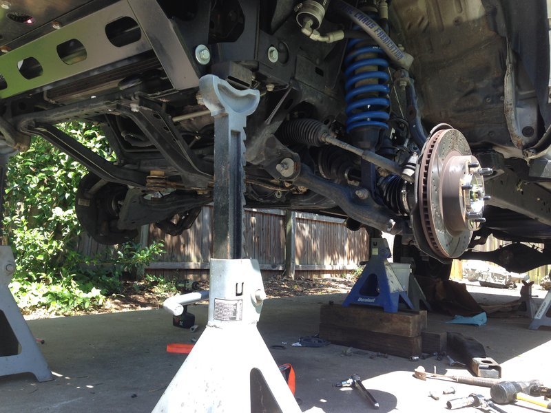

  3. Apr 10, 2016 at 3:38 PM
    #703
    ajohnson
    Apr 19, 2009
    #16145
    8,496
    Andy
    Charlotte, NC
    :woot: front end is assembled. 4.56 gears, OE CV's, new CV dust seals and wheel bearing assemblies.

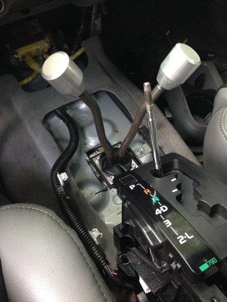

  8. Apr 12, 2016 at 4:40 PM
    #708
    ajohnson
    Apr 19, 2009
    #16145
    8,496
    Andy
    Charlotte, NC
    Too bad I have to cut these sticks off and work them around the auto shifter. It should be sweet if it works out the way I want though. The Front Range Off Road twin sticks are awesome. I ordered a low profile twin stick boot that hopefully will cover this hole.
