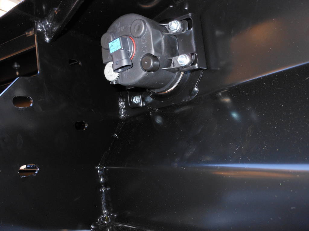

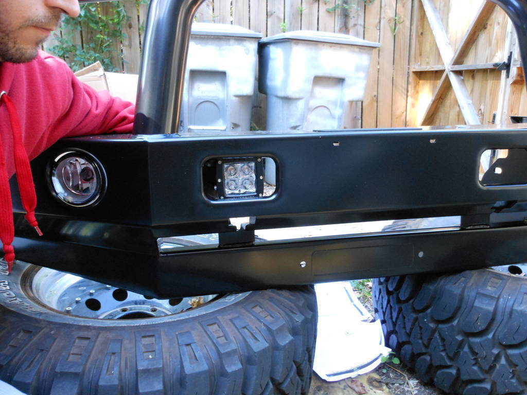

    I am getting the TJM bumper ready for install. I finally got the fog lights mounted. What a fucking PITA.
    Not much room for a wrench...

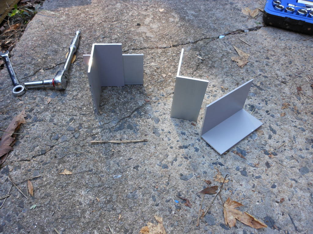

    Here is where I am mounting the Rigid Dually's...
    ... going to use this scrap aluminum angle from work to make some brackets utilizing the light mounting holes on top...
    There are 2 sets of mounting holes for lights on each side of the grill hoop. The Hella's will bolt through the front holes and fasten the bracket and I will run a bolt through the rear holes to keep them secure. Pictures will explain later.

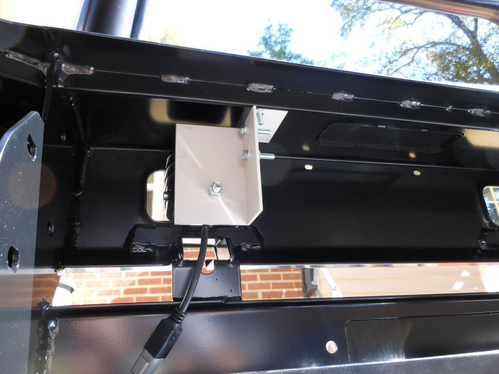

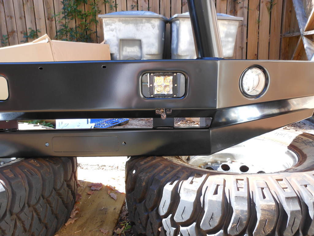

    Well here is what I have done so far. Got one Dually bracket fabbed up, its just sitting in place for mockup. I will get the other one done and paint them.
    I really wanted a set of Rigid 4" E series lights to fill these holes but it was more than I wanted to spend and probably over kill for what I want.

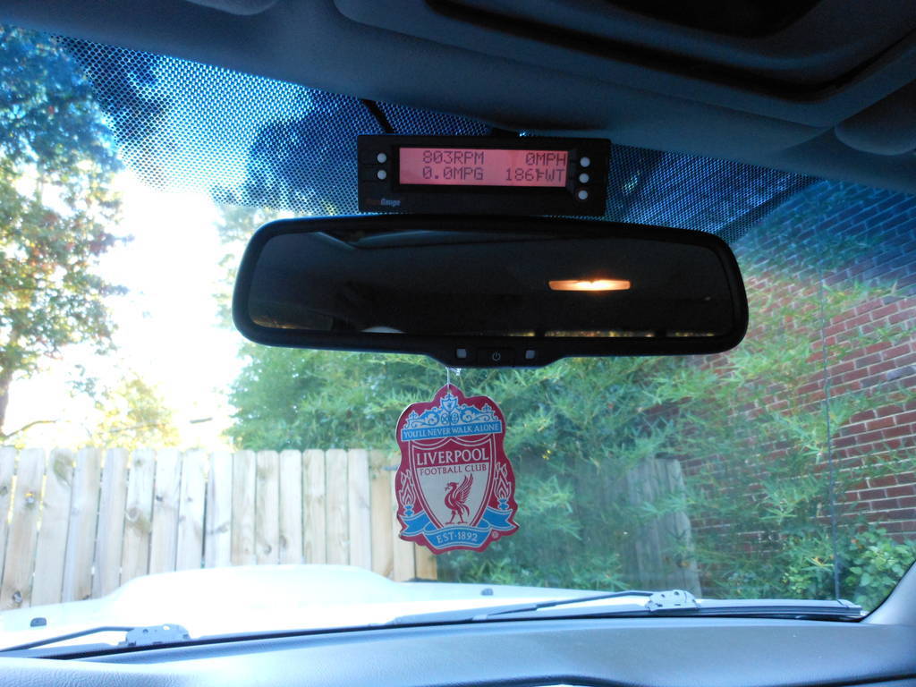

    Finally installed a Scanguage II with Blendmount. I don't know why I waited so long to get one of these.

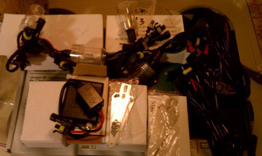

    My DDM HID sets finally showed up. Too bad I can't mess with them until next weekend.
    55w 6000k going in the Hella 700 spot beams for the horunner. 55w 3000k going in the 500 fog beams for the Taco.

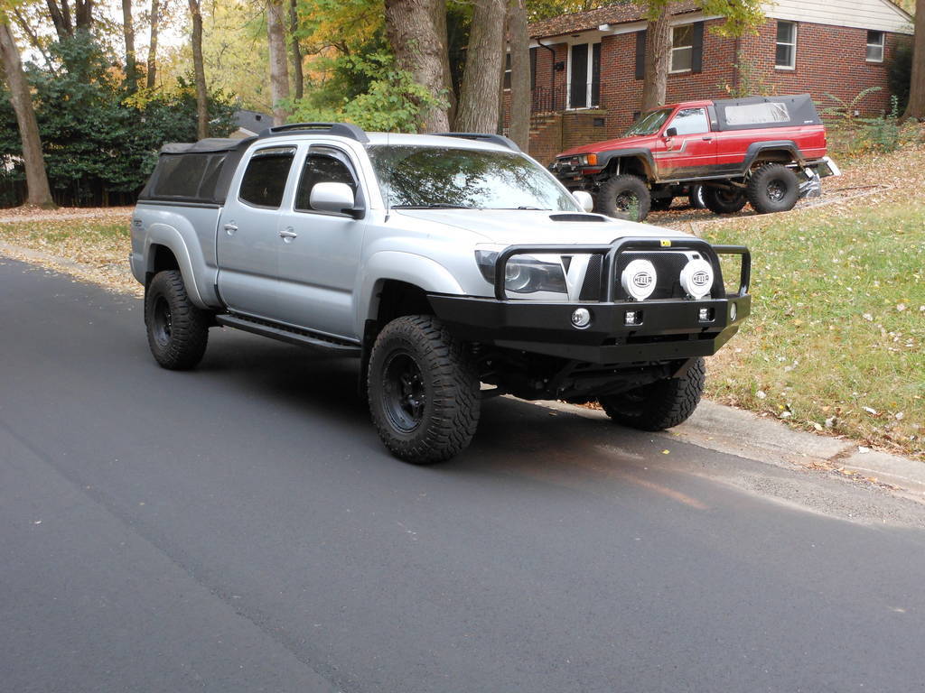

    Dig the new bumper are they still having the sale on them? Can your get a pic looking down on the front did u trim the bottom off the grill or is there a gap?
  17. Nov 4, 2012 at 7:08 PM
    #177
    ajohnson
    ajohnson [OP] Glamour Shot
    Apr 19, 2009
    #16145
    8,496
    Andy
    Charlotte, NC
    07 DCLB TRD Sport Prerunner 4x4
    Things and stuff and such
    Thanks. Sierra Expeditions still has the sale price on their website.
    I did not have to trim anything. The grill is behind the bumper. I will try to remember to get some more pics tomorrow while I splice the fog harness.
