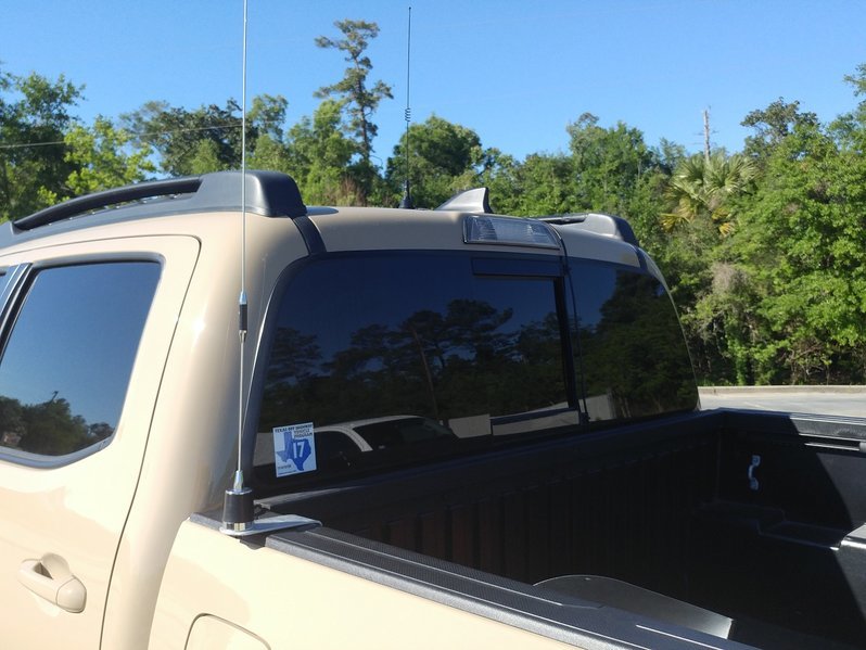

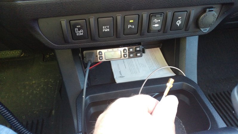

    The left (lower) antenna is the MXT105. The upper roof mounted via MagMount is the Dual Band 144 - 176 / 440 - 470 antenna for 2m and 70cm (440).

    The MXT105 is mounted and power is fed from the driver side. The passenger side feeds the dual band and I converted it to a SMA connector in side and hid it under the console so I just have this little nub sticking out. This screws into the antenna port on my BF-F8HP radio.
