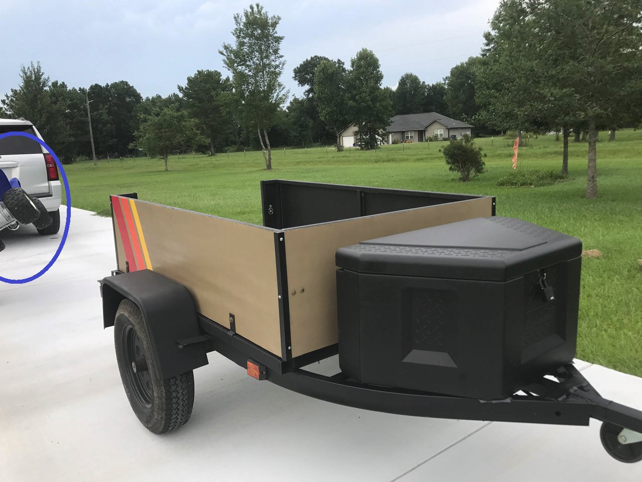

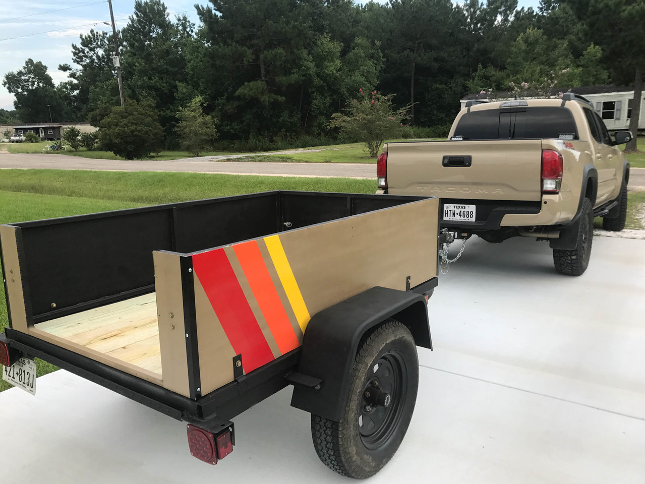

    1" square tube frame for the box, with 14ga metal sheets for the cladding. The paint is:
    Inside box:
    Rustoleum (RE) Self Etching Primer (1 coat)
    Duplicolor Bedliner (2 coats)
    Fenders:
    Duplicolor Bedliner (3 coats)
    Outside box:
    Primer - RE Self Etching primer (1 coat)
    Base - RE Camo flat paint - Color = Sand (2 coats)
    Stripes are masked and painted with RE 2x cover enamel (2 coats per stripe)
    Clear - RE Clearcoat (2 coats)
    The corners are aluminum I bought at Tractor Supply and painted black, and screwed to the corners to clean up the welds.
    I siliconed all the corners to help keep water from getting in hard to reach places.

    @fajitas21 Is that some kind of foam padding under the front of the box?

    It's actually a 40mil shower liner from home depot. I used it to shim the box and ensure it was snug. That stuff is designed for a shower floor and is waterproof.

    Nice air by someone! :bikewhoops:
    Also nice looking trailer. :thumbsup:

    Yea my father in law was carrying the 4wheeler to the trailer while I shot that pic. And thanks, it's mine personally, but as much work as Chris, Warren, Jake and the others have done on it, it's pretty much a community project.
