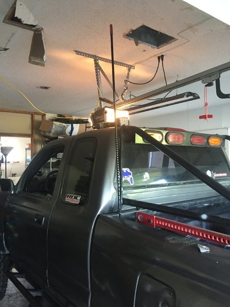

    So the meter worked for you guys? I had a Wilson and it was about 2 swr...I just switched to a firestick and tried tuning it and it is above 3 on every single Channel and doesn't change at all when I adjust the antenna.....
    Same problem with the guy who came down and used it Saturday
    Ideas?

    It's less Tacoma and more mod
    Super dependant on your ground plane, the front of the truck generally is much easier to tune. The rear has issues establishing a good ground plane. Try an NGP antenna if your gonna have it back there.
    @Pirhett I think @anthony250f still has it technically so hopefully he'll pass it along.
