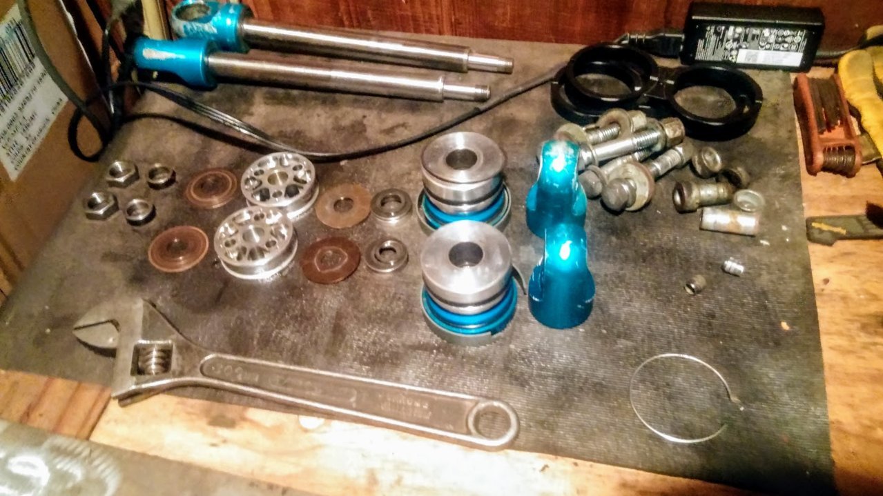

    Deavers disassembled, wire wheeled to remove caked on dirt and repainted to look good.

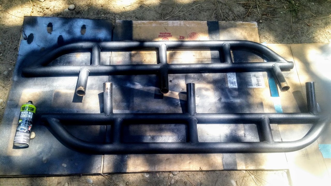

    TG sliders welded up and painted with Raptor liner.

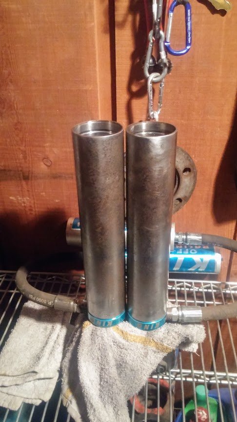

    Rear Kings getting new pit free shafts.

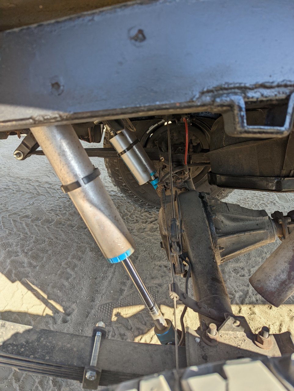

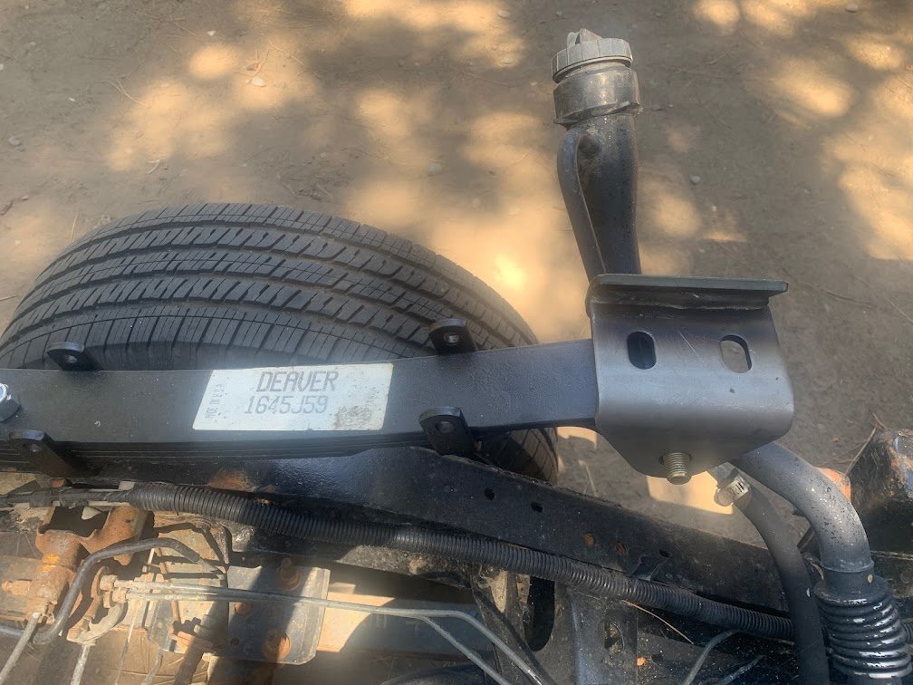

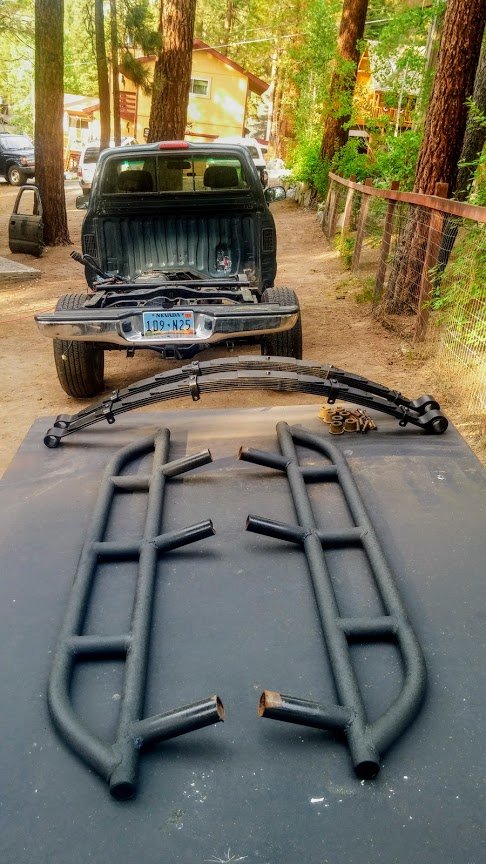

    Trail gear spring hangers showed up today, they are pretty beefy. Finally going to get to mount my Deavers.
  3. Jul 22, 2021 at 6:15 PM
    #43
    Empty_Lord
    Empty_Lord Toyotaholic
    Mar 13, 2016
    #181186
    28,297
    Dan
    Northwest Indiana/Chicagoland
    Relocating the hangers for the newer style leafs?

    Yes I got j59s, they are longer than a 97 is set up for.

    was the frame miguel got a pre 98 or no? if it is i'll need to do the same.. the 98 with the supercharger has an agreed price and i'll be picking it up soon. going to try and retain its originality as much as i can.

    It was a silver 97 v6 manual

    cool, so i'll need to get the perches moved. simple enough! good to know it was a manual. it'll be staying a manual

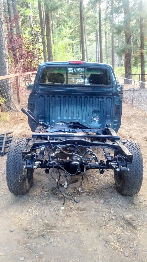

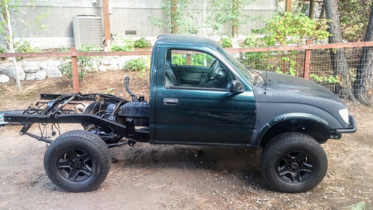

    Frame and axle repainted
    New leaf hangers on and Deaver's mounted
    Waiting on Valves for the kings.

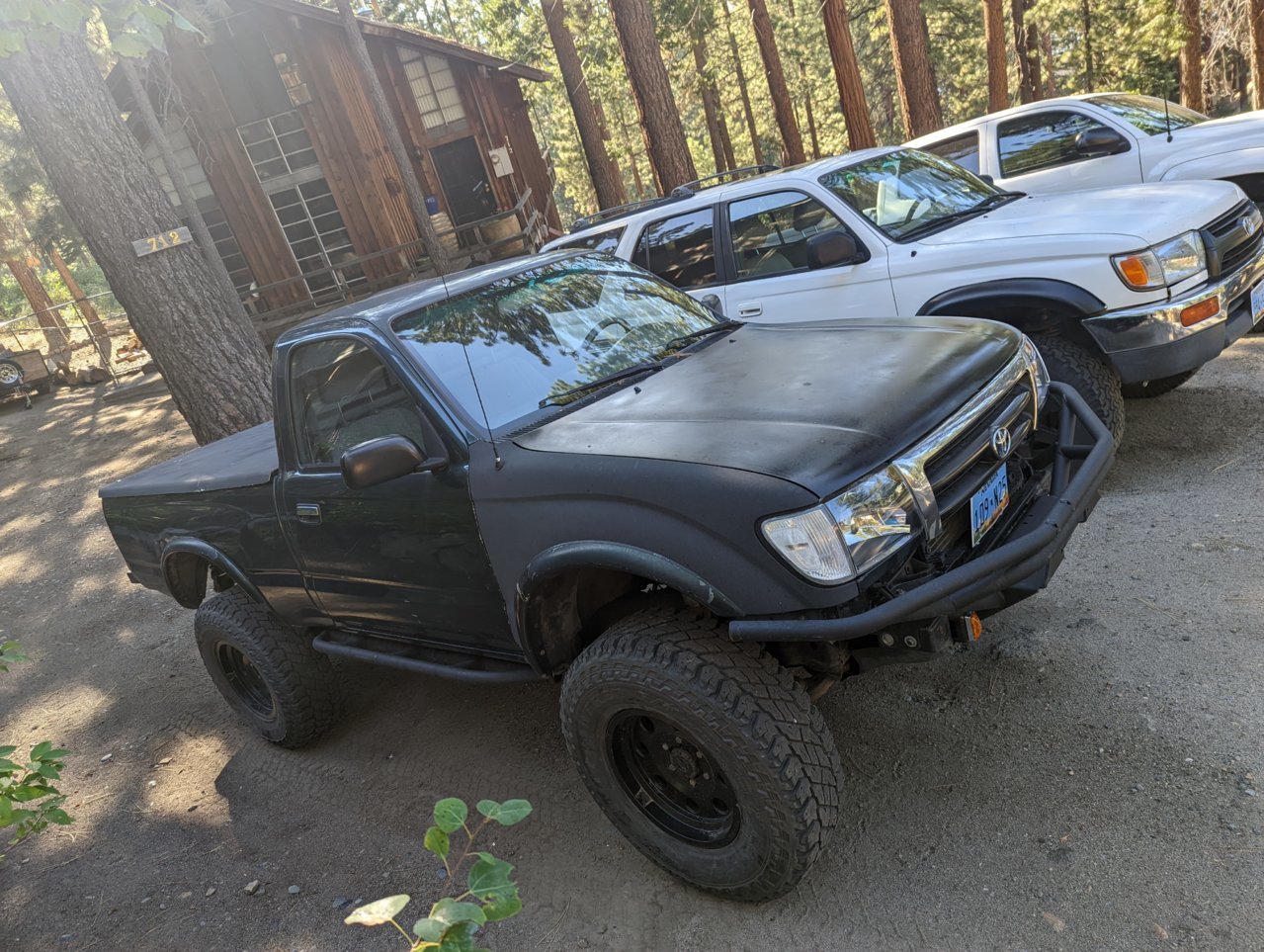

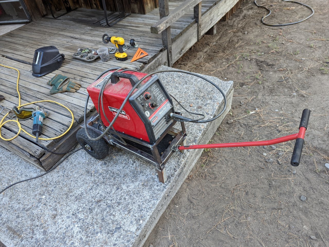

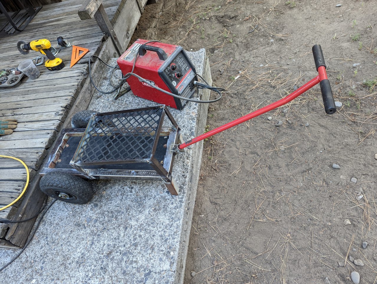

    Haven't done anything yet this summer but got tired of dragging around my welder on my dirt driveway so I made an off-road welding cart out of scrap metal I had laying around. (It's not done yet)
    ztwatson and Broke Okie Ty like this.

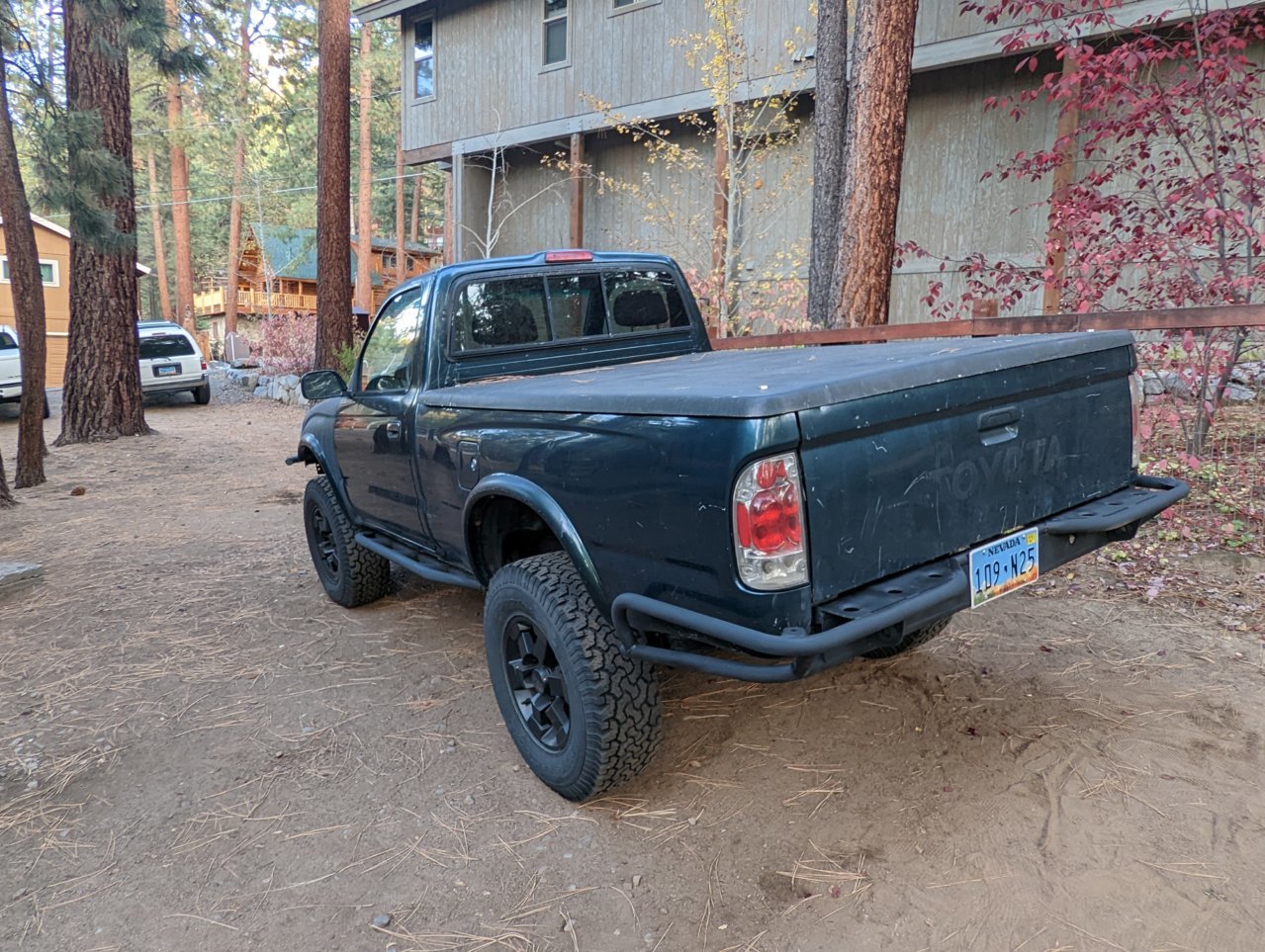

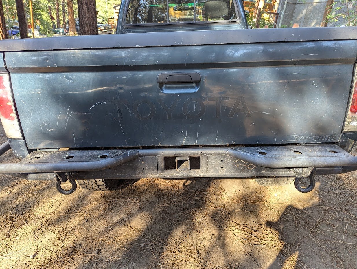

    Came across an All-pro rear bumper. Last week.
    Broke Okie Ty likes this.

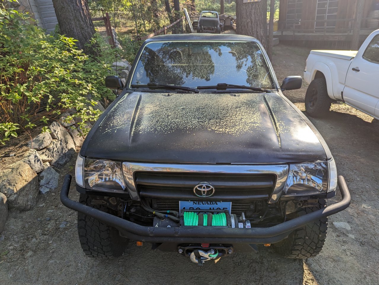

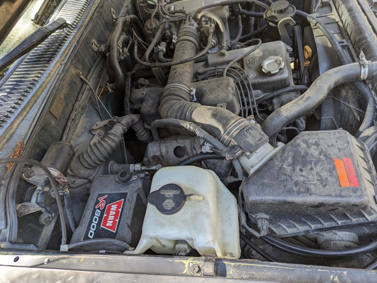

    Swapped out the warn xd9000 for a vr8000 and relocate the control box under the hood.

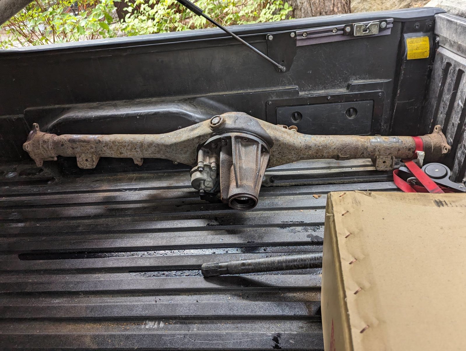

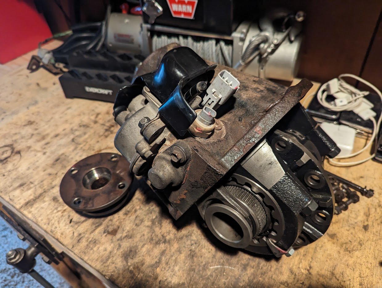

    also picked up a 2nd gen rear locker to regear and drop in to 2000 rear e-locker housing.

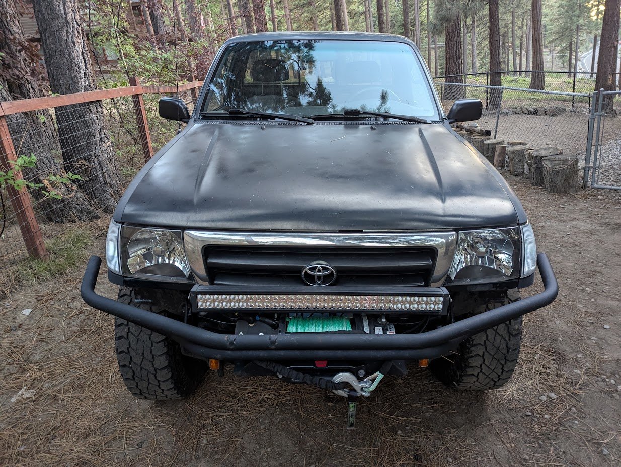

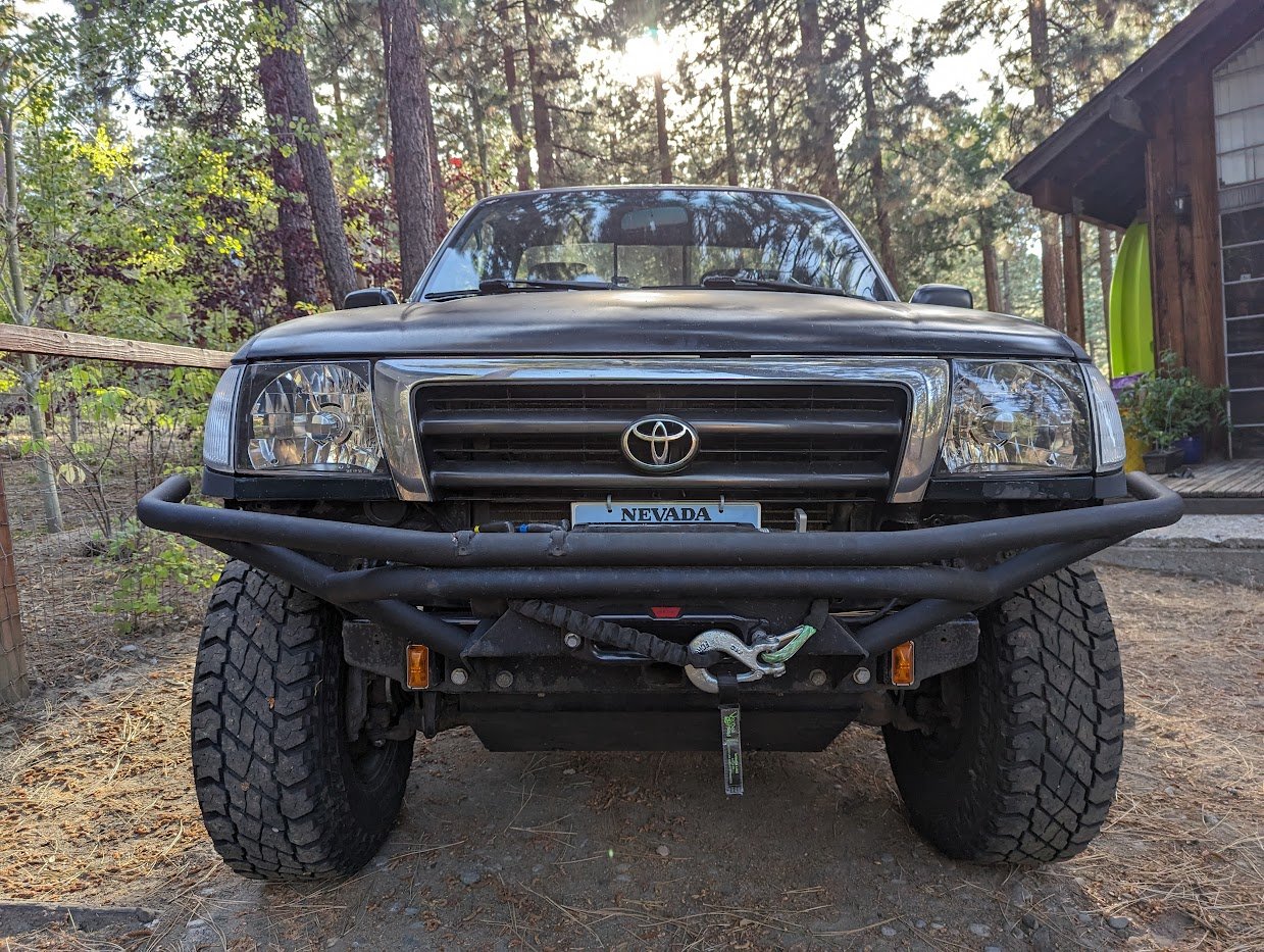

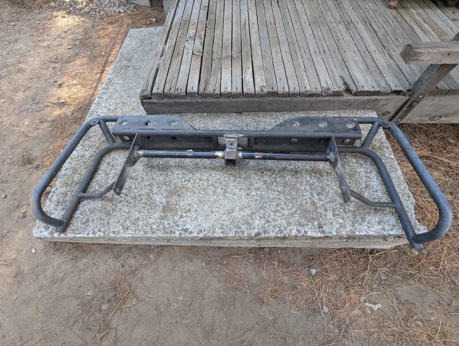

    added a light bar and welded in a receiver to mount a winch or dirt-bike rack.
    PXL_20240709_033247551.MP.jpg PXL_20240709_005155069.MP.jpg PXL_20240708_014053241.MP.jpg
