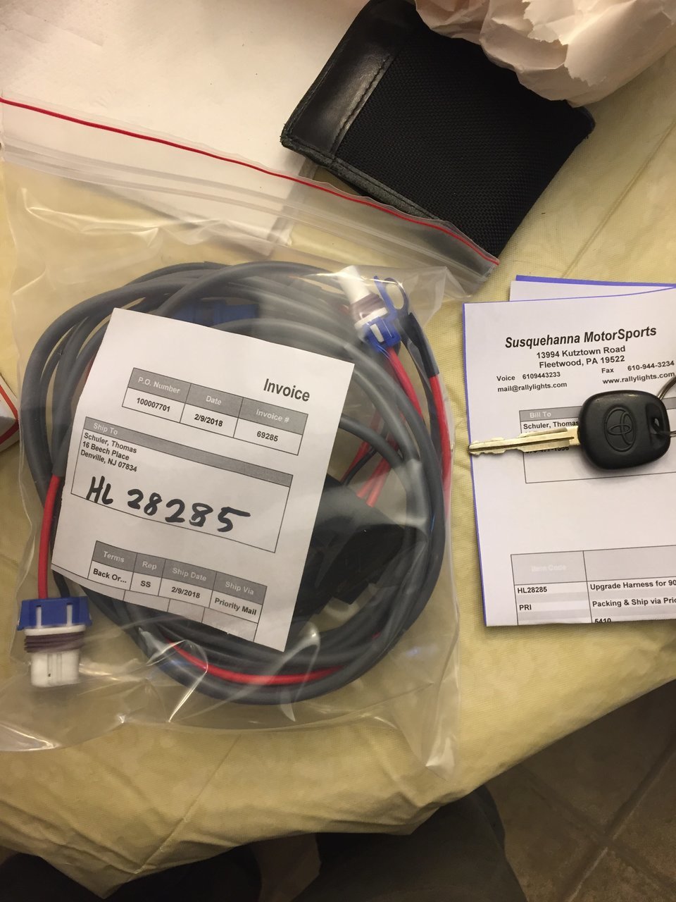

    Got my next harness in the mail today. Kind of a surprise since they never sent shipping info or even an order confirmation email but here it is.
    crashnburn80[OP] likes this.
