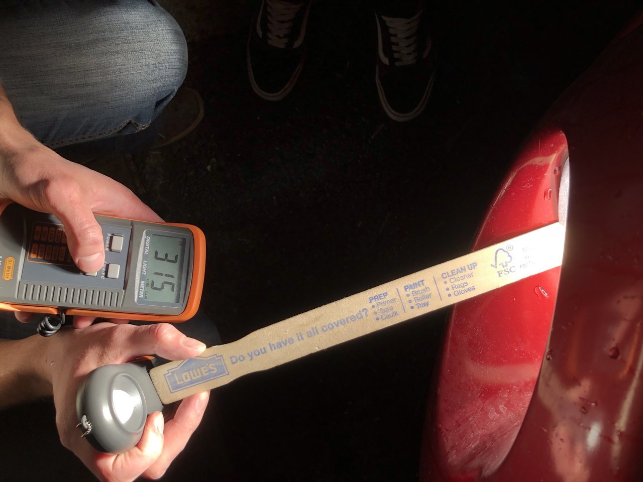

    Measurements
    Stock fog
    HIR fog

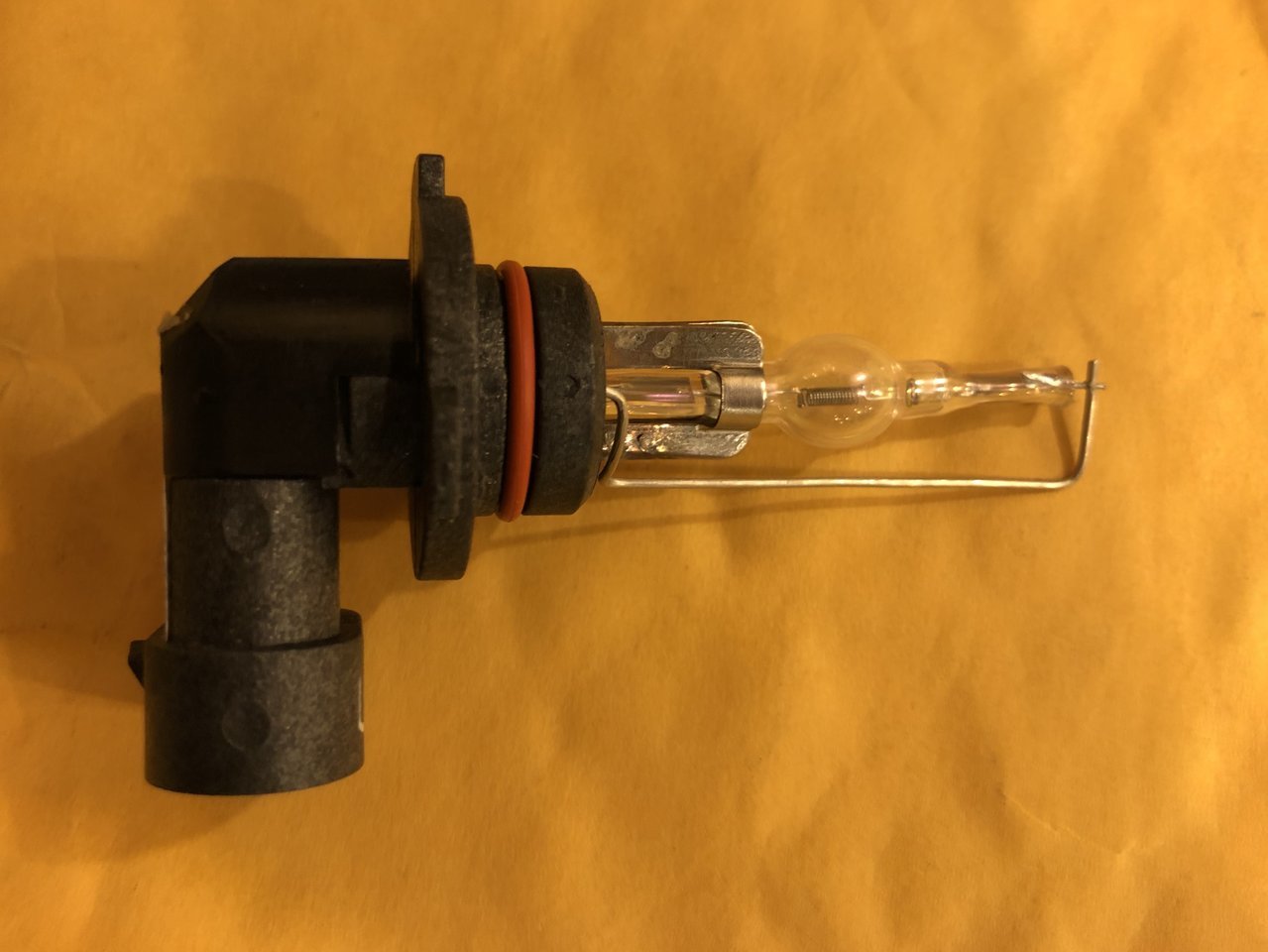

    The obvious difference between the H10 vs 9011 (or 9005) bulbs is the 9011s are missing the glare cap, which exposes a forward facing filament on low beam. Any low beam application where glare control is important should never have a forward facing exposed light source. This is why low beam bulbs have glare caps. Glare is not important in a high beam application as there should be no oncoming drivers requiring glare control, so glare caps are not applied. So I needed glare caps as my lighting mods must operate like stock but better. Introducing glare is the wrong direction.

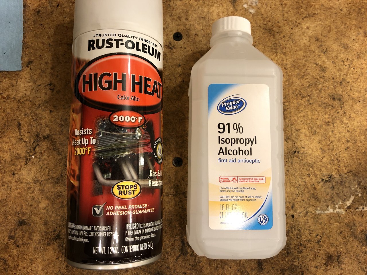

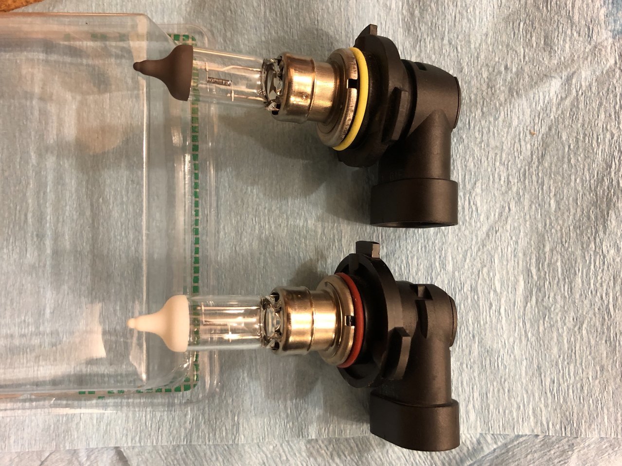

    Using 9005 bulbs (which are far cheaper than 9011s) I experimented with applying glare caps vs lacking them to see if this was necessary. The HIR bulbs spec surface temp right on the box at >200C or about >400F. Engineers love safety factor in design, so accordingly I searched for the highest temp spray paint available and selected Rustoleum's 2000 degree ultra high temp spray paint which is guaranteed not to peel, providing a 5x safety factor for coating temp. Wanting to avoid hot spots on the bulb which may lead to premature failure, I selected white as the color choice.
    To apply the glare cap, I had to commit the cardinal bulb sin and touch the bulb glass to tape off the cap line. I tried this many times and it is too difficult to apply the tape precisely with gloves. You will need some isopropyl alcohol to clean the bulb later, if you do not oils from your skin will cause premature bulb failure. Isopropyl alcohol should be available at your local drug store for less than $2.
    Using a standard H10 for glare cap reference, I wrapped the new to-be glare cap edge on my test 9005 in plain scotch tape. I put a small piece of paper on the end of the tape so I wouldn’t have to pick at it to get it of the delicate bulb, then wrapped the rest of the bulb capsule in scotch tape. I used a drill bit to punch holes through a cardboard box, push the bulbs through and tape in place for painting.
    It is important during this painting process to use many light coats with dry time in-between. Heavy coats will likely lead to bubbling and flaking of the coating. This paint is going to be cycled through high heat. In limited testing the 2 weeks of being run constantly on the pre-Tacoma test vehicle have shown no signs of any breakdown of the coating.
    My high tech glare cap application station with 2000 degree paint.
    Finished product (bottom) compared to OEM product (top).

    A glare capped 9011 HIR. A low beam bulb of this level does not exist.

    The 9011 HIR will plug into the H10 electrical connector, but the light tabs will not allow it to mount. The top tab needs to be trimmed as shown (same as putting the 9011 into a 9005 headlight). Vosla seems to know what buyers have in mind here and have surprisingly already pre-marked where to trim their bulbs, shown in white. I did not apply that white marking, it came from the factory that way. I kinda like these guys a little more. Using a Dremel cut off wheel, this operation takes only seconds to removed the white marked material. You can now mount an HIR into your H10 housing.

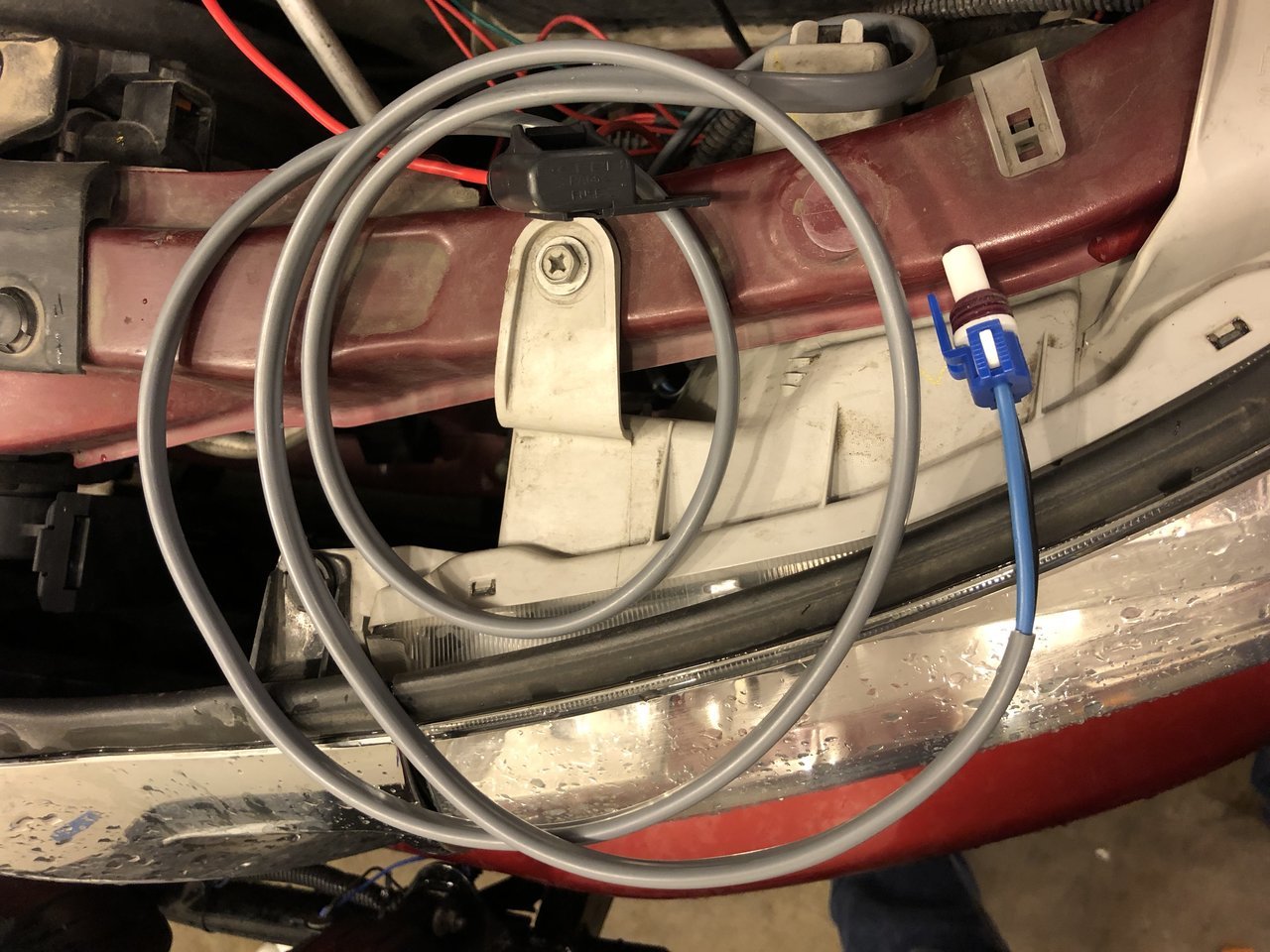

    9005 Hella Headlight Harness
    Feeding halogen based bulbs higher voltage results in notably greater output. To unlock the real potential of these bulbs they need more voltage, the factory circuit is now running over 50% greater wattage than intended. Since the electrical connectors on the H10 are the same as 9005 and 9011, I used a heavy duty relayed 12 gauge Hella 9005 headlight harness from Rallylights to alleviate the factory wiring from the increased loads, and also provide increased voltage with a direct connection to the battery. The harness maintains the factory control operation of the fog lights.
    Unfortunately I didn't get a pic of the Rallylights 9005 harness before install, so here it is partially installed:
    The wiring was run along the front lower core support and zip tied in place.

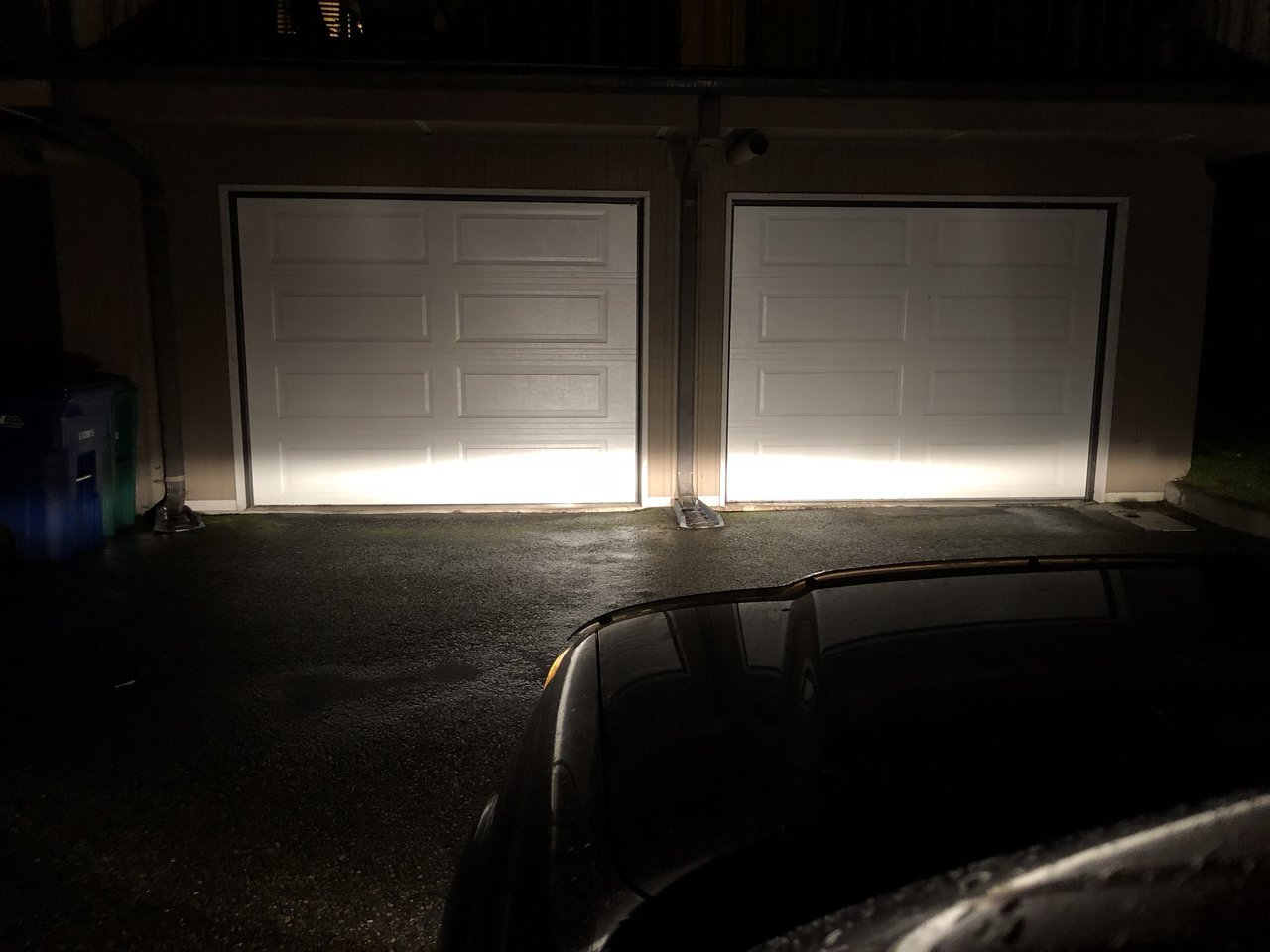

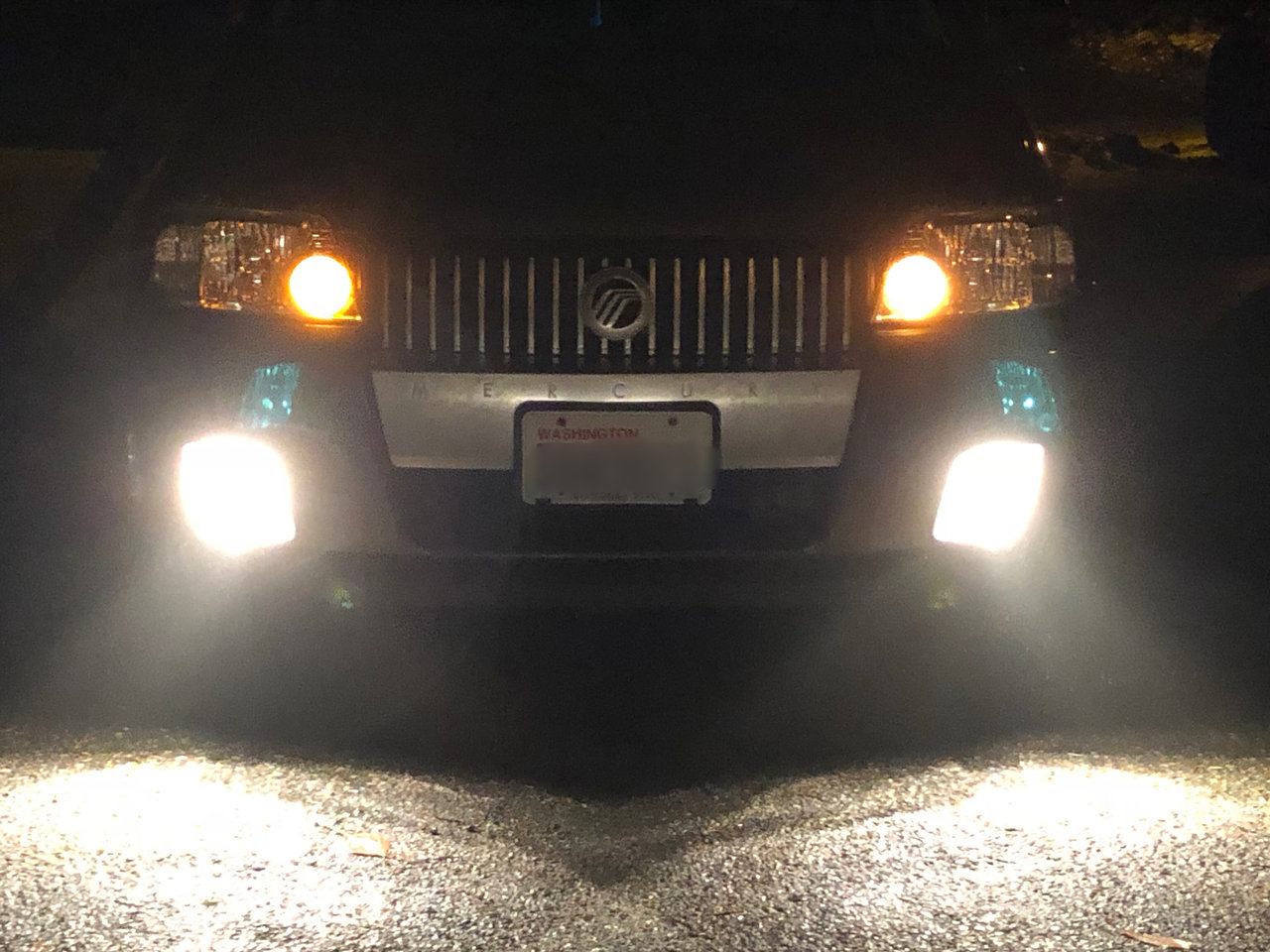

    End product, HIR fogs (headlights disabled)
    The 5000 lumen fogs make the 2000 lumen headlights look pretty poor.
    Here is an output video on the test vehicle (video is way too short I know).
    This is running best in class Philips Extreme +130 headlights in OEM housings. There is not a better stock wattage bulb. Then turning on the HIR fogs. This video shows the Osram 9011 HIRs, not the 5% higher output Volsas which I gave away. The video is not that helpful watched in real time, but pause and compare 01s with 05s by manually jumping time. These lights maintain the OEM cut off pattern.
    https://youtu.be/b_3FPcdpZXk

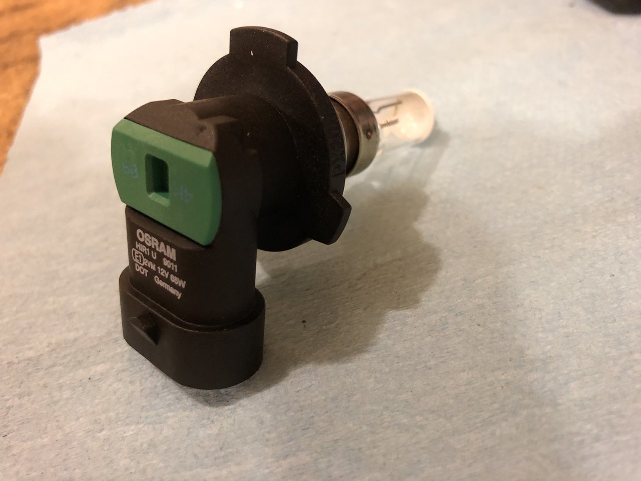

    On Rallylights site Volsas are listed as 3000 lumen, while Philips spec the 9011 as 2500 lumen. The Volsa spec seems overrated. I tested the Volsa 9011s and the Osram 9011s. In testing the Volsas measured 5% higher in lux testing than the Osrams. My testing certainly isn't perfect, but I tried to pull a higher reading from the Osrams knowing what the Volsas had measured and could not get a better reading. A couple percentage points could be noise, but 5% leads me to believe there is a difference in bulb output, but not on the level of 3000 lumens. I suspect the Volsas are closer to the standard 9011 2500 lumens.
    Volsa 9011 HIR Discontinued?
    I ordered a second set of the Volsa HIRs and received Osrams (packaged as Sylvania). I just found out this morning that there is word from suppliers that Volsa may have discontinued 9011 HIR production. I've got some emails out to those in the industry to try and determine if that is the case. I'll update the thread accordingly once I hear back.
    Other 9011 HIRs
    Philips produces a German made 9011 HIR. Bulb life is spec'd at 450hrs which is far better than the 150hrs for the German Osram. I'm picking up a Philips 9011 to compare to the others and will update the thread accordingly.
    ACDelco (GM) also makes 9011s. While they were the originally repackaged high quality Toshiba bulbs (the original HIR) it appears now that manufacturing has moved to China and it isn't what it used to be. Go figure. Reputable sources like Candlepower will not sell the Chinese GM bulbs.

    I was expecting numbers to be a bit higher over 2.3x improvement with this upgrade. Lumen output alone should have been closer to a 2.7x improvement over stock, and adding the standalone harness should have made that number even higher. Earlier versions of 9011 were rated at 2350 lumens, and Candlepower confirms the Philips are 10% brighter than the earlier Toshibas, which makes me curious if these bulbs are not as bright as the Philips. I'll Pick up some Philips bulbs to compare, as I am curious to see if there is a difference.
    An important factor to note in bulb upgrades is that the upgrade only amplifies what the OEM housing beam pattern projects. If the OEM beam pattern is good, the upgrade will be more effective. If the OEM beam pattern is poor, the upgrade will be less effective.

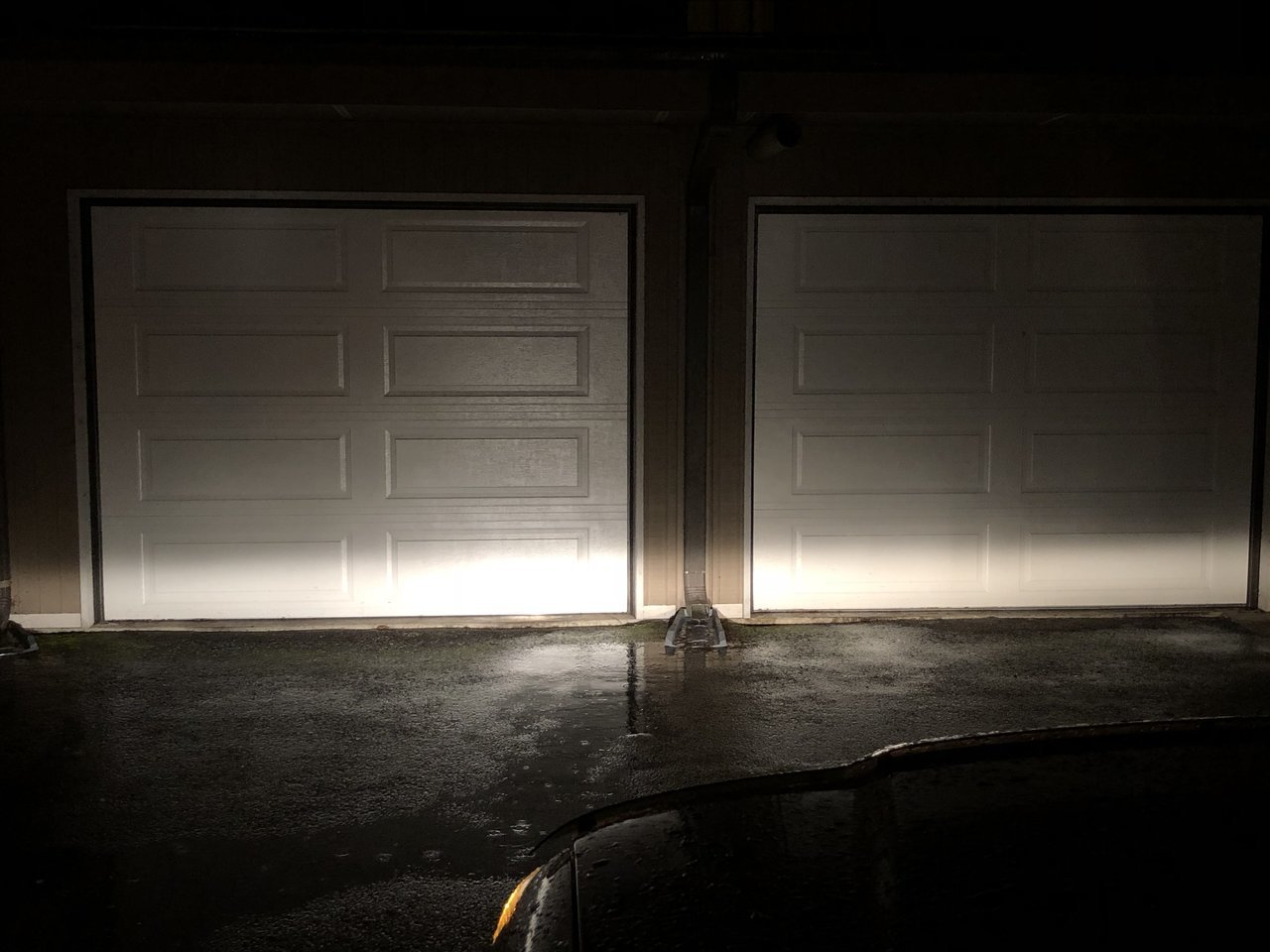

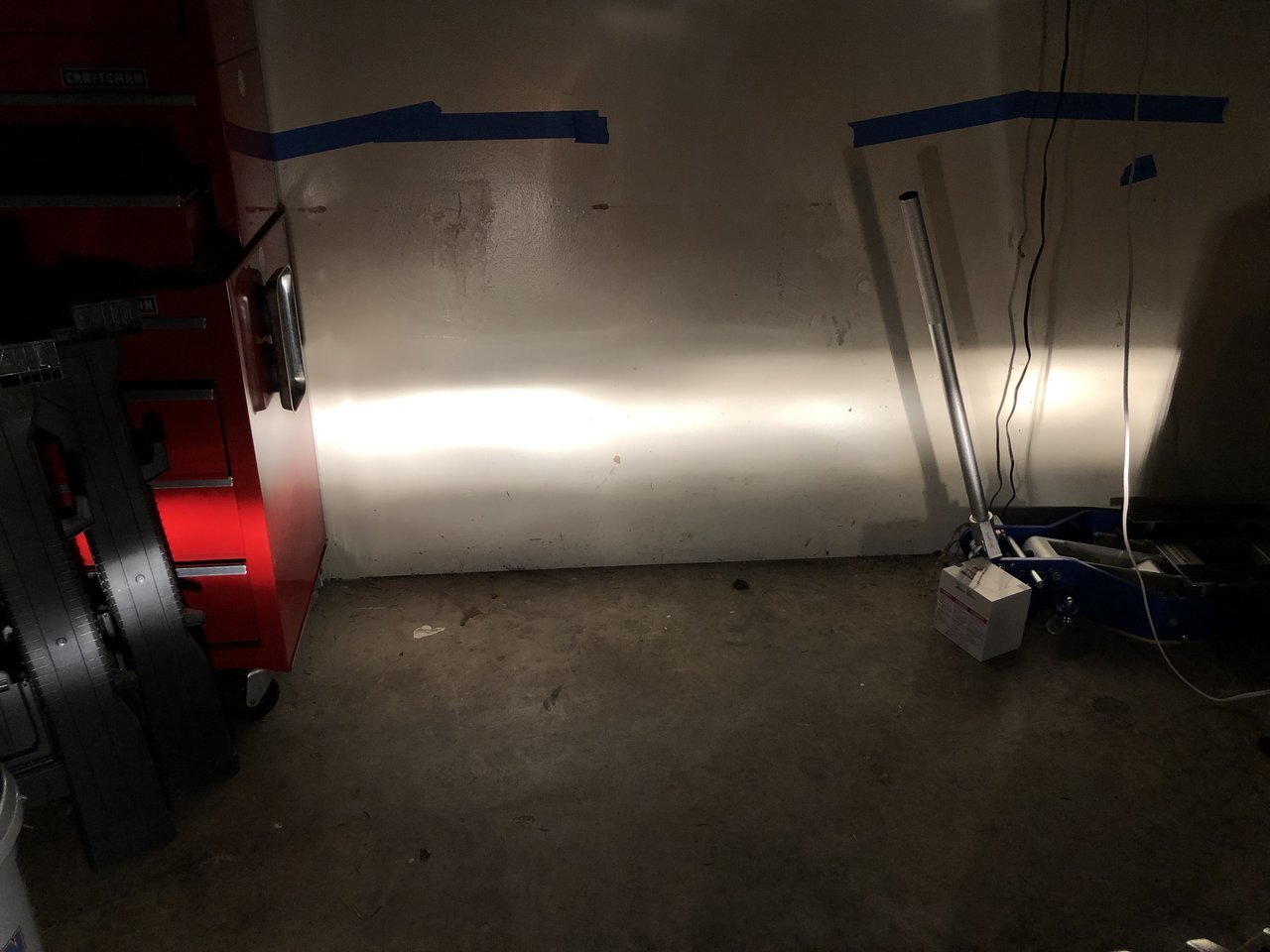

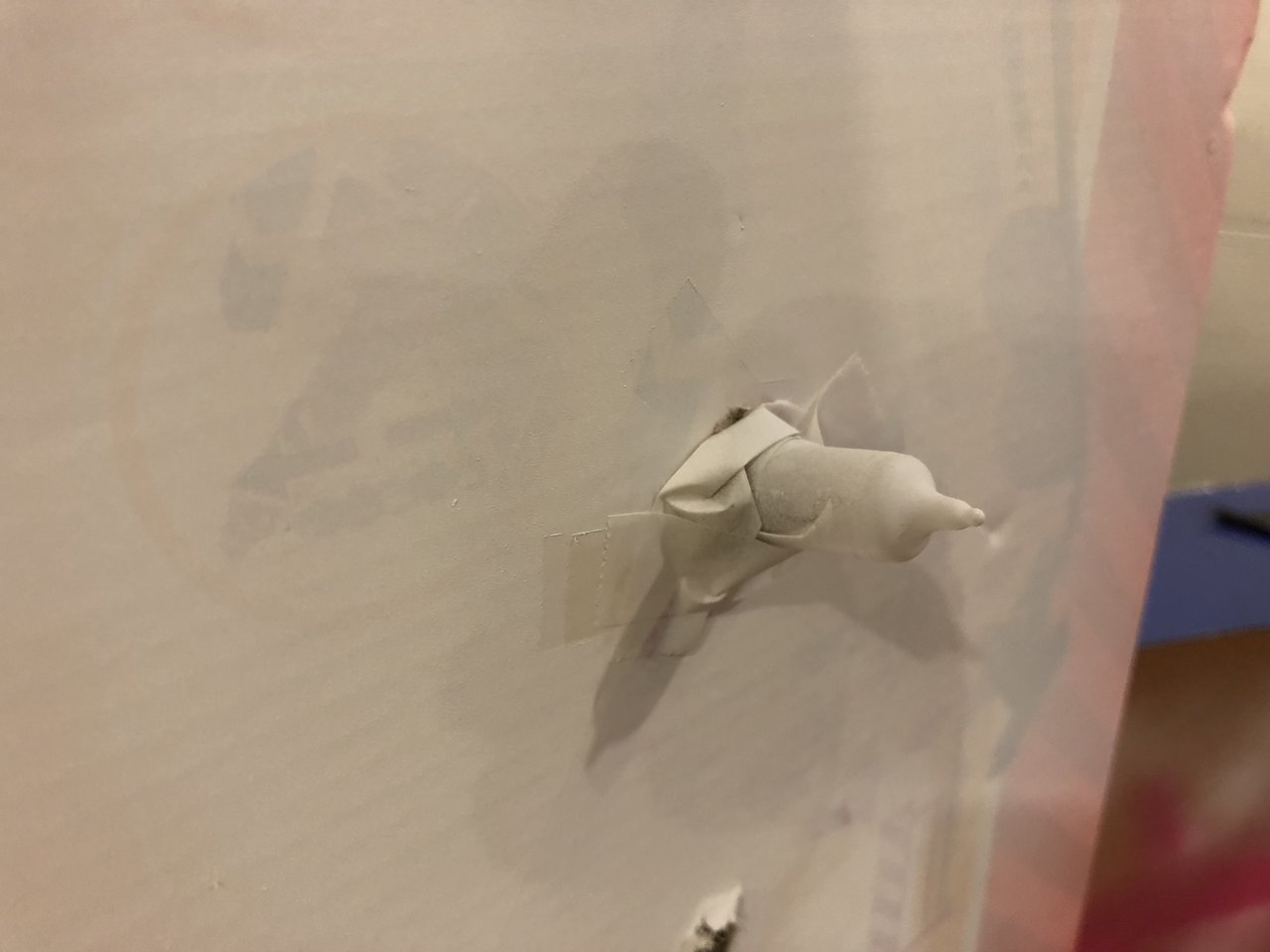

    Here are photos of initial testing.
    Driver has the glare cap, passenger does not. These are both 9005s (not the 9011 HIRs):
    Here is a close up wall shot comparing glare capped 9005 (driver) to stock H10 (passenger). 9011s are far brighter.

    In the first pic - cap vs uncapped 9005 - the uncapped appears to be putting more light forward judging from the light pattern I'm seeing on the ground. The capped side looks more oval, left/right spread pattern. Hope how I'm describing it makes sense. I do not see the halo you indicated. If, as you said, there is no difference showing on the wall test then I would say painting a cap is not needed. In the wall pis I see a significant increase in light, and will pick up a set of 9005s asap. Down the road, with the discontinuation of the high output H4 bulbs, a standalone harness and 9011s is in my future.

    The halo is in the photo on the passenger side, the edge of the halo touches the passenger edge of the license plate. If viewing on mobile, view in a well lit room or turn up screen brightness. I noticed it was difficult to see earlier but the auto dimming for low ambient light made it difficult to see. But yes, there is no glare from a wall test.

    The capped bulbs pictured are H4, H4s have caps. I doubt the 9005 Narva bulb will have a cap. If doing this mod, I'd highly encourage the 9011 for maximum output over the 9005. And for best output avoid output reducing coated bulbs like silverstar.
    Been running the DIY capped 9011s for about 6 weeks now, checked then lenses and no evidence of residue. Will continue to monitor and look for other coating solutions.
