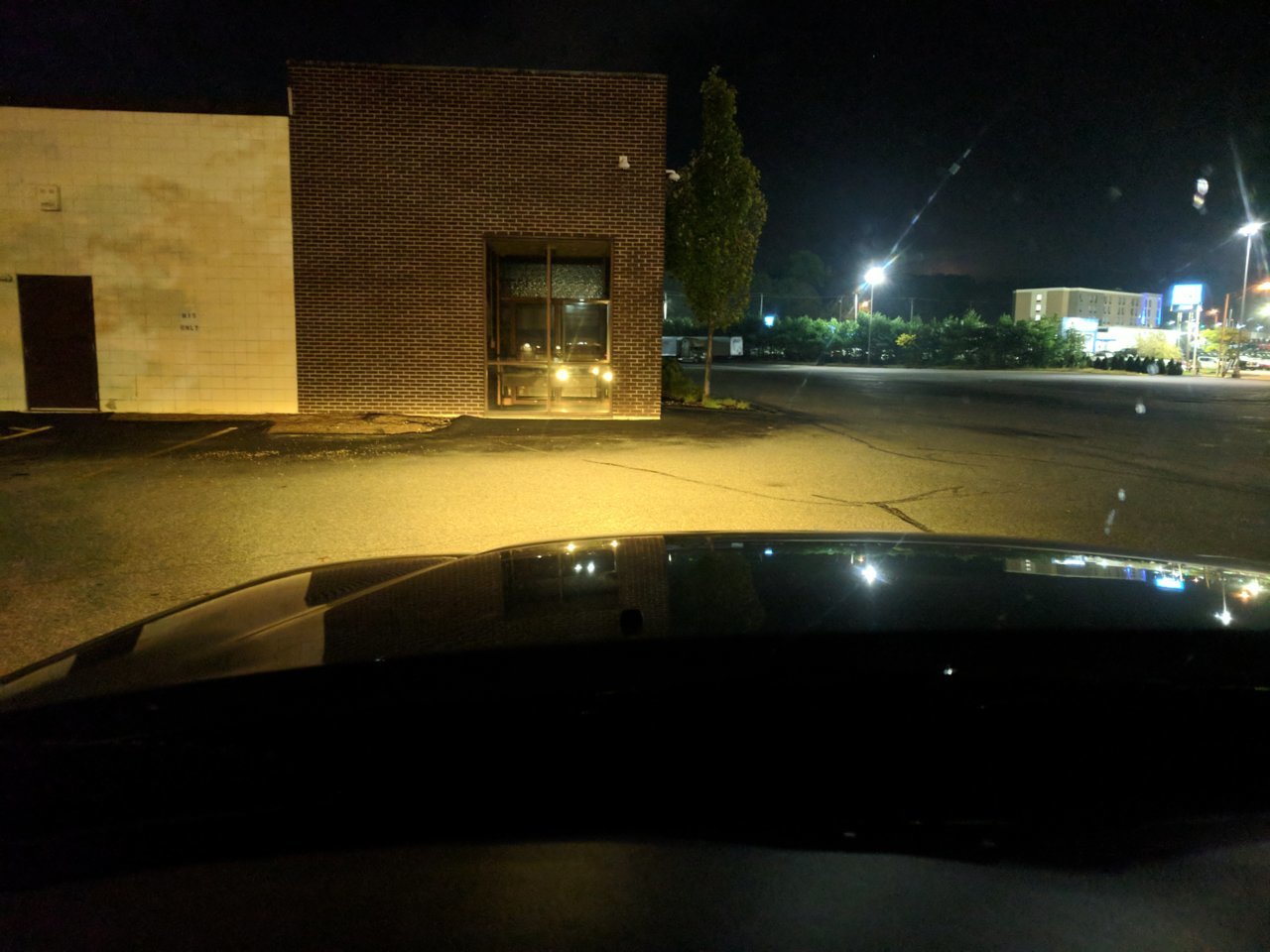

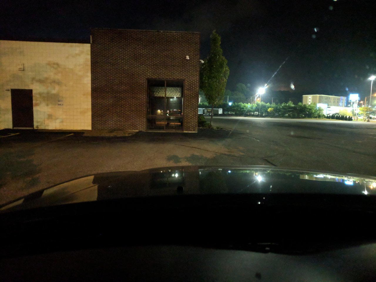

    Just upgraded my Nokya Hyper Yellows to 9005
    Took less than 30 seconds to modify each bulb.
    BenMara likes this.

  12. Oct 5, 2018 at 8:16 AM

    All good. I put in Philips +130% in the headlights and +100% in the fogs, one light at a time to observe the difference standing in front of the truck. It's noticeably brighter, and whiter in color but also in 12yr old housings that have seen better days. Anecdotal evidence so far is that slow people are getting out of the left lane much more quickly (ie. notice I'm coming). However I've also had 2 people merge in to me (ie. I have to defensively change lanes) in the past 12hrs so the verdict is still out. Maybe I need a horn upgrade.

    Nice and yellow.
