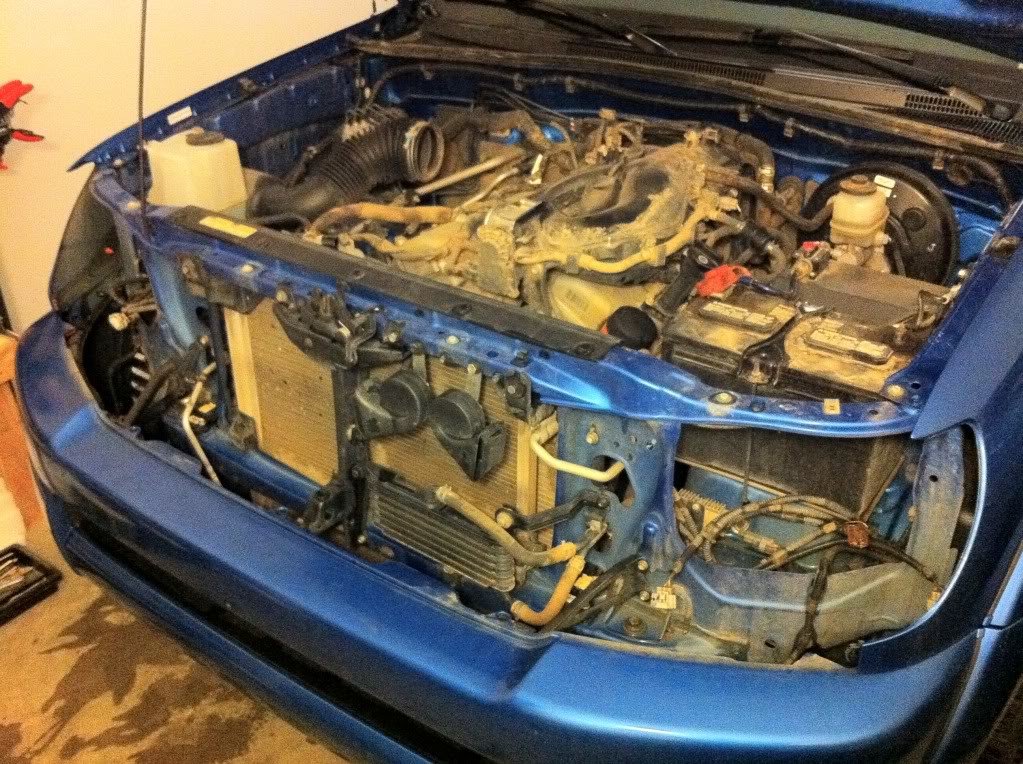

    Today was quite productive...changed/replaced the following.
    -Engine Oil
    -Engine Air Filter
    -Power Steering Fluid (flushed system)
    -Front Diff Fluid
    Carpet is all dry and I'm going to have a friend who owns a carpet cleaning business give it a go over the weekend when he has time. I also brought the truck to a self service car wash place so I could blast a lot of the truck clean and get most of the dirt out of the radiator.
    Tomorrow I tackle the spark plugs, MAF sensor, and throttle body. The headlights will also be coming out. The ONLY thing I broke (so far) during this whole ordeal is my right turn signal. When I dismantle the headlights I'll be doing the black housing mod too. Might as well as long as I'm in there.

    Pulled the headlights about an hour ago. That 4th bolt can be accessed by pulling the fog lights. I think this is likely easier/less of a pain than going through the fender well. Plus, my fender wells were covered in mud so yeah...
    I poured about half a gallon of water out of my headlights (combined) and will be doing the black headlight mod either tonight or tomorrow.
    Just finished gapping 6 new spark plugs too. Those will go in soon as well.

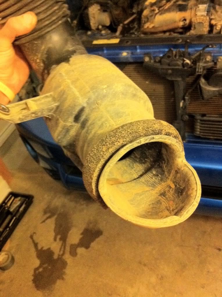

    Today's progress was quite good; much like yesterday. I started by removing the headlights so I could drain and paint them. As I said before, I decided against removing the fender well to access the 4th bolt. I found that removing the fog light was easier. I'll open those up tomorrow.
    I started with stuff under the hood by dismantling most of the upper intake system and manifold. I wanted to clean the throttle body, filter housing and check the intake portion in the fender well. I also had to take a lot of this off because I needed to get to the spark plugs so I could replace those too. If you check out the last two pictures it was clear that the intake was submerged. Doesn't look like any of the water/mud got past the filter though. The throttle body showed no signs that it got any and the manifold before the throttle body didn't have any in it.
    (thanks chris4x4 for the spark plug write up)
