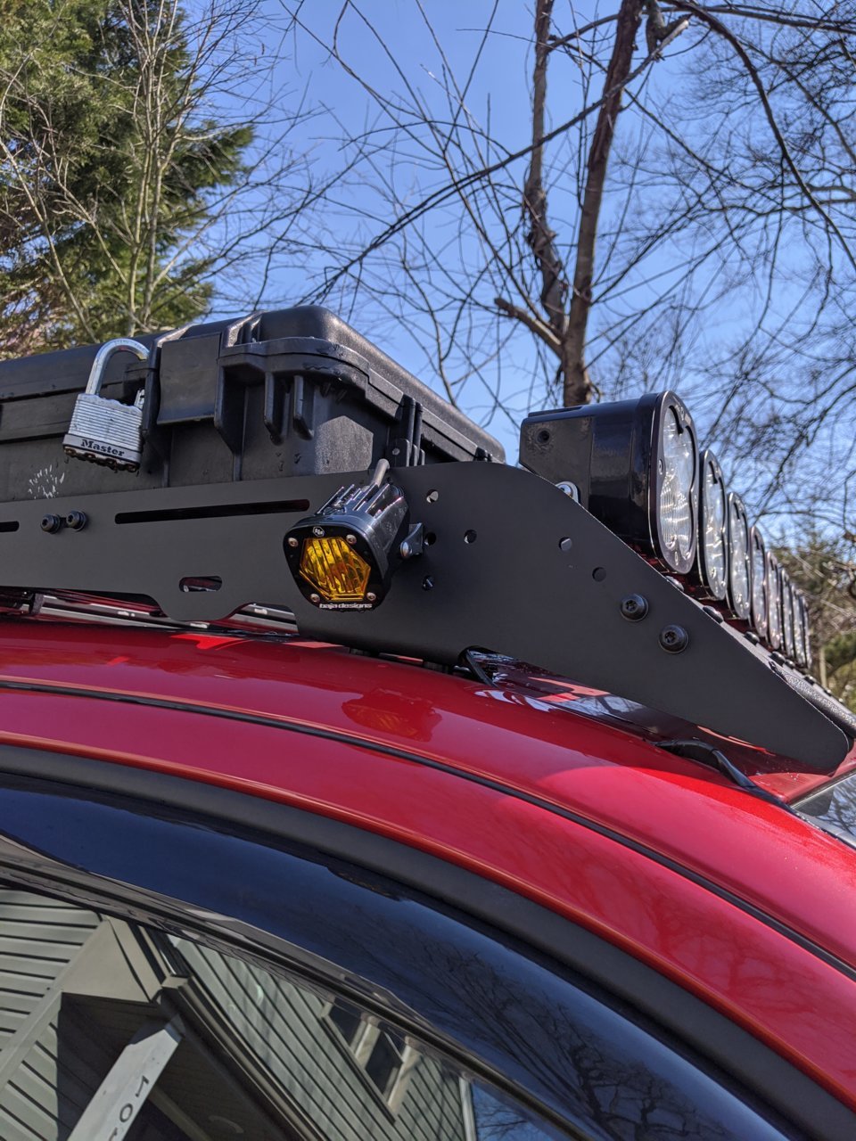

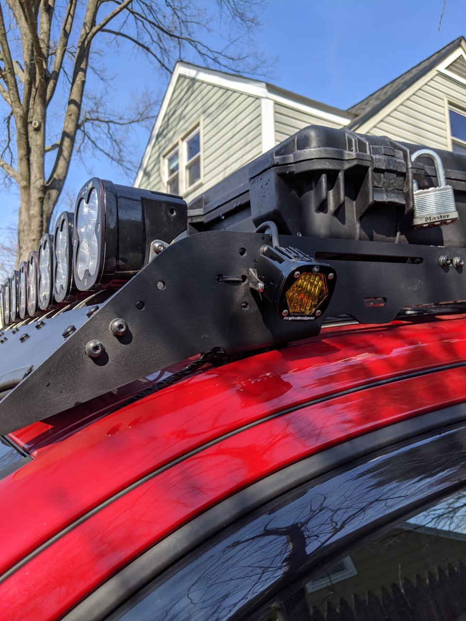

    I'm not done wiring them up yet so they can't count towards the total yet.
    I've got two more coming from @EatSleepTacos so I'll wire them all up at the same time.

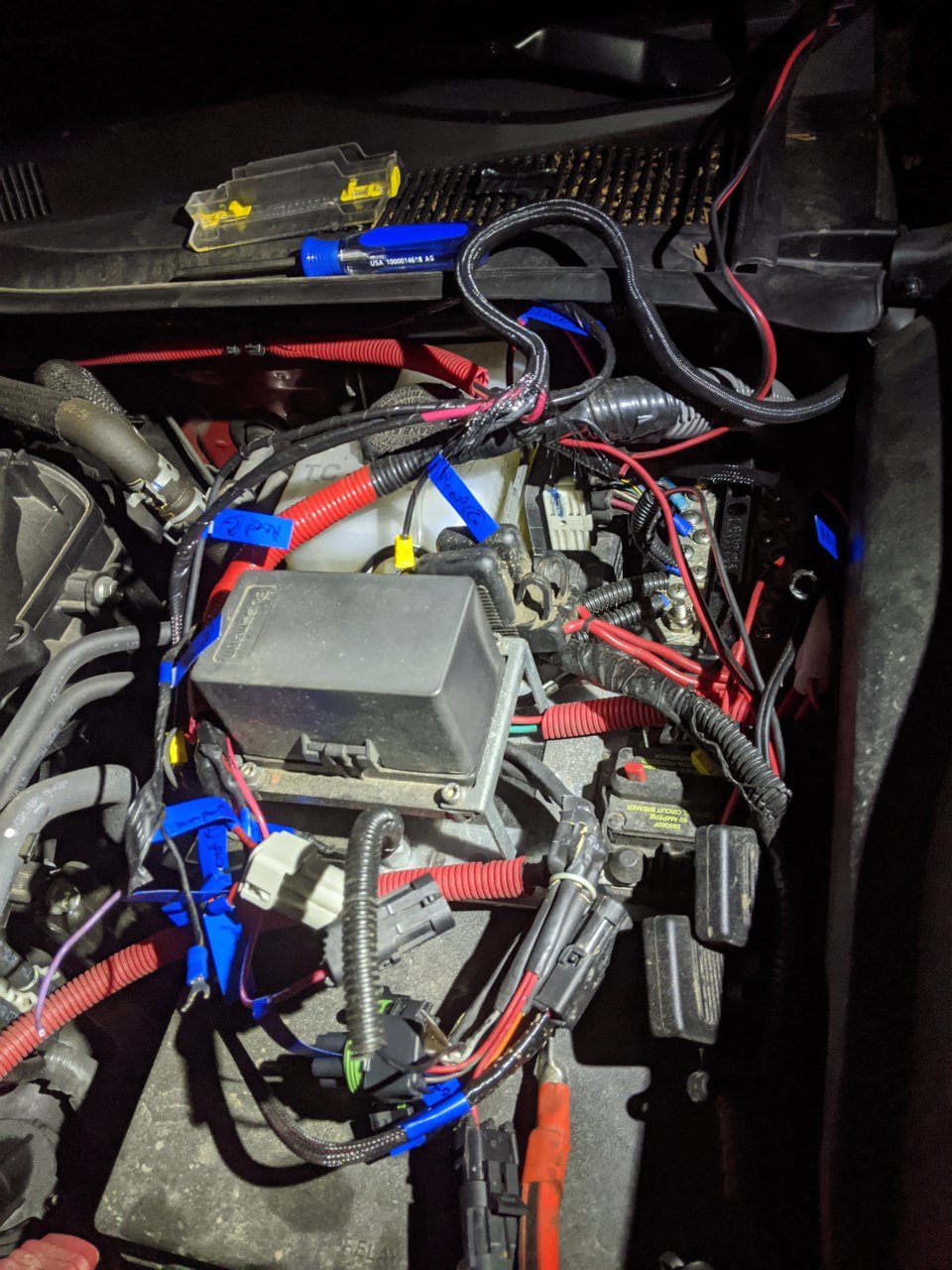

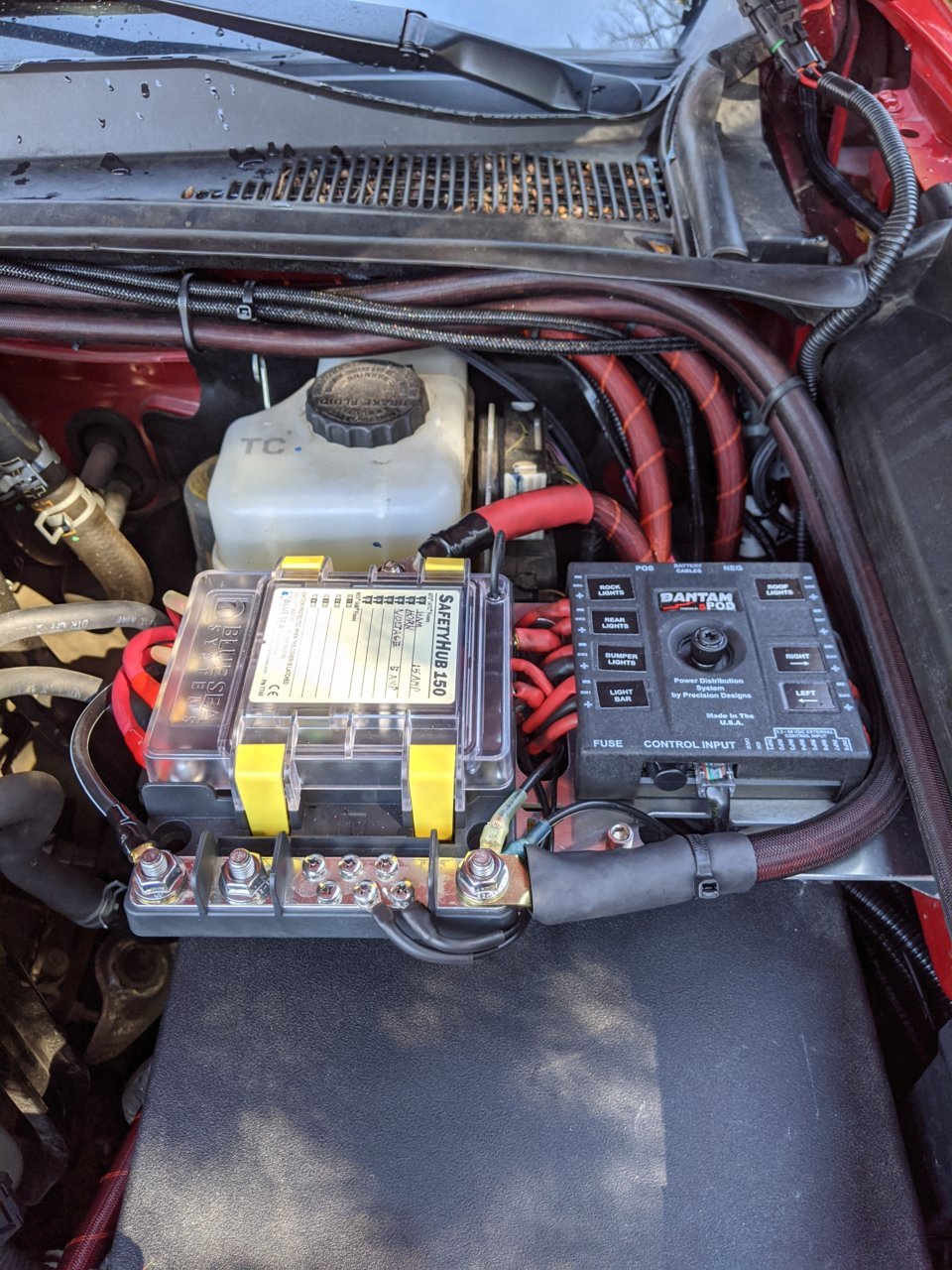

    I've been spending a majority of my time completely rewiring the entire truck. When I figured out I was pulling 84 amps with my lights I realized something had to change. I originally made an electrical distribution unit myself but it was only designed for 60 amps. Add on after add on made the whole thing a mess. It also made it so I couldn't turn all my lights on at the same time if I wanted to.
    Here's a picture after I took most of it apart for labeling.
    I decided to go with a sPod and Power Tray. At the same time I installed a dual battery to give a little more pep to the lights. I made my own battery cables because I wanted a larger gauge than all the kits offered. Most offer 2 gauge and I went with 1/0 gauge.
