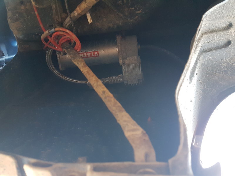

    If you can't tell where that is, it is directly in front of the passenger rear wheel, between the bedside and the bed itself.
    I mounted the compressor directly to the bed, on it's side. and if you wanted to run dual compressors, there's just as much room on the driver's side (I'm hoping to add another compressor there eventually).

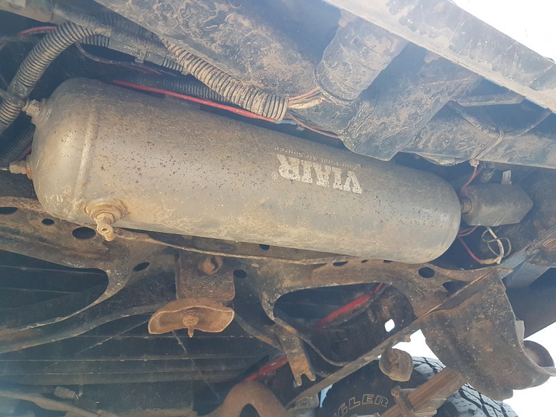

    I mounted my tank under the bed where the spare would go, like most people do. It doesn't even come close to hanging below my HC rear bumper, so I'm happy with that. I had to use some iron to get the bolts to line up with the "valleys" of the bed, as the viair 2.5 gal tank is exactly the wrong bolt hole spacing.

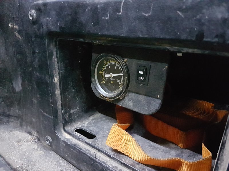

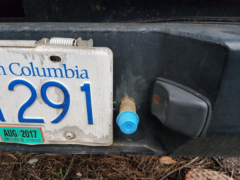

    I mounted my pressure gauge/switch in the passenger side cubby behind the AC power, and wired it into the keyed trailer power, so that the compressor can only run if the truck is on. I conveniently located the compressor intake in the cubby above the wheel well for nice clean air. and finally, I drilled a hole through my HC bumper, just beside the license plate for my quick connect, as it's nicely protected in that spot, as well as easily accessed.
