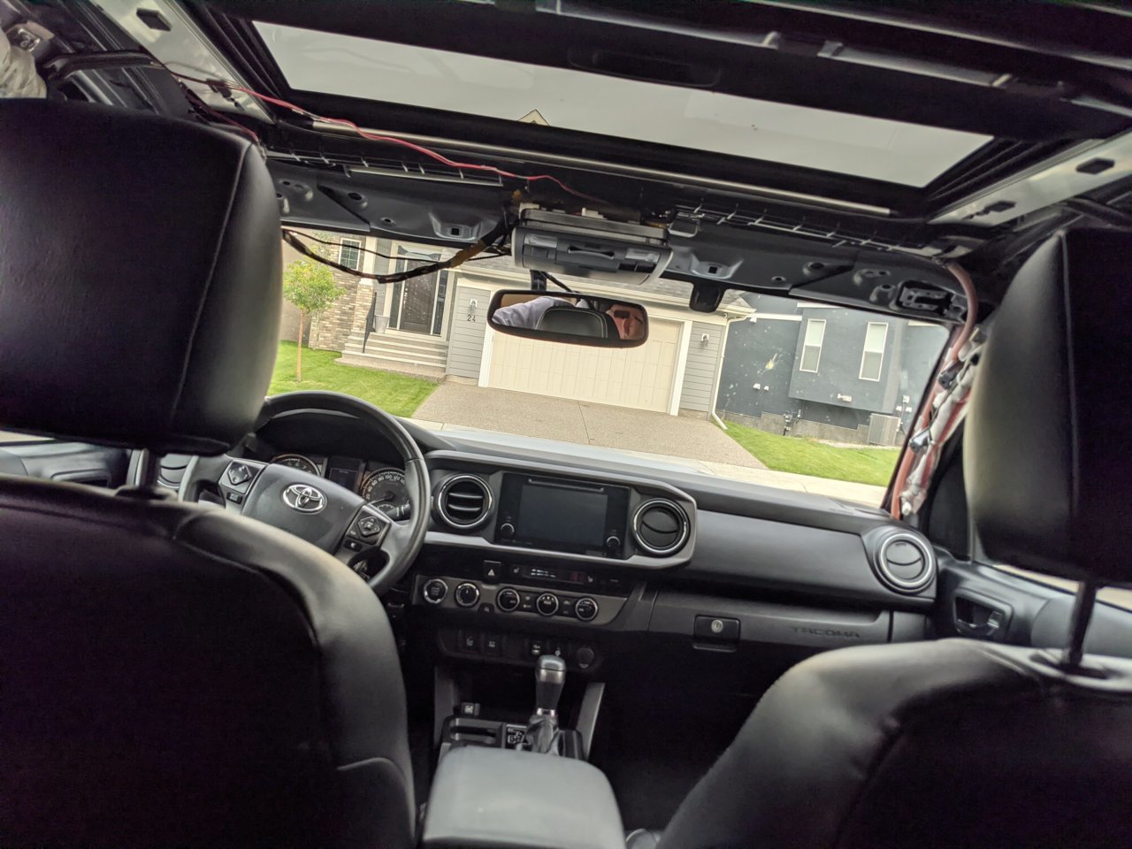

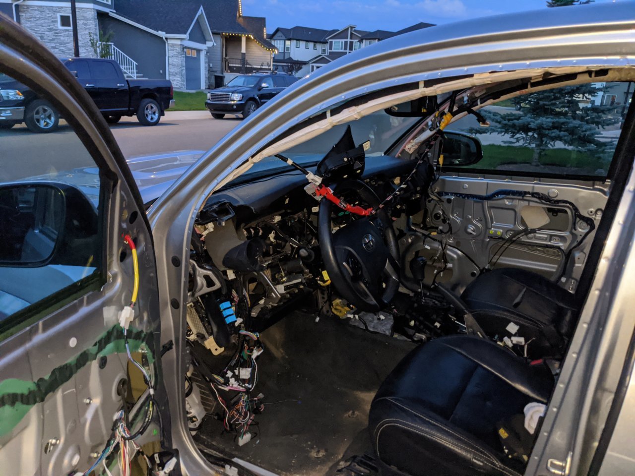

    I bought this vehicle with a good title but it was torn apart, literally on the inside and needs quite a bit of body work. When I picked it up, every module was ripped from the vehicle and it only had seats, carpet and wiring. Even the headliner was ripped out. - aftermarket Katzkin - aftermarket rear heated seats - upgraded sound system - Dynamat throughout.

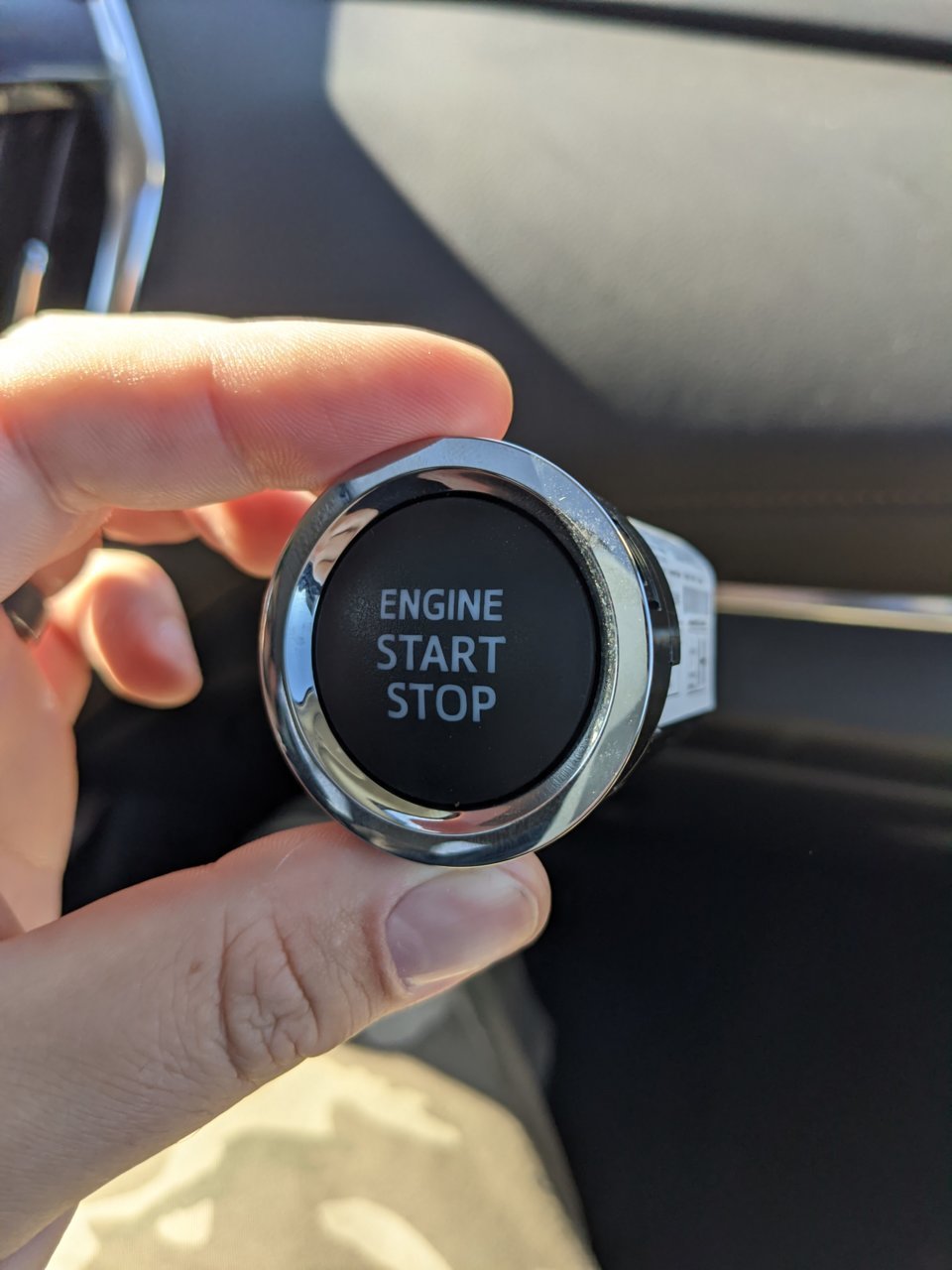

    So I called Toyota to get a push button start, button. I'm told 5 weeks minimum and $500 CAD. So... Nope!
    I looked online and found KTJO 4*4 and I ordered a push button from him with the red button.
    I ordered it next day DHL but unfortunately with Covid nothing is next day.
    While I waited for 3 weeks, I ended up finding a stock one at a wrecker in another city that also had a dash pad. It was a bit scratched from windshield glass but it wasn't too bad at all so I went and grabbed it.
    I had a lot of work to do on the dash, it has a lot of tiny scratches. I got out the torch and heat gun and went to town. I got it pretty good. I'll take some pics of the dash soon and post them.

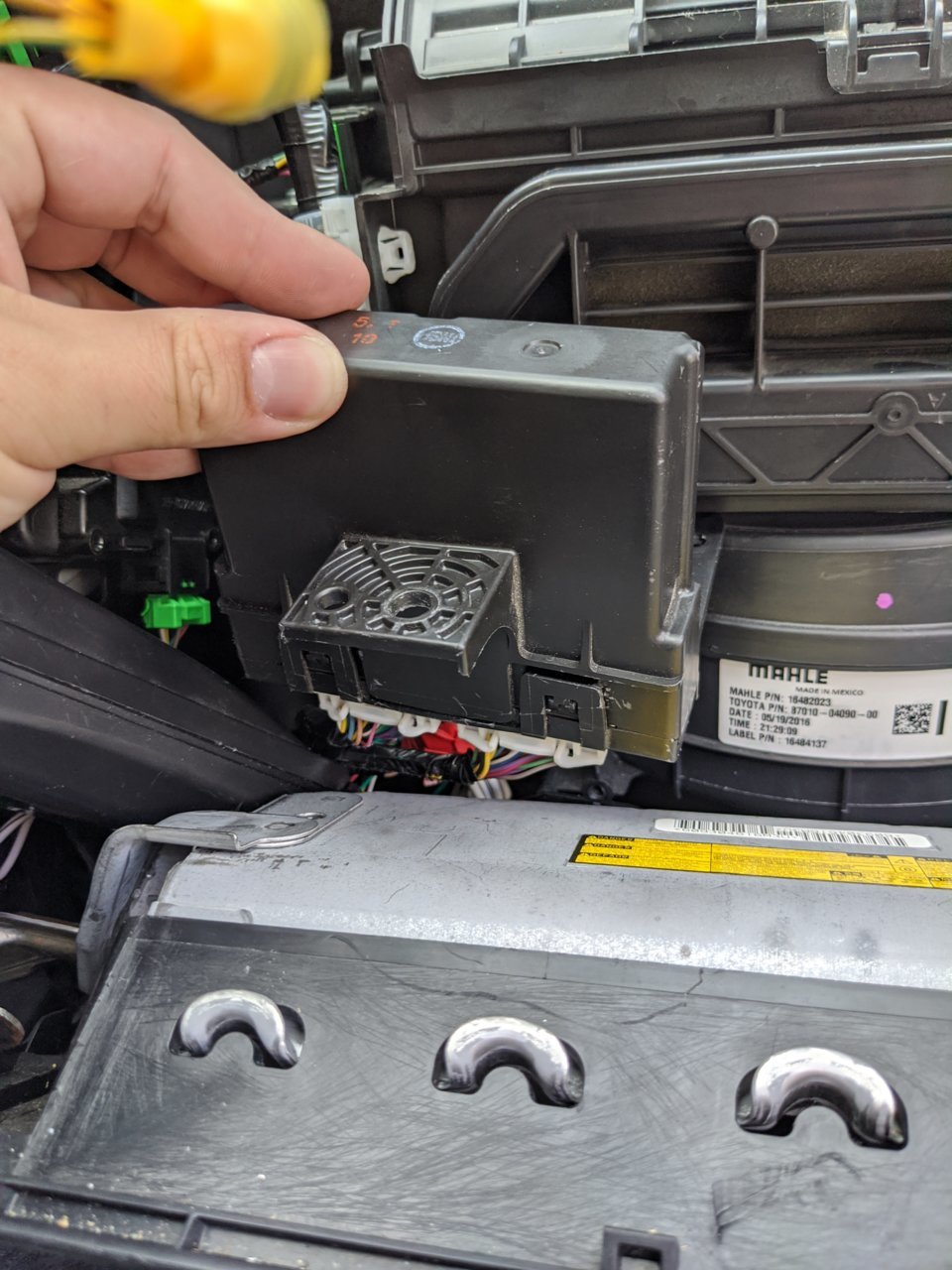

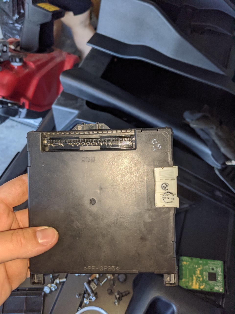

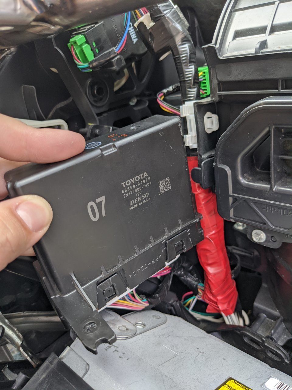

    In the meantime, I had to start putting in modules. The Facebook group for great north tacomas was super helpful. I was able to track down all of the modules and get them installed.
    That was some of the modules as I took photos to identify them. I got them all installed and then I put the rest of the dash together. Then it looked liked this.

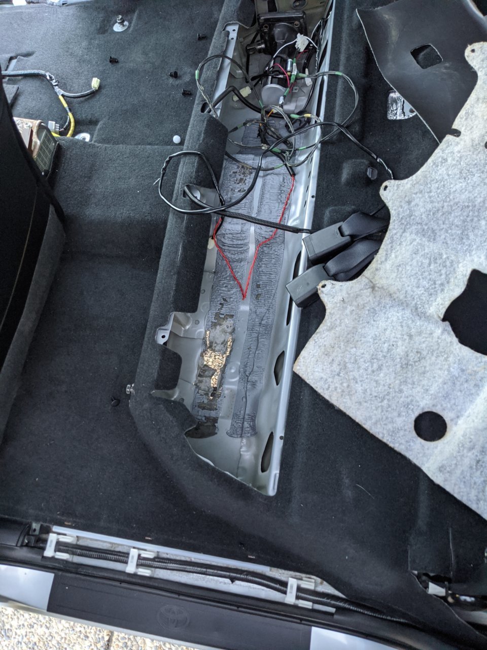

    So at that point, I called a locksmith. F towing this thing to the dealer. $200 bucks later I got the truck running without a single CEL and he even had a mobile laser cutter and got me a key cut to match!
    So now I have a key reseed done, truck is running, and I have manual laser cut key without having to take it to the dealer. It took about an hour but it was worth every penny.
    So all seemed well in the world until I saw this... Yup... He bashed a hole and in the floor and yes, that is the brak and gas mines right below there!
