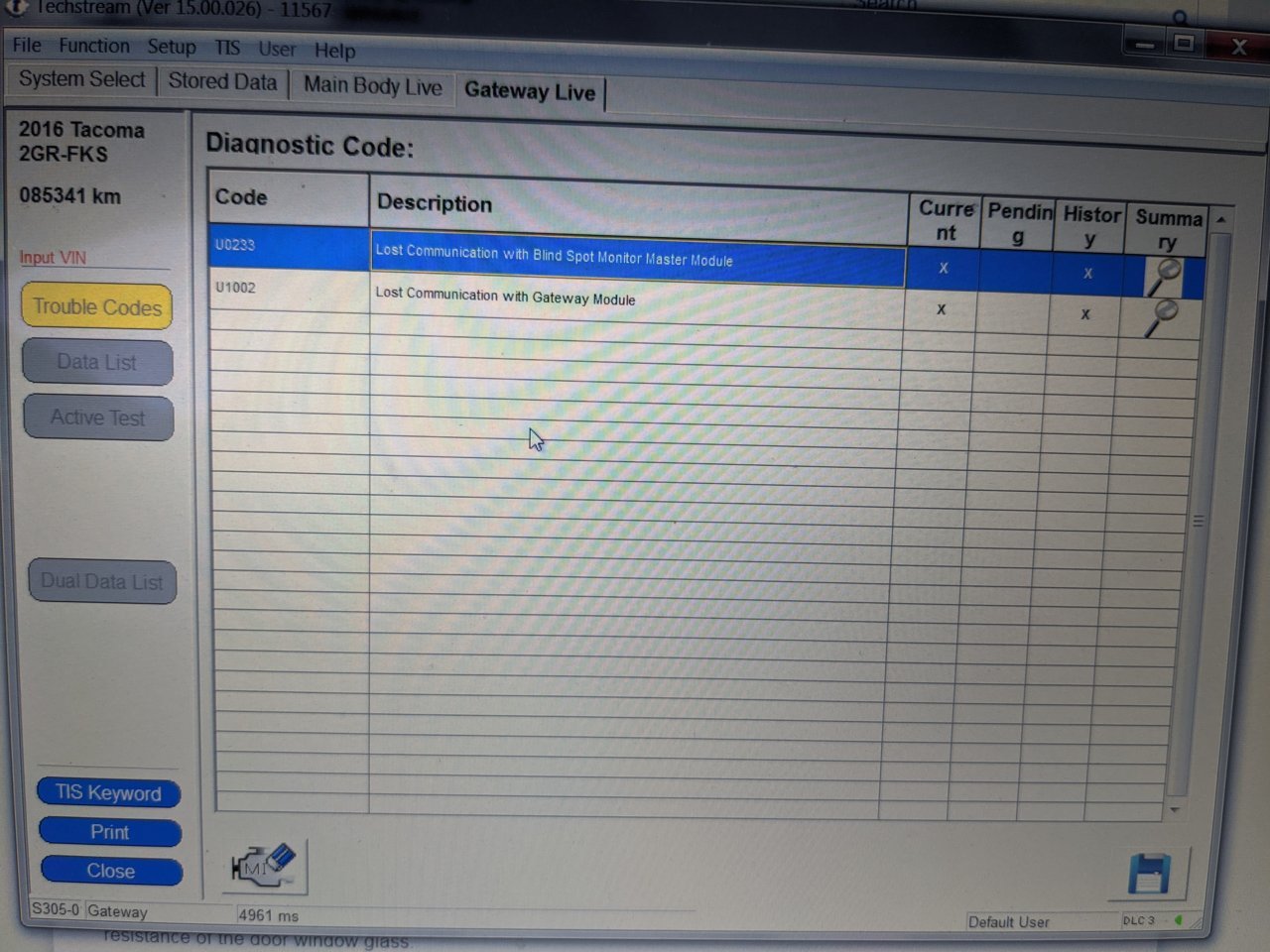

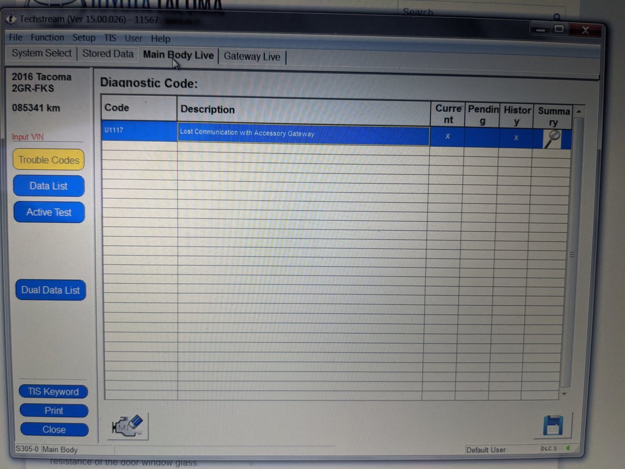

    So now that I have techstream running and licensed, and I got my cable, I decided to run codes and see even though there was no CEL.
    I am mostly focused on 3 issues right now.

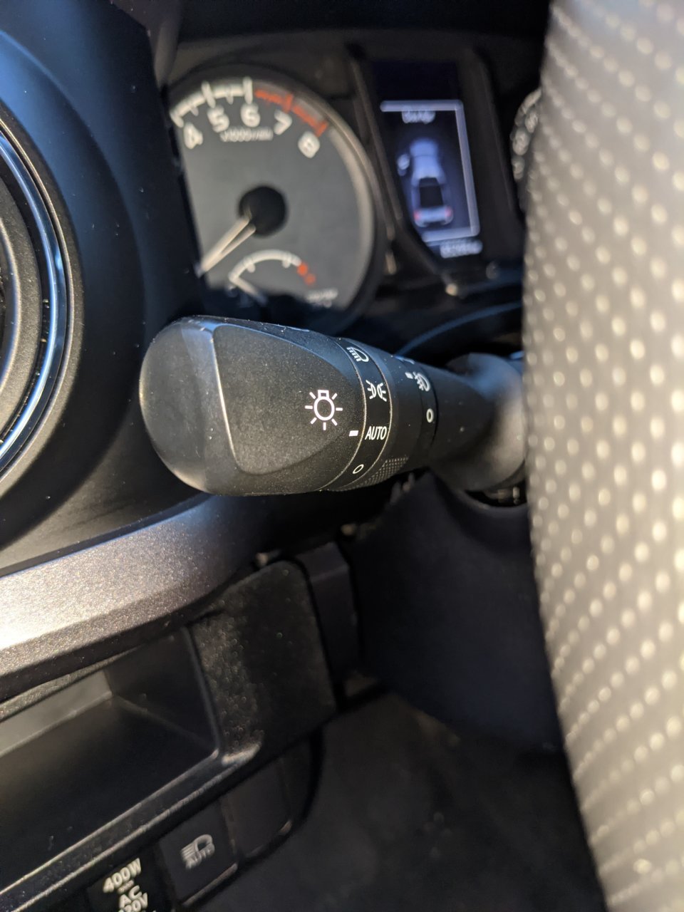

    1. Auto headlights.
    I tested the light sensor. It's working. I saw the data in techstream be when uncover the light it registers. When my stock is set to AUTO though, nothing happens.

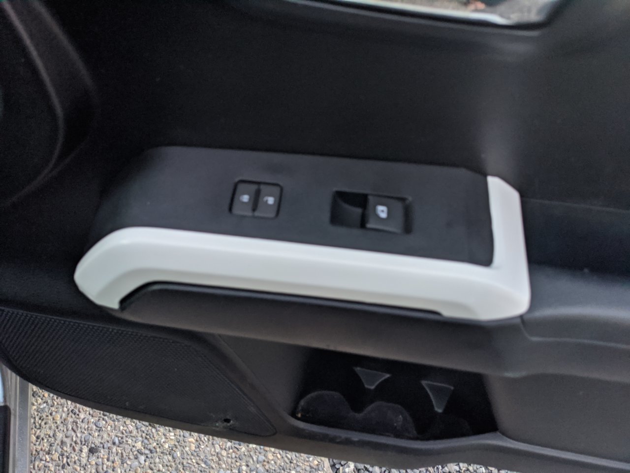

    2. Power Windows
    Driver's window works with its own switch
    I reinitialized the passenger window and now it works with the driver's switch.
    Rear driver's door works with its own switch.
    Rear passenger door does nothing. I have tested it with the rear driver's door switch and still nothing. I took the door panel off and still couldn't find anything but that was tonight and I ran out of light.
    The passenger and driver's front also work on the driver's panel but the rears both do not.
    3. A cheap headliner that isn't going to cost me $2k without install!!!!
