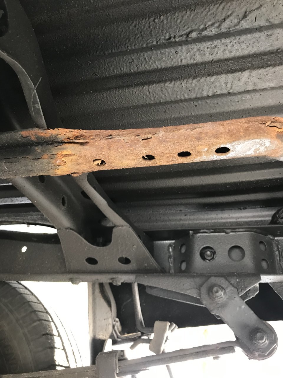

    My trucks been undercoated every other year, with the spare tire in place. Dropped the spare for the first time to find this untreated bracket completely toast. I'd say its working! the rest of the truck is solid.IMG_0311.jpg

    I'd say it almost worked.

    I always love when non rust belt folks look at undercoated trucks like they're carrying the plague or something. "it's so messy! I'd never wanna work on that." Yes, but it's either that or be orange dust. Pick your poison in a salt state.
    What did you use for an undercoat? It looks like it could be Woolwax or NHOU, but I'd have expected it to gather more dirt

    Looks like ziebart, or something rubberized

    The undercoating is WoolWax.
    This is WoolWax although I may have used fluid film a few times as well. I think they're essentially the same.

    This is Wool Wax. I pressure wash it maybe once every other week in the winter. There's definitely a good 1/4inch of dirt embedded in the coating in certain areas lmao.

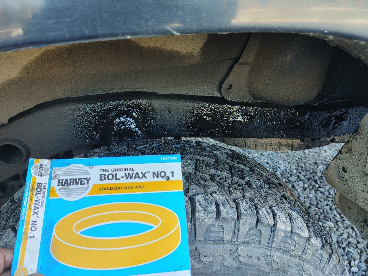

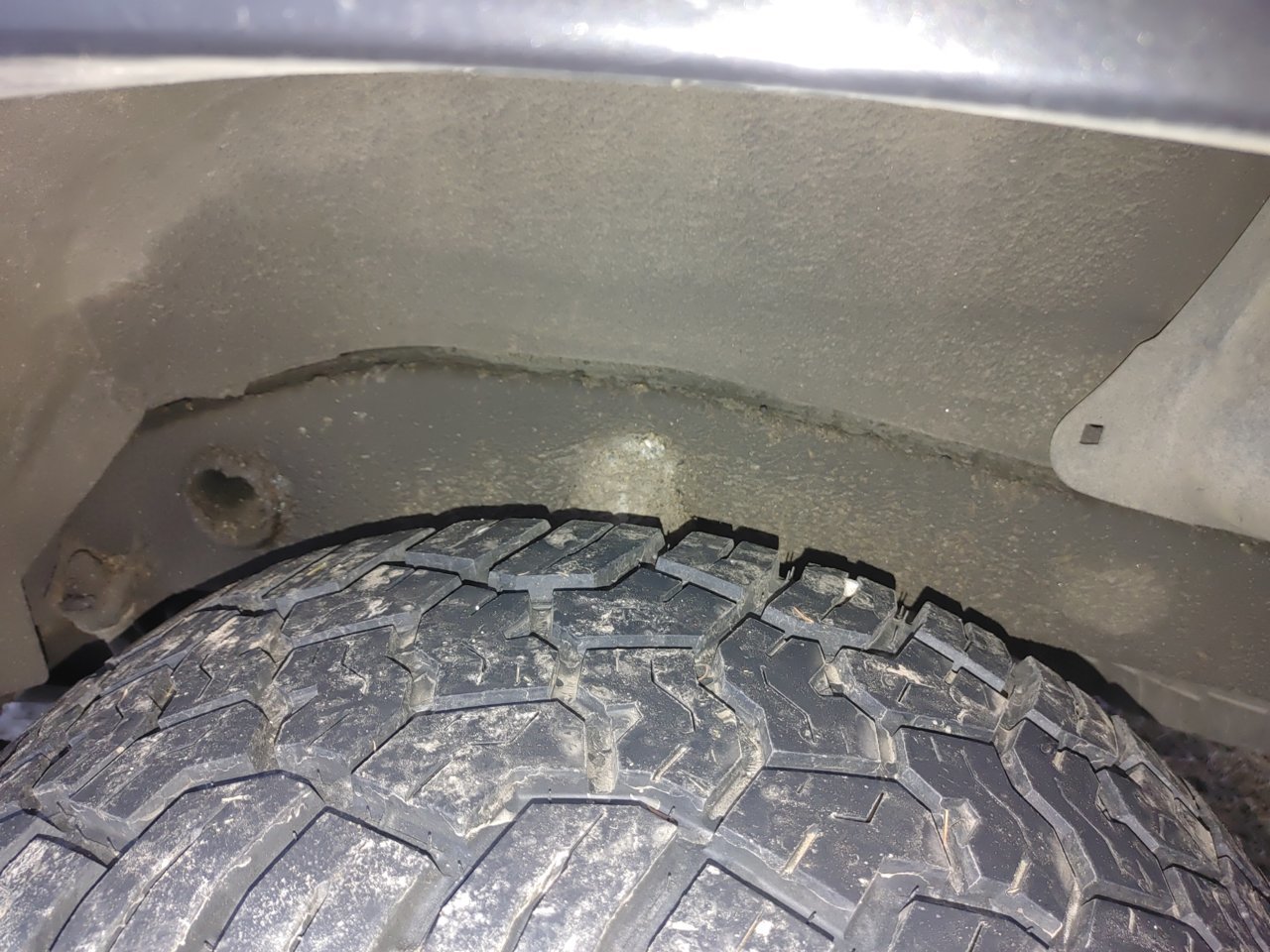

    If you're willing to have your frame be a little ugly toilet ring wax works great to plug up those holes. Just cut sections to fit and squish it in there.
    It's not pretty, but it's cheap and lasts pretty much forever

    Thanks. Always interested in an effective and cheap solution.

    No prob haha, always happy to see people willing to try it. Way better than having a slurry of salt and mud in there

    My vote for the #1 use of an alternate product for our trucks.

    Been having my truck done with nhou by my friend at northeast rustproofing and man does that stuff creep into everything. I think thats the biggest advantage it has. It probably would have protected that crossmember without even spraying directly on it. Either way the salt is ridiculous now a days! Protect your shit!
