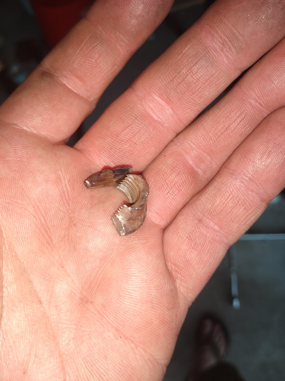

    Well...the dremel got her done..made verticale cuts on 2 opposite sides and when I wrenched it she broke off..now off to the other side.
  9. May 16, 2020 at 5:17 PM
    #49
    Taco302
    Taco302 [OP] Well-Known Member
    Jun 10, 2013
    #105981
    764
    Greenbow, Alabama
    2003 2.7L 5 spd 4x4 xtracab
    Heated with a torch between cuts..not sure how much that helped but it broke soon after

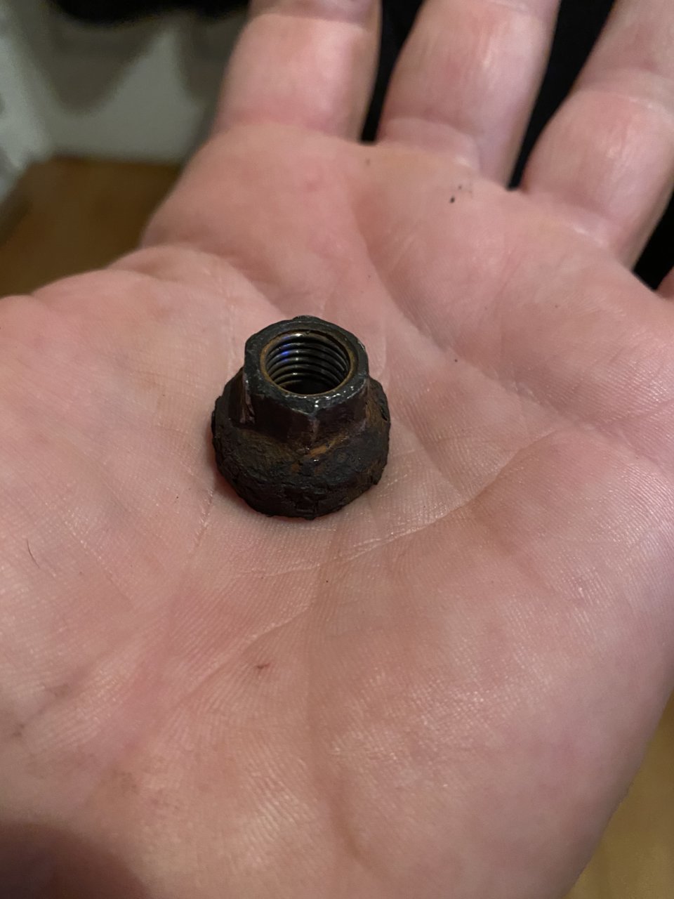

    This thread touches my soul..I just finished my install yesterday, that thing is the devil!. I had that very same impossible nut. Except it was the inside one next to the frame. Where no tool could go. I PB blasted and wire brushed and rocked it back and for for a week with a 6 point wrench before install day. I finally got I to crack loose just the tiniest bit, the day before install. My neighbors must have thought I was crazy I whooped so loud. Well...fool me once. I spent 2 solid hours, turning that nut about 1/16 of a turn. And every 1/16 turn took every thing I could muster. And that’s after torching the shit out of it. The threads were so gobbed up with rust, it almost put the kabosh on the whole operation. I kept that nut. I had to cut out my LCA’s with a sawzall. But I kept that Stupid. Fucking. 14mm nut. I’m going to glue it to my dash as an eff you, I got ‘er done type of thing.8C555D22-0C1C-4085-9E5A-529BDCB706B3.jpg
