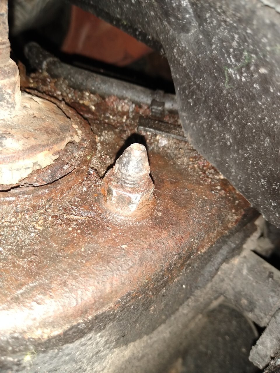

    Well...job complete..new coilovers, new shocks. The driver side went much faster because all the nuts came off with no issue. Letting them soak in PB helped a lot and I torched each one.
    However, the left rear nut (driver side)does not provide enough clearance to use a socket so you need to wrench it..a ratchet wrench would be ideal.
    I went for a test drive after i was done and it rode great. It cornered better and handled all the bumps better also. Getting an alignment tomorrow.

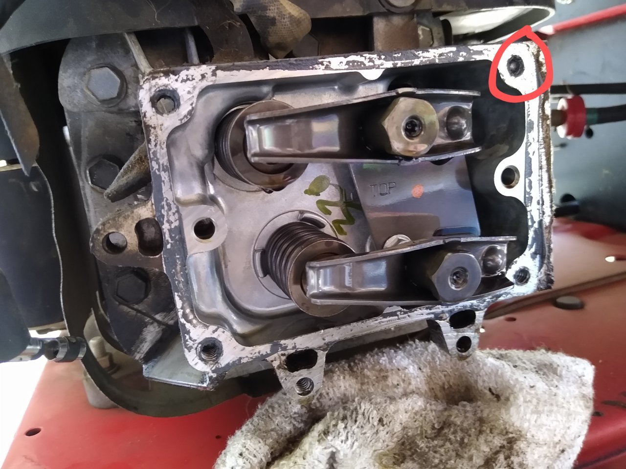

    Welp...valve cover gasket was leaking on my riding mower and I broke a bolt off...almost the whole thing except the head. Should I attempt to bore a small hole in the bolt and use a screw extractor?
    Note: it is not rusted in place, I removed it and when I was bolting it back it snapped.

    Can you just drill it out and put a longer bolt with a nut on the other side?

    It is threaded and I think oil would leak from the back side..unless i rethreaded the new hole.

    I have used Speed Out with 50/50 success. It is usually at Lowe’s or Home Depot.
    Watch videos on how to use , google them first. Will give you better odds on it working
    Since there is no Phillips or Flat head markings you may need to drill a small hole in the broken bolt to get the speed out started.

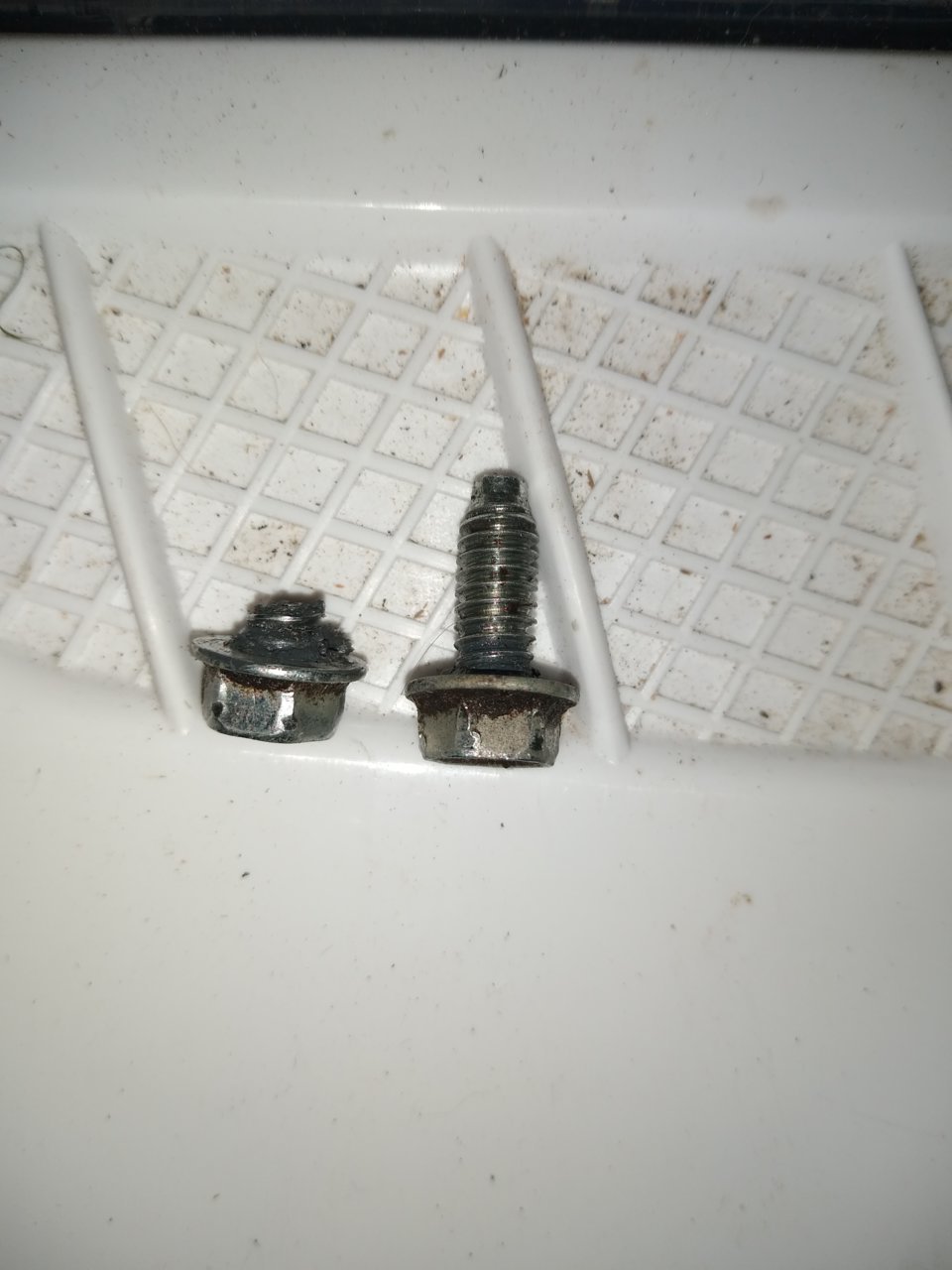

    Here's a pic of my hardware:

    Air hammer that thing off and put a new strut. I've had good luck with an induction heater, but its kind of a specialty tool.

    Yep that thing. But if it's getting replaced brute force will be easiest. I didn't realize how old this thread was. I'm sure he's figured it out since last year!

    I had this exact problem, rusted/rounded and couldn't get a reciprocating tool in there because it was tight (the offending nut was of course the one furthest into the wheel well).
    I didn't have a Dremel or anything small and I wound up cutting the d*mn thing off in negative temps with one of those $5 micro hacksaws. Worst two hours of my life...

    Going back to that original issue with the nut on the top hat...just had that exact issue last night.
    I soaked them, no luck....could not get a socket in there straight enough. Stripped the nut.
    I ended up using a 3/4" belt sander I had laying around with a 60grit belt. Ground it flat and it popped off. Then knocked the stud put and replaced it with a similar one I had laying around the garage.
