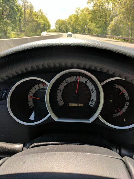

    Replying to my own thread. Why not?IMG_20170509_112123.jpgSo it looks more like 2k at 65 so I am looking forward to see what the difference is.
    Now I am going back to Pasti dipping.

    Are you actually going 65 tho? Or is that just what the speedo says? Check with a GPS app.
    I'm going to go with 4.56's and a 31.5" tire, it's not a highway cruiser or a daily driver though.
    Gcsteve[OP] likes this.

    Yes I have checked and the speedo is very close to the GPS with 2 mph. I am more of HWY cruiser. Will be taking it on trips in the future.
