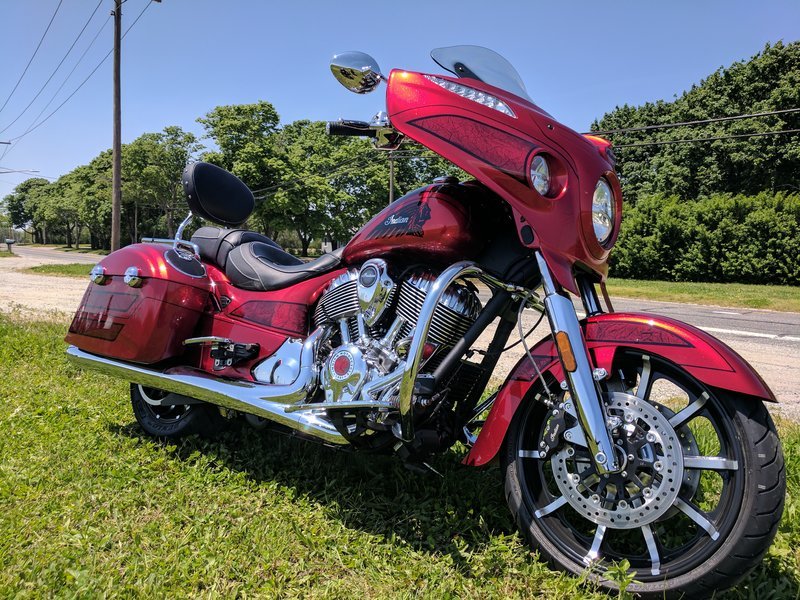

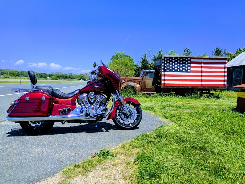

    Going to slow down on the mods for a while. Theres a new member in our fleet line up and this bitch is going to keep my OCD level cranked all summer and fall. My wife named her BadGirl.IMG_20170519_124829.jpg IMG_20170519_132353-EFFECTS.jpg

    Beautiful bike!....my favorite color.
    110?

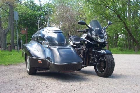

    Nice bike indeed. I had to give up solo riding due to failed hips a number of years back.. I was riding a sidecar rig, up until the point i got the Tacoma.
    Going on 7 years of it sitting in the back of the garage, got to get back to it as a project again once i'm finished with this danged truck.
    Yes. It's different. Now you know where i get my odd styling cues and tastes with the truck.

    Thanks, It is a new 2017 Indian Chieftain Elite 111. I traded my 2015 Indian Roadmaster for it. 90 second video of it gets me excited every time.
