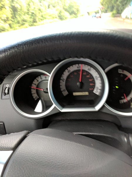

    so I just picked it up and so far feels pretty good. Gets into the power band around 3k much easier. Pick up is better and seems to change gears at more rational rpms. So I will post up after some more driving around next week. rpms at 65 are maybe 300 more so no real huge difference but it feels much better. I am going to keep my 235s on there for now. Don't want a set of 31s to put me back where I started.IMG_20170602_163740.jpg

    You shouldn't be driving that fast after a regear. You need at least a 100 mile break-in period. The brand new gear and pinion are still rough and heat up very easily.

    O.k. good to know. I was wondering about the break in. It was only for about 3 seconds on a short road around here. Thanks. I will take it much easier for the next few days.

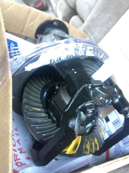

    4.56 LOCKED now
