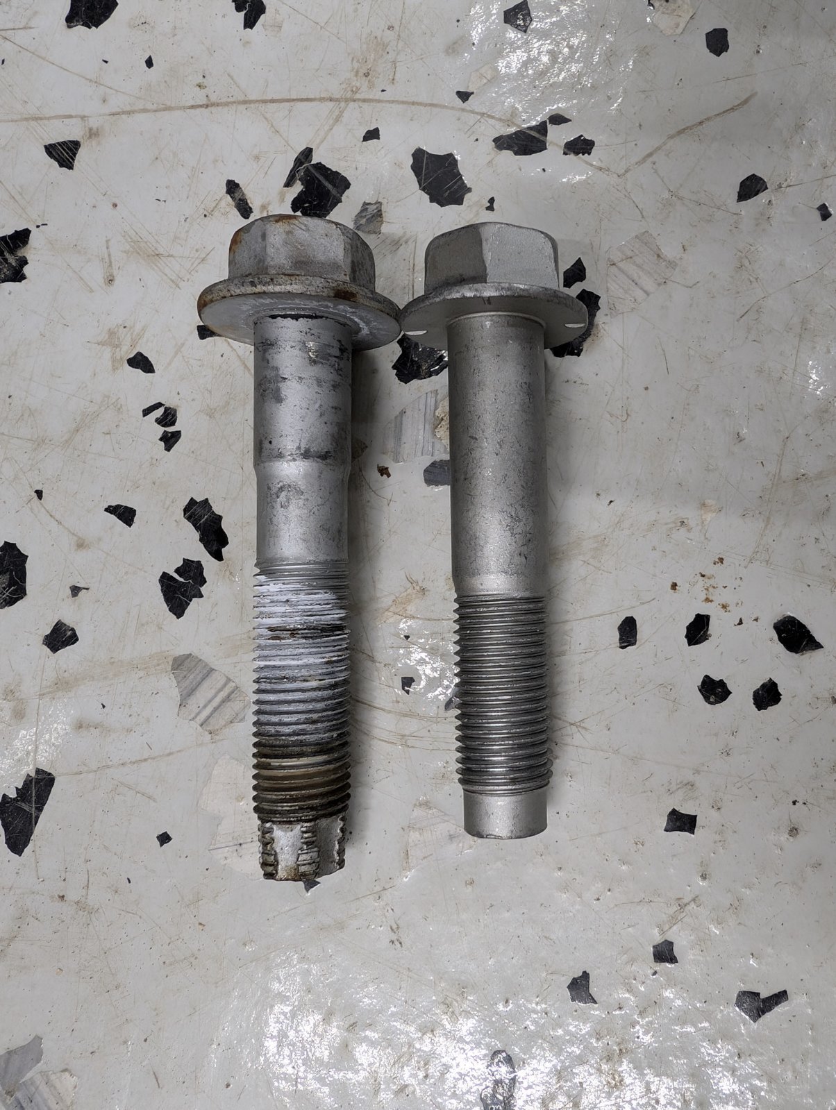

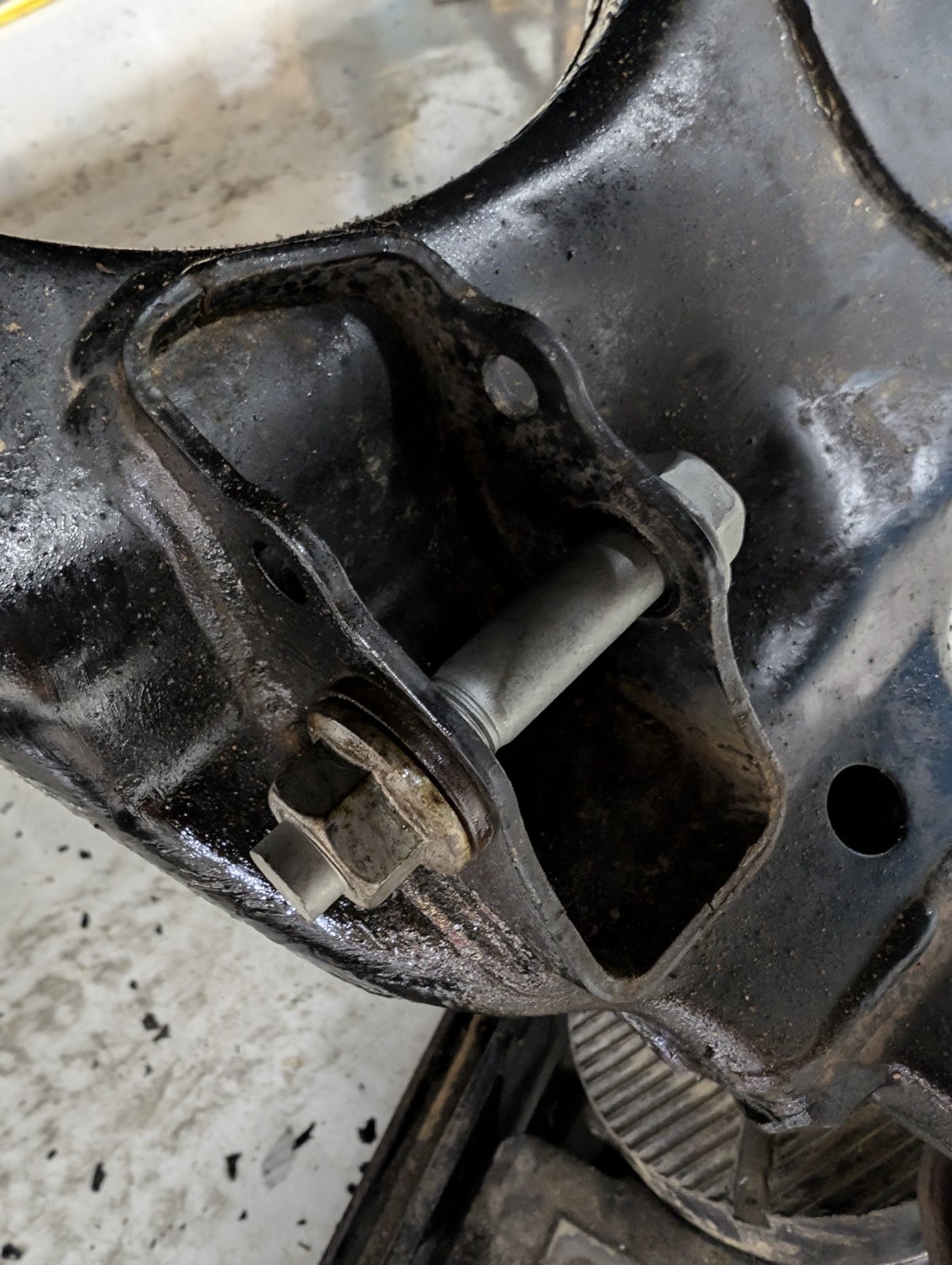

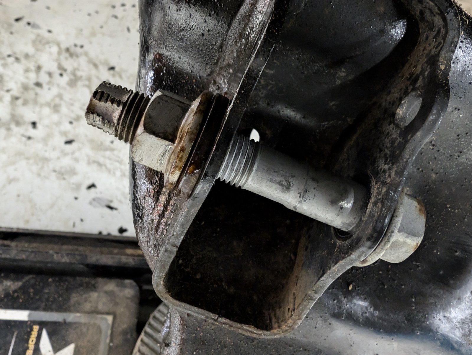

    I swapped the bolts out this weekend while installing my TRD lift. The amount of play between the bolt and the shock was about the same with both the old and new bolts. Even with the longer shoulder, the bolt is not a tight fit in the shock. I wonder if the whole premise of this mod is wrong? I suspect it's actually the clamping force of the shock mount on the metal part of the bushing that holds it in place. Even if the bushing can slide in the shock mount, it can't rotate.
    The new bolts are slightly shorter, but there is full thread engagement. The length difference might only matter if you're a robot in the factory.

    What you have to keep in mind is the use of the aftermarket bolt with a longer shoulder than the 4R bolt. That was the original modification. Insert the AM bolt as you did in your photos, and you will see the difference.
    The aftermarket shoulder helps support the entire bushing sleeve. It’s been over a year since the installation with a lot of wheeling/articulation, and my Taco is still click free.

    I might be confused, or thinking of a different thread about 4runner bolts. Are you saying the aftermarket bolts are an even better fit than the 4Runner bolts? Because I didn't notice much difference between the 4runner bolt (which has a longer shoulder) and the original Tacoma bolt, in terms of how loose they fit in the bushing.

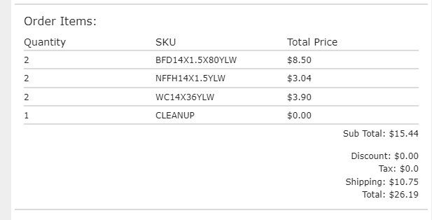

    It looks like we are ordering JUST the 4Runner bolt 90105-14104 now? Not the fancy bolt,nut,washer from belmetric?

    I would suggest the AM bolt as was done by the original member who shared this trick.
    The step in the shoulder/shank of the oem bolt doesn’t support the sleeved bushing fully, thus eventually failing with an annoying click sound. The AM bolt supports the bushing nearly the entire length of the pocket.

    I guess my question is, are the aftermarket bolts better than the 4Runner bolts (pictured on the right), which also don't have a stepped shoulder? I was unimpressed with the fit of the 4Runner bolts.

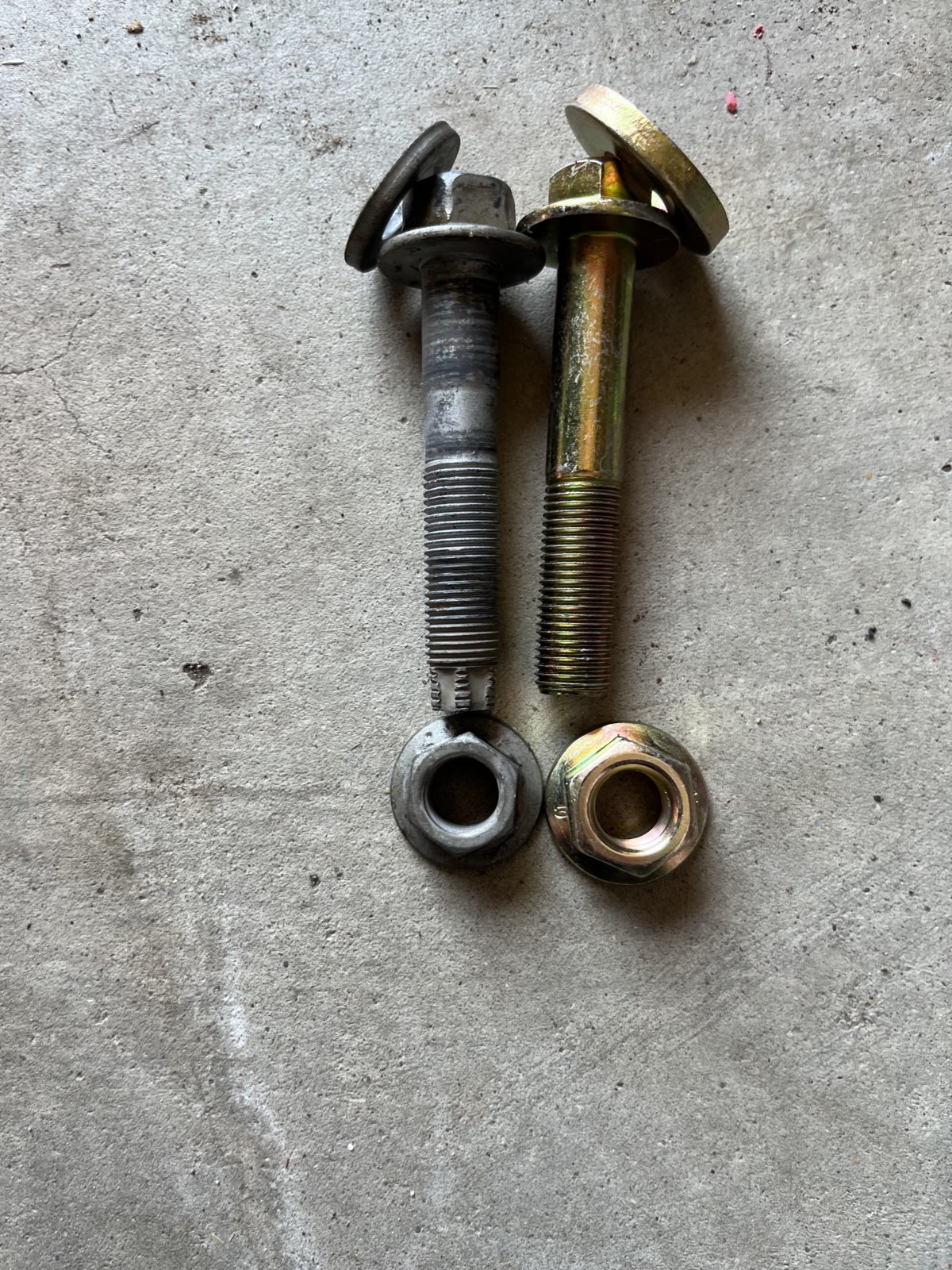

    Oem vs belmetric
    I haven’t taken a drive yet but I turned the steering wheel back and forth lock to lock a few times and my clicks seem to have left.
