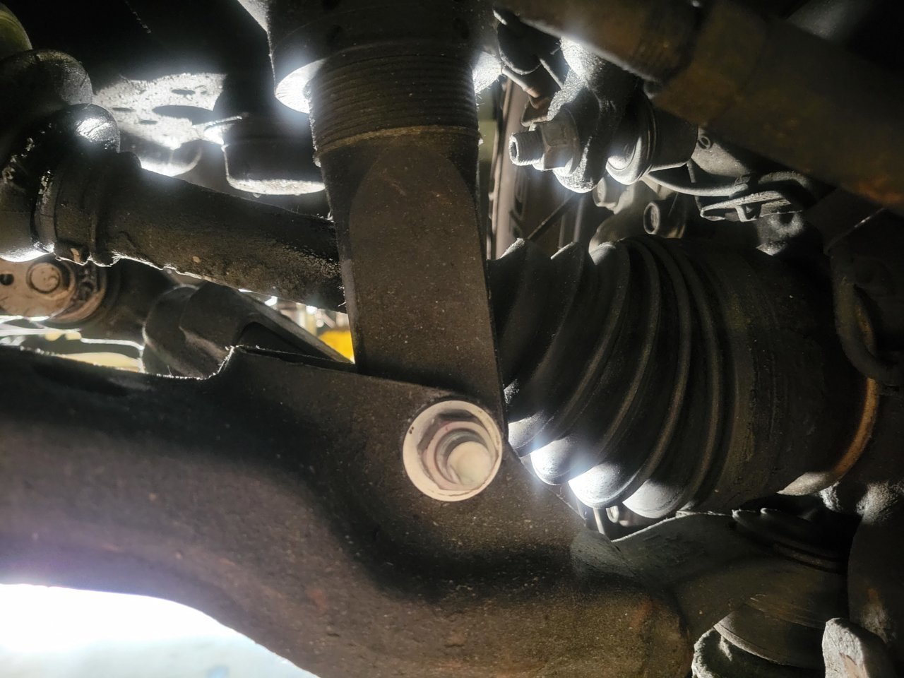

    I am really glad threads like this pop up, as my truck's front end started to make a clicking sound over small bumps at low speeds, and I thought it was something in the steering, as I could feel it slightly in the steering wheel.

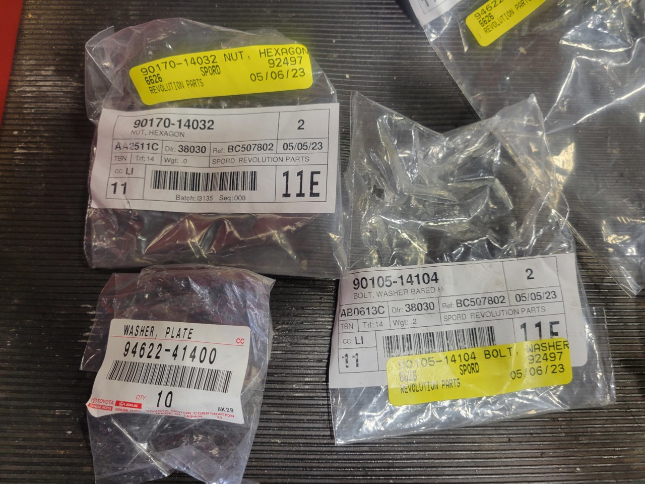

    Anyway, I found Toyota already makes the bolt to correct this problem on our trucks, we just have to look in the 5th gen 4Runner parts catalog! Here are the part numbers that I bought (if you want, you do not have to buy new washers and nuts, the ones from your truck will work as well):
    The bolts are the same thread and pitch (M14x1.5) and total length is a little over 70mm long (I measured with my calipers around 72mm). They also have the full 14mm diameter shank like the aftermarket bolts as well (unlike our factory bolts).
    Here is a picture of them installed:
    I am quite happy buying them, as the noise over small bumps is now gone, and the bolts/nuts head size match the originals (19mm), so no need to find different size sockets to remove them!

    Great find especially since the bolts from belmetric are out of stock and we can reuse our nut/washer thanks

    Damnit! I wish I had gotten these instead due to the bolt sizes being the same as stock. How much were they?

    I paid a little over $25 with shipping (a little over $15 for the hardware, but tax and shipping suck)
    from a local dealer (they have no way to pick up, so I had to get them shipped, even though they are about 25 minutes away from me!).
    Nope, he has the right part number, but when I was researching prices online, some dealers listed them like they are cam bolts, but they are not, just a flanged bolt. Here is picture of the bolt from partsouq.com:
