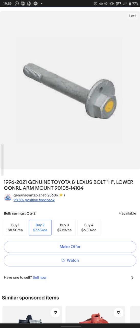

    Order for a pair of bolts have been placed. Cheers!

    Planning on making the order,
    I do hope it turns out to be the right part.
    Part number is correct but the image and description is wrong.

    Thankfully I used a 2 post lift at my work, and transmission jack to support the wheel/tire/suspension while I removed the bolt, but even changing it out at home with jacks/jack stands shouldn't be too hard.
    That has to be the right bolt, I thought the actual cam bolts were alot more expensive?

    OMFG i have been chasing this click for YEARS on my truck (2nd gen)..... If this solves I ow you and tonered a beer!
    EDIT - how long is the shank length? (guess i could get my calipers out and measure the LCA....)

    Just buy the oem 4 runner one mentioned a few threads prior to this. That is the best option. Same fit and finish and you can re-use the nut and washer.

    The length of the shank is between 35 and 40mm (I just measured it using pictures online and it should be around 38mm), I didn't measure it before installing the new bolts, as I just measured the total length (shank and threads) to make sure the bolt was not going to be too short.

    My bolts should be here on Wednesday I’ll take the time to do the side to side comparison.
    Edit: to be clear I ordered the 4runner bolts.

    As far as the bolt specs, they are rated the same, only difference is the head bolt size being 1mm smaller and I believe the Belmetric has the better finish(protective coating?)

    Overall…totally flying sky high on this mod. The truck feels like a “new” truck again. I have to find a reason to drive it now.
    I couldn’t stand it sometimes. And…the shame that comes with it!!! I hated rolling into large parking lots…6:30 in the mo’ning…I see the speed bump…say a quick prayer…and “click” causing everyone nearby to look :anonymous: Not cool.

    There's never an easy mod. This is the exception. Like, 10min for me.
    Jack it and pull the wheel. Pull the nuts. Use a screwdriver between the LCA and and coilover to relieve any remaining preload. Push a new bolt through front to back. And, push a new bolt through back to front.
    Torque the nuts on the ground.

    the stock nuts and washers are the same size? So one would only need the 4runner bolts to do this mod?

    Yes.
