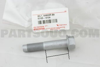

    Does anyone have the 4 runner bolts off the truck and can measure the length of the untreaded area? To do this right, youd need right at 47mm of unthreaded shoulder/shank as thats the outer width of the tabs on the LCA. This would make it so everything is fully supported by a full width diameter and not on threads then you could double up on a washer on the nut side if the shank was too long to get proper clamping.
    I wonder if there is enough wiggle room to use a 9/16ths bolt (14.3mm) for a real nice n tight fit.

    PERFECT! if you could measure the length of 14mm unthreaded section that would be amazing (right before it tapers back down to the threads).
    You da man!

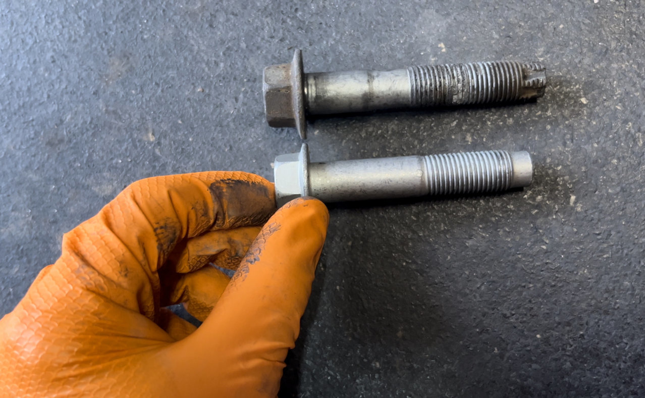

  17. May 17, 2023 at 5:43 PM
    #97
    Ricardo13x
    Ricardo13x YT: @UrbanOpsOffRoad IG: @urban.ops.offroad
    Feb 9, 2020
    #318785
    2,893
    Upland, CA.
    05 OR DCSB ProRunner(4x4 conv.), Chevy 63”s, NWF EcoCrawler, 35”s
    Random stuff. Oh! and converted to non ADD 4x4.
    nickonfire700 and Rainoffire like this.
  18. May 17, 2023 at 7:03 PM
    #98
    Ricardo13x
    Feb 9, 2020
    #318785
    2,893
    Upland, CA.
    Topanga Taco[OP] and nd4spdbh like this.

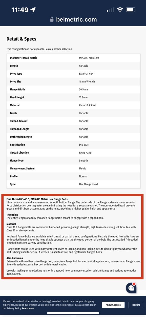

  19. May 17, 2023 at 7:09 PM
    #99
    BLtheP
    BLtheP Constantly Tinkering Member
    Apr 5, 2022
    #394355
    4,518
    Plano, TX
    2021 MGM TRD On-Road DCSB MT
    RC60F Transmission ADD delete with FJ full-time tube FJ Metal Clutch Pedal OEM Mexico-Spec Condenser Fan 265/70R16 Michelin Defender LTX M/S 2 OEM 1-Piece Lug Nuts Custom Built Switch Panel for all Electrical Accessories Rigid Amber Pro D-SS Ditch Lights Rigid 30" SAE High Beam Driving Light Bar Rigid SR-Q Pro Back-Up Light Kit (Recessed) VLEDS Tail Conversion VLEDS Foot Well Light Kit KC HiLites Cyclone V2 Under Hood Lights Operable (Switched) Clutch Safety Bypass
    Picked up mine today and installed them in like 15 min. Seems fixed, I did still get some noise on one really hard bump but could have been something else. The clink I get on speed bumps appears to be gone. Will update when I have driven more!
    Understood this thread was about the Bellmetric bolts, but I prefer to stick to a factory part when possible just because. Good thread.
