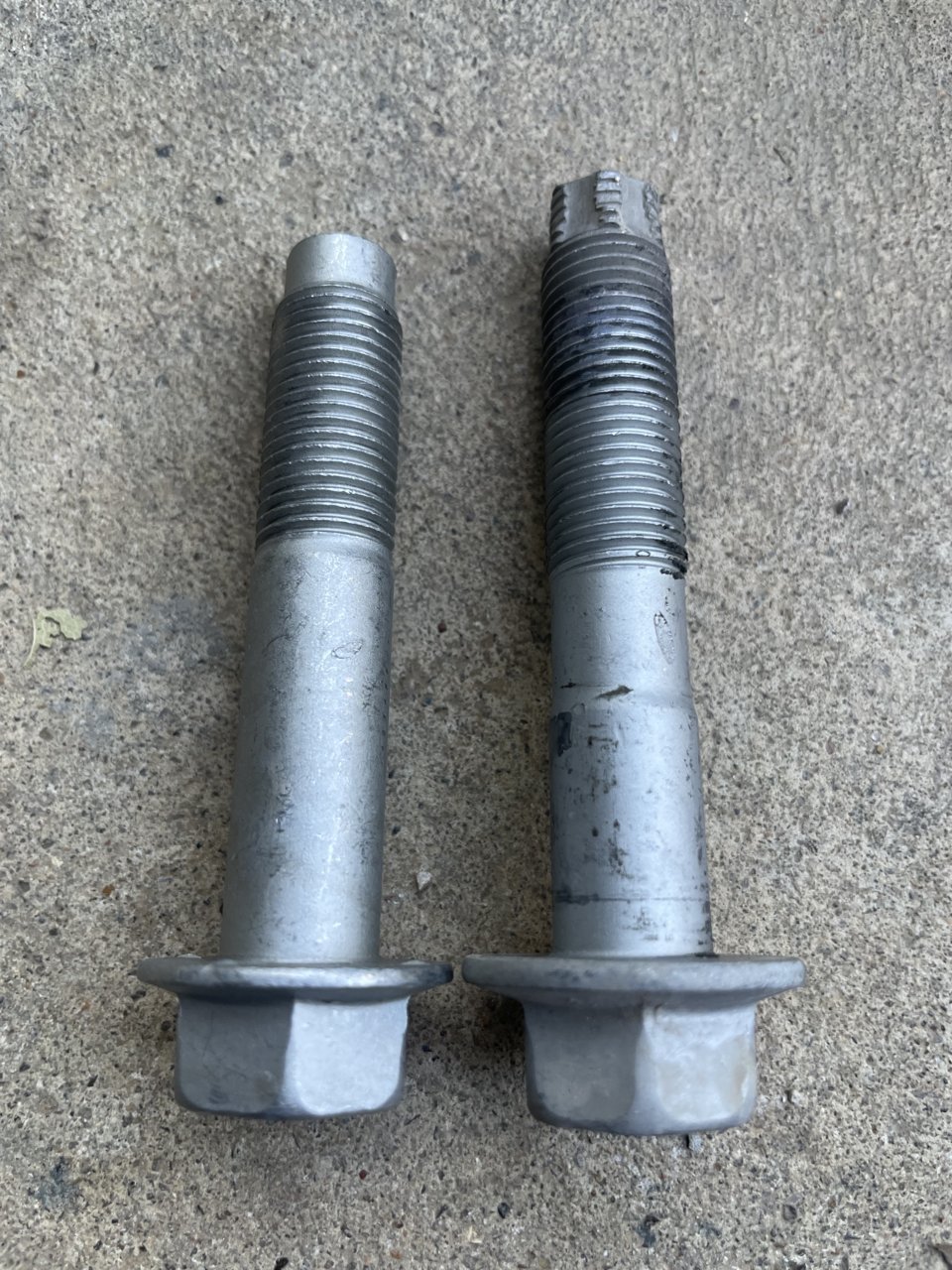

    The point was not the bolt. The point was THEE fix for this annoying sound.
    If you feel better with the OEM bolt, so be it. I prefer the better finish!

    Interesting, only ~ 36mm of unthreaded full width shank when ~ 47mm is really needed so that the one tab on the nut side of the LCA isnt hitting threads. Thanks a BUNCH for the pics! This helps me in my decision.
    I might try to find something on McMaster-Carr that will fully support both tabs of the LCA and shock bushing via an unthreaded section but not allow the nut to run out of thread before full clamping.

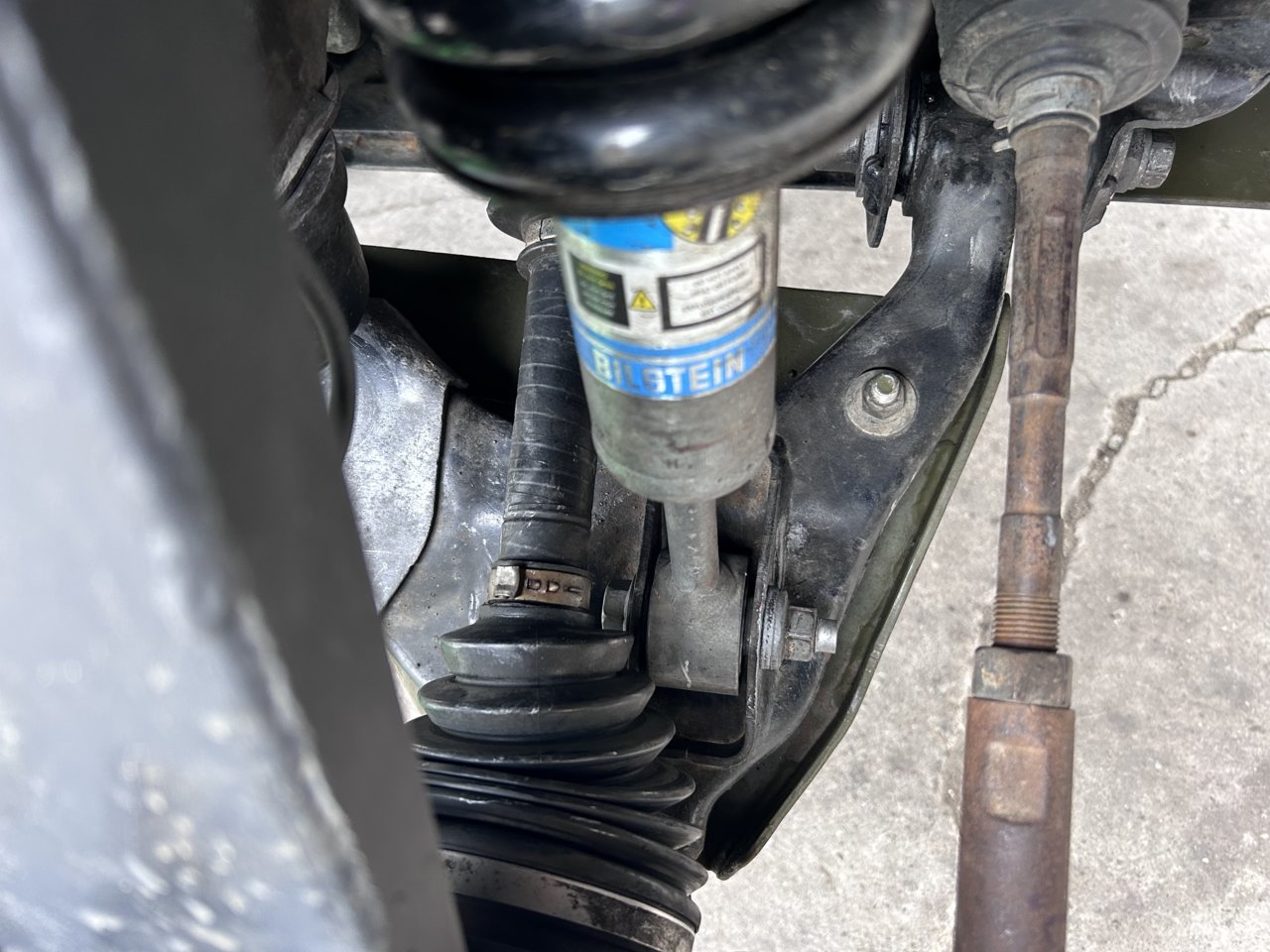

    After a test drive the major clunk seems to be gone. I torqued the bolts and as well the cam bolts of the LCA’s. So my personal recommendation is, check if your LCA’s are torqued first, then do a test drive and listen if the conditions change, then replace the bolts for the shock. Torque on while truck sitting on its weight, and finally test drive again. Cheers!

    And this is how they look installed.

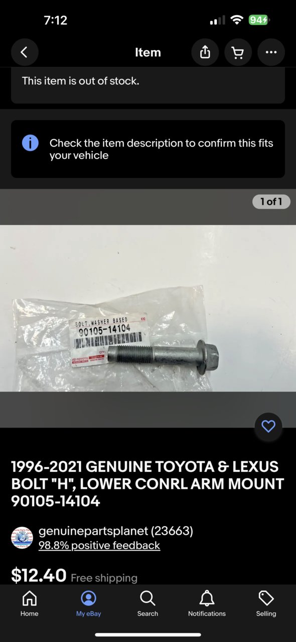

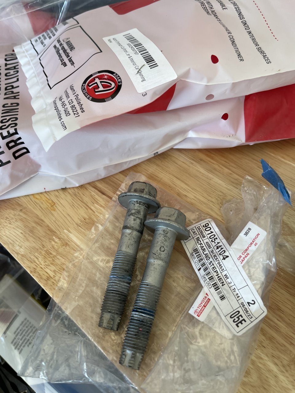

    I just swapped out the OEM Tacoma bolts for the 4R bolts, #90105-14104 from eBay. I have Bilstein 8112 coil-overs for the last few years and the front of the truck has always had odd clicks, even with the OEM Yellow Bilsteins that I thought were coming from body or radiator mounts. Nope!
    Took longer to raise the truck and remove the wheels!
    DO IT!
