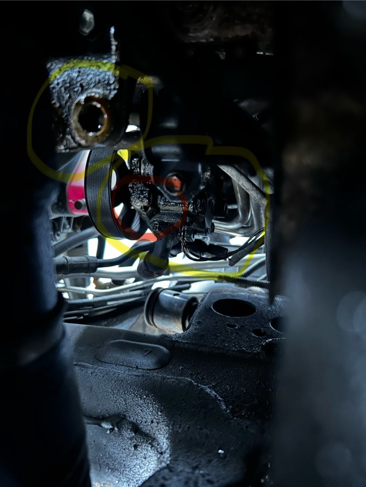

    My Toyota dealer service said my 2016 TRD Off-road has this timing cover gasket leak (on right) as well as power steering rack leak (on left). I had another shop verify the steering rack problem and they replace the rack. Then a couple of weeks later replaced power steering pump. So this shop were working in the area twice and did not report a timing cover gasket leak. I wondering if the dealer misdiagnosed the timing cover leak...

    So is this other way to fix less expensive? Toyota is quoting $4475.

    no same cost, it still sucks to do. Less risk with the engine in

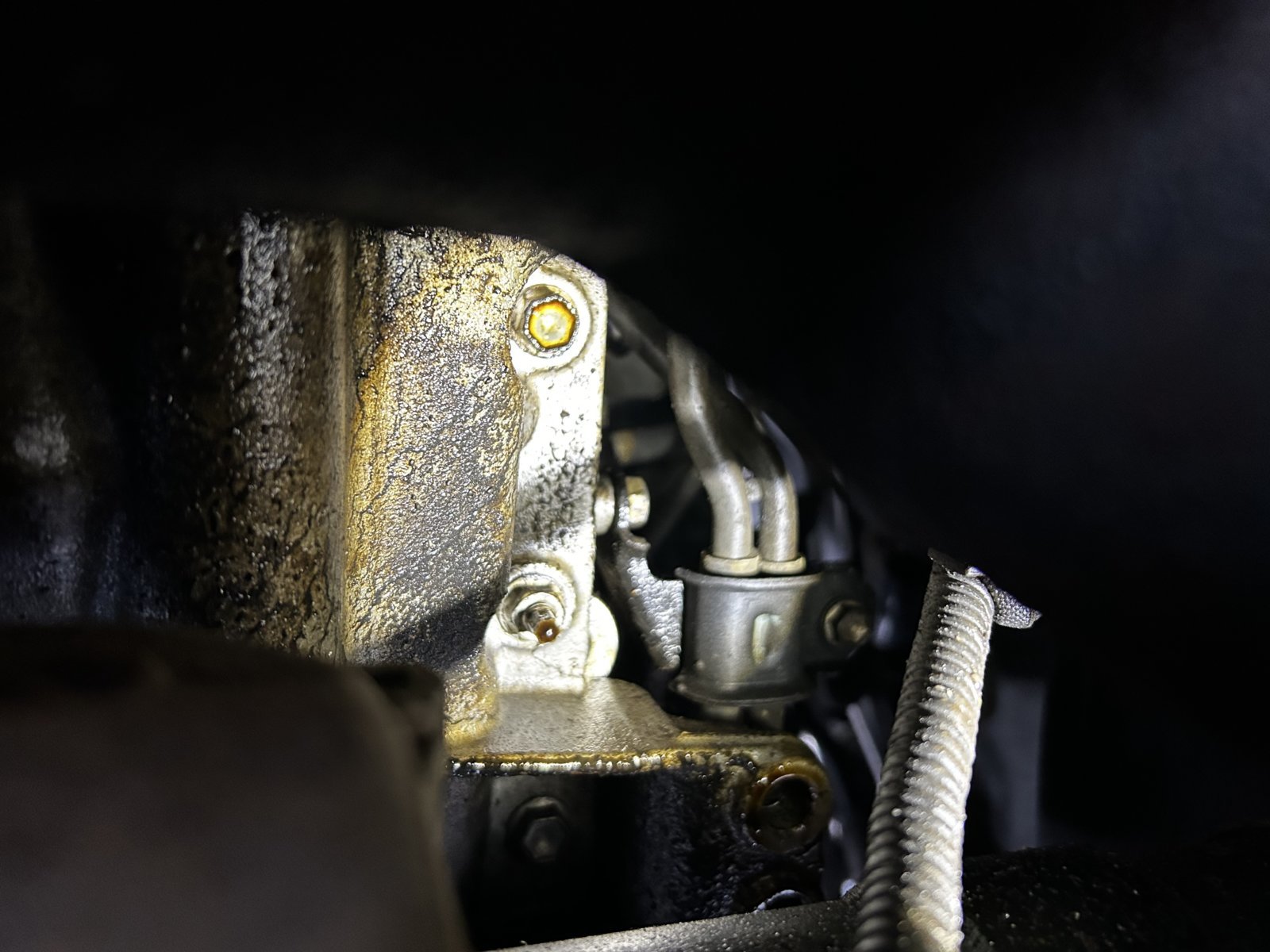

    I have an oil seepage as well. At first glance I thought it was my power steering pump because I was a bit low. When I looked around some more with the light it looks like what others are finding, the timing cover leak. I have 145k, and bought the truck at 80k. I have never been low on oil, and I've been doing the maintenance on my own. I really noticed it while I was changing my oil and had the skid plate off this past week. I'm out of warranty for sure, and uncertain what to think of this. It's been pretty reliable for me, and my family has had Toyotas all my life with some reaching 400k. Also, I drive the crap out of it.

    I think if it's not affecting the level in between oil changes, I'd just leave it and keep an eye on it. Periodically clean it.
