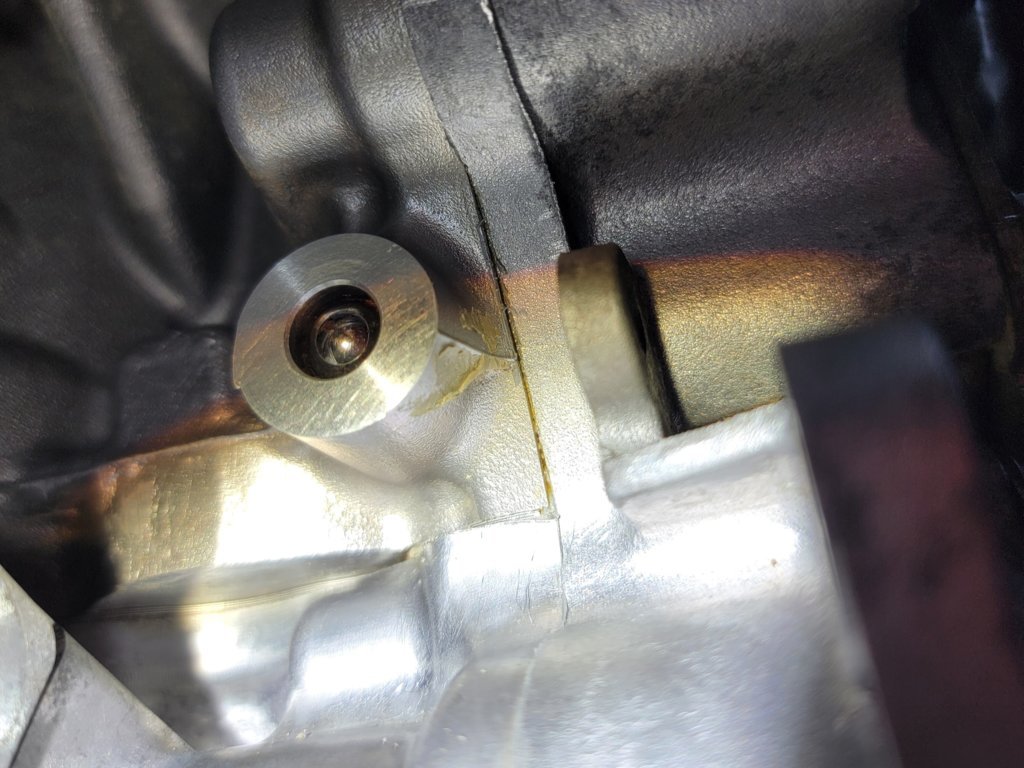

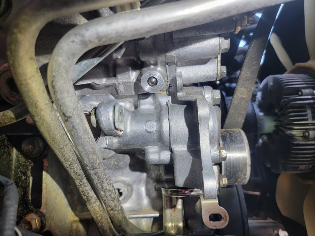

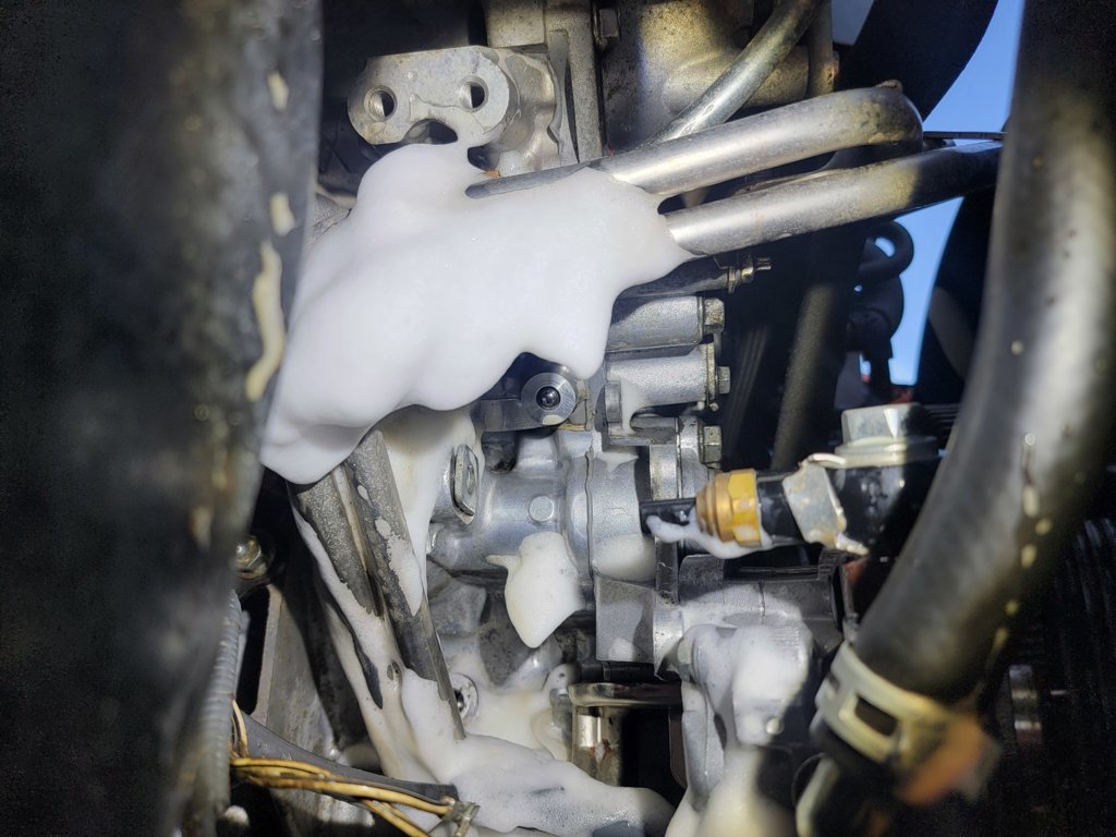

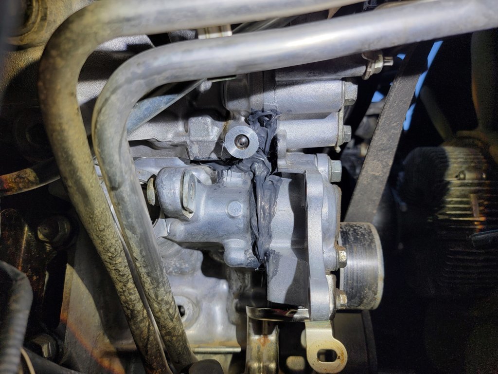

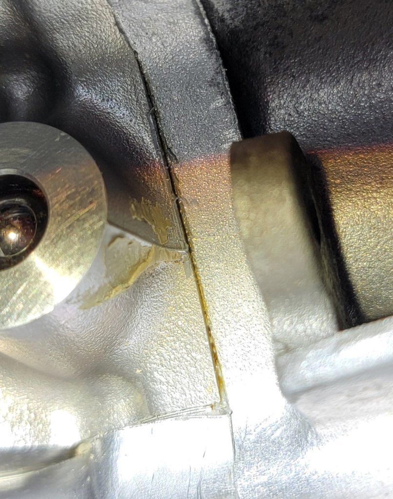

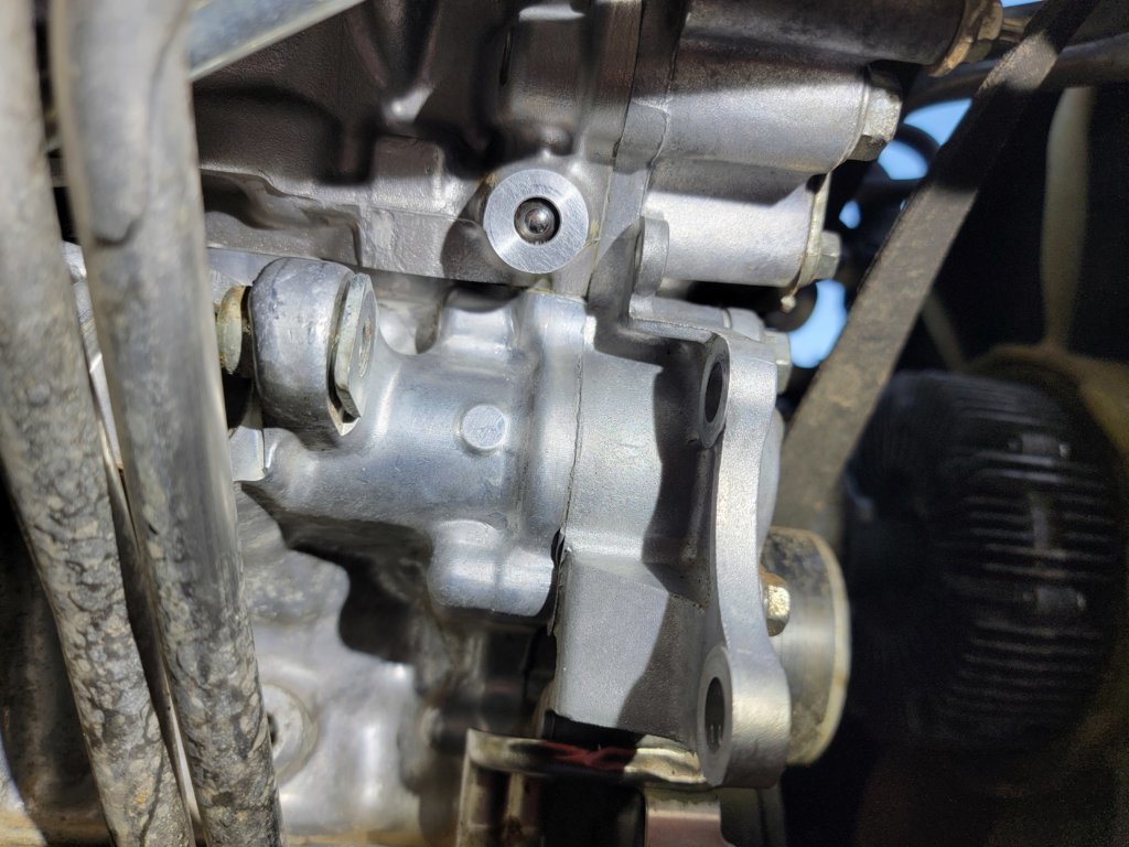

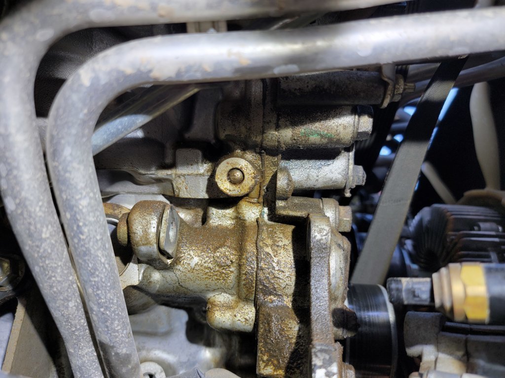

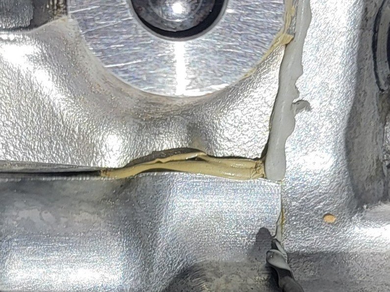

    Tackled the diy exterior seal job earlier. Figured I'd share here. Bought my 3rd gen last August with 42k and it recently developed this leak at ~47k. Been putting it off for a bit. Was actually really simple to do tho. Took some somewhat detailed pics of where I discovered the leak was coming from. Thought it was on the underside where the factory rtv was discolored brownish, but it was actually the exact spot where it should be, i discovered, when I scraped off the rtv and saw the tiny gap and holes where it was seeping out of. Should also note that I initially put in some uv dye when i first saw the mess around the ps pump, to be sure it was this and not something/somewhere else...
    Some tips if anyone tackles this:
    I found it was easiest to come in from the passenger side wheel well. I already had the splash guards off so that made it easy access to the pump after wheel is removed. Loosened the serpentine belt via tensioner up top, unbolted pump via wheel well access(2 bolts in front, and the ground(?) wire bolt and sensor clip on backside), moved her to the side and viola, ready for cleaning.. Used a whole can of foamy engine degreaser, occasionally spraying it as well as using a plastic bristle brush in between coats, then a can of brake cleaner to spray it all clean. Gooped some new rtv on and done. See how it holds up!
    :fingerscrossed::fingerscrossed:
    ^^^Where i thought it was leaking ^^^
    ^^^ old gasket material scraped off^^^
    ^vWhere its actually leaking in this seam^v

    Nice job! Great pics, way better job then removing the engine snd tearing it all apart and risking it leaking again. Even if this holds for 20k miles etc or a few years… could always just do it again. Me personally I bet it will never leak again. There have been other people who done this over the years and the leak never came back over long periods of miles and time

    @NightProwler This is exactly how I did my 2016 last year. Mine was leak free for about 7 months and started seeping again around then. Seems to be much slower than it was, so I still consider it a win. Might try it again sometime, but I am not losing much oil and just wipe it once a week.

    Any problems getting your PS pump back on with that amount of sealant?
    I've worked on my leak twice now and not been able to make much of an improvement. On the second attempt I used too much sealant and had difficulty reinstalling the pump, so I had to remove most of the sealant to get the PS to seat.
    I plan on tackling this job again soon, hopefully 3rd time is a charm!

    Damn, that is a shit ton of sealant. Wouldn't a thinner application suffice?
