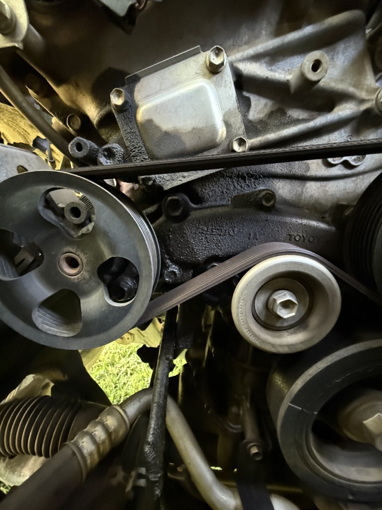

  17. Apr 17, 2025 at 7:26 PM
    #137
    Tcoma16
    Tcoma16 Galatians 2:20
    May 18, 2016
    #187347
    1,245
    California
    2016 TRD Sport
    I assume I have been blessed with the infamous timing chain cover leak?
    BabyBilly likes this.
  18. Apr 17, 2025 at 7:30 PM
    #138
    Vlady
    Vlady Well-Known Member
    Dec 20, 2017
    #238986
    4,619
    Issy, WA
    2017 White SR5 DCSB V6 4x4
    Well, depends.
    This is the timing chain tensioner acces cover. It leaks/seeps on every Toyota I've owned.
    Clean it , tigh those 4 bolts a bit and monitor.
    Actual leak is on the side, just above the pump
  19. Apr 17, 2025 at 8:02 PM
    #139
    Tcoma16
    May 18, 2016
    #187347
    1,245
    California
    2016 TRD Sport
    Aw, sounds good. Thank you!
