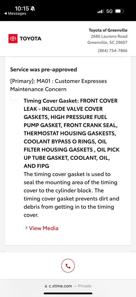

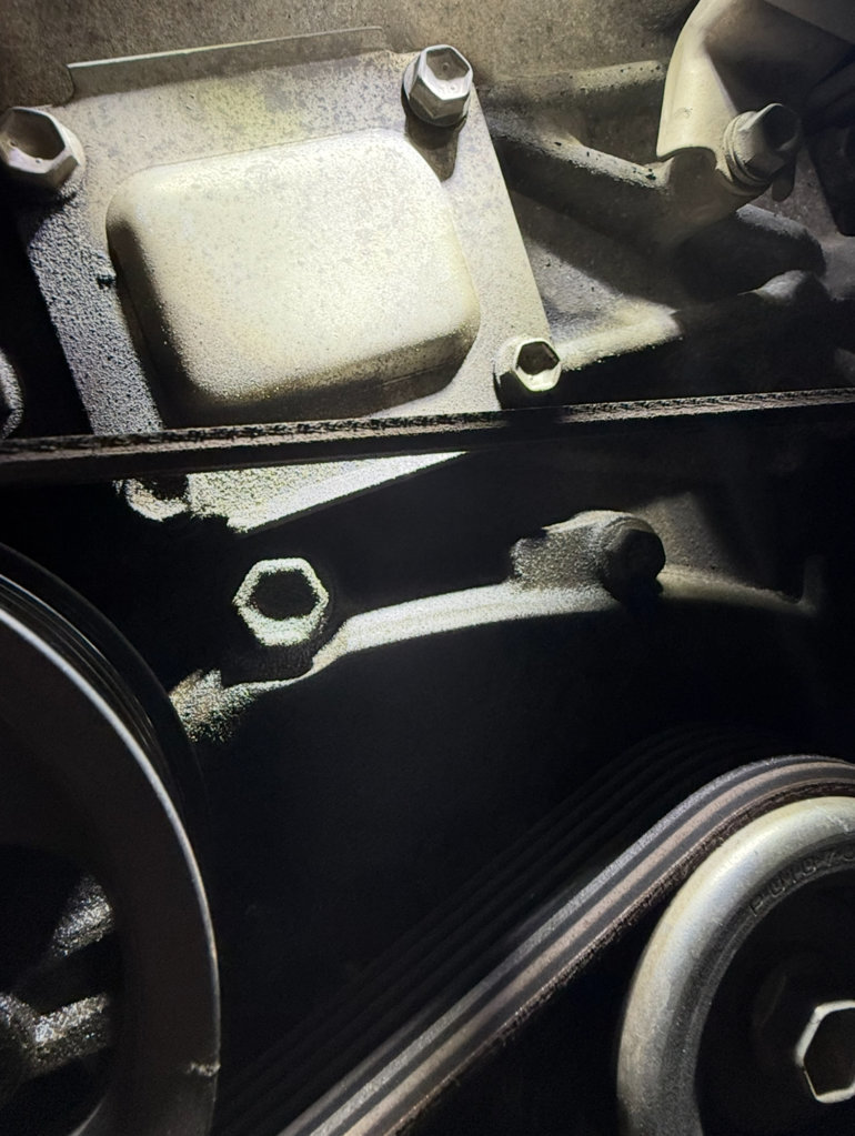

    Add another one to the list. Going to the dealer tomorrow for a warranty inspection. 2 months left on my powertrain warranty so
    I'm glad I noticed this while changing the oil over the weekend.

    Toyota made this one easy for me at least. Dropped off this morning and was approved for warranty repair an hour later.
