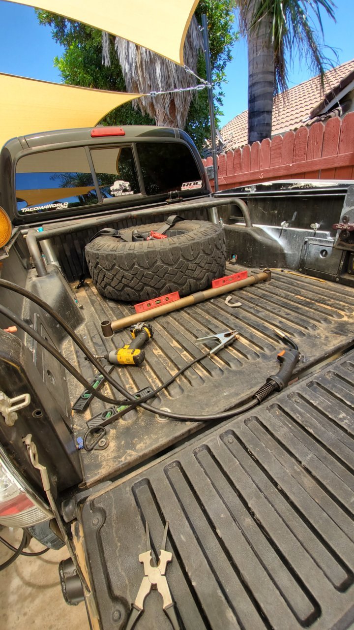

    I need some tube so I can burn a crossmember to attach a y strap and put my spare in the bed like you have it. The spare location is cool but it does act like a bump pad on inclines lol

    Made mine out of 1.75in. IMS always have remnants

    The bed bolt washers fit the ID of the tube?

    Negative, I took those off. I welded a round plate to the bottom of the tube then drilled to fit the bolt through. 20200718_131738.jpg
