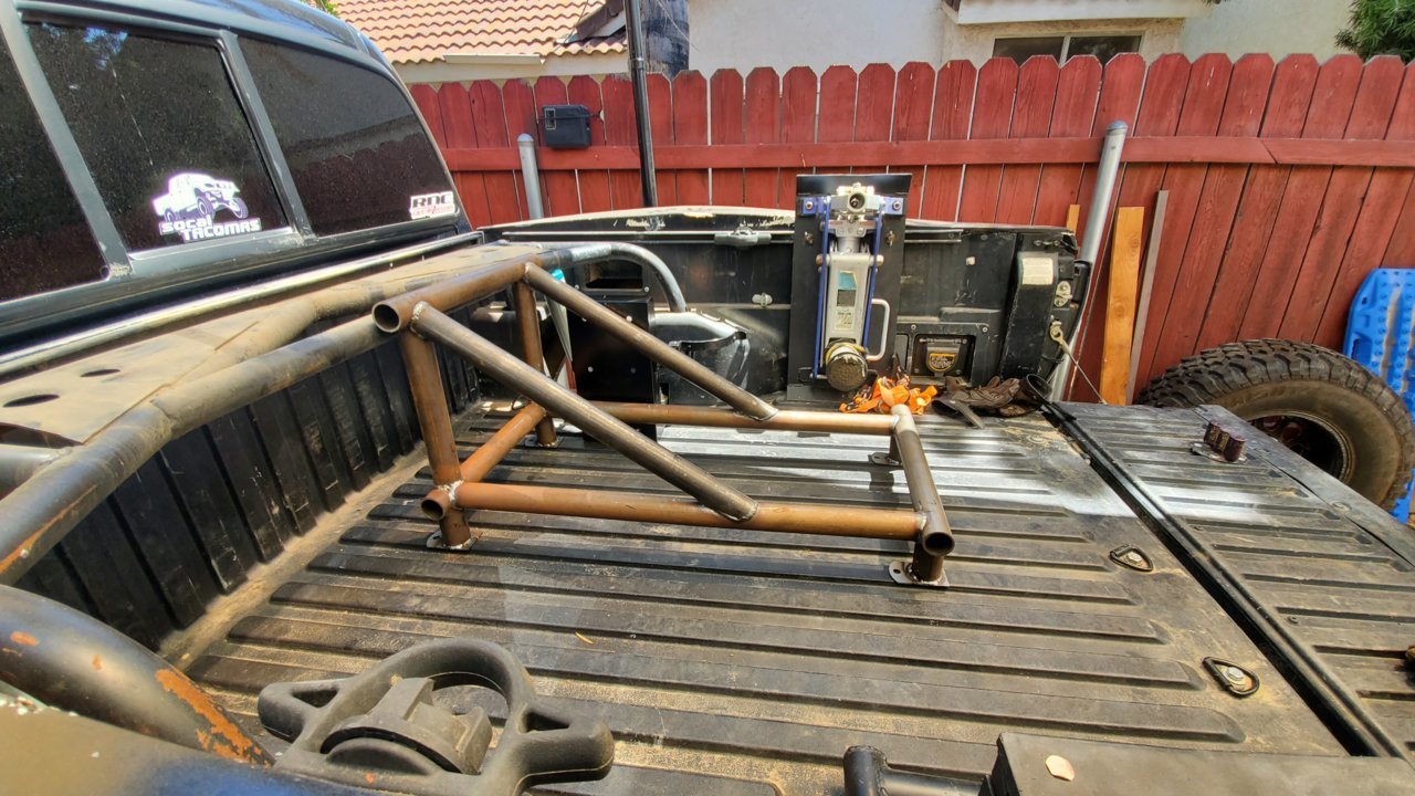

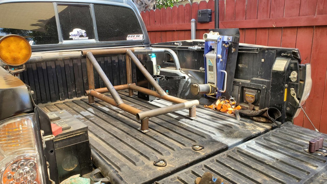

    This one is almost finished.
    I'm looking for a 31/33 inch tire I can borrow.
    I'll be making one for that tire size.

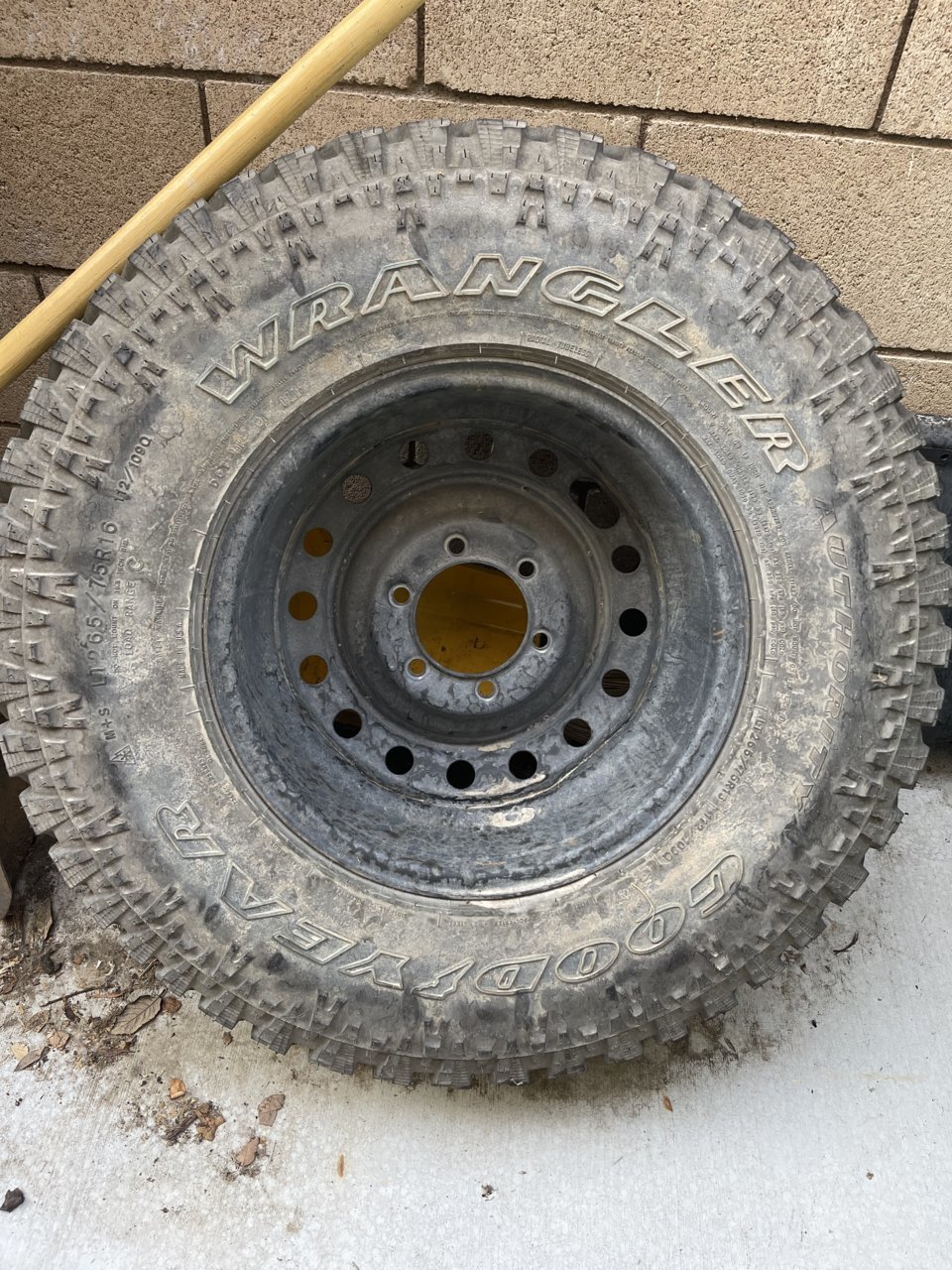

    I think I have a 33 you can borrow

    It’s a 265/75 C11F7086-E0AC-483C-89F8-4DED444073C3.jpg

    That'd work. Stock size.

    I'm only doing tire carrier.

    looks good Oscar!

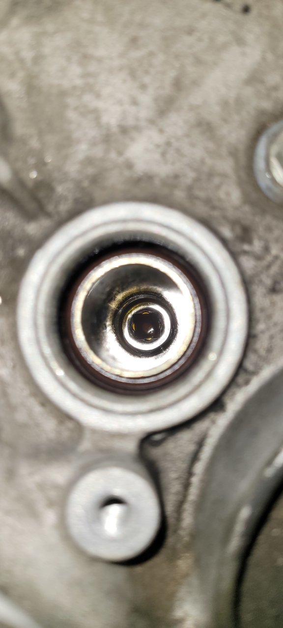

    Well fml......
    Any MacGyver here?
    Went to change the plugs on the race car (09 corolla)
    Grabbed my standard 5/8 spark plug socket lined it up in the spark splug cylinder. It was a tight fit but it slide down on the plug so I thought it's good. Went to wrench it out starting spinning then it got tight and I'm like great.
    Well now that damn thing is wedged so damn tight and it's stuck.
    Tried prying tools. Jb welded extension. Pb blaster. And it ain't budging. Next step is to remove the valve cover but it won't give me much extra room
    Corolla decided to use a 9/16 socket for plugs the one I used was the standard 5/8

    Compress air?
    Drill it off/out?
    Impact gun?

    My impact doesn't even want to turn it anymore oof.
    Drilling may be my last resort. If I can manage to get something strong enough to hold that socket, trapeze and winch line that thing out

    How long did you let the jb weld sit ? When I changed mine on my 10 Corolla I used gold heat wrap tape on the extension to pull it out

    You can try a torch to melt the rubber sleeve inside as well , but you will have to also change the vc gasket but you might be doing that anyways
