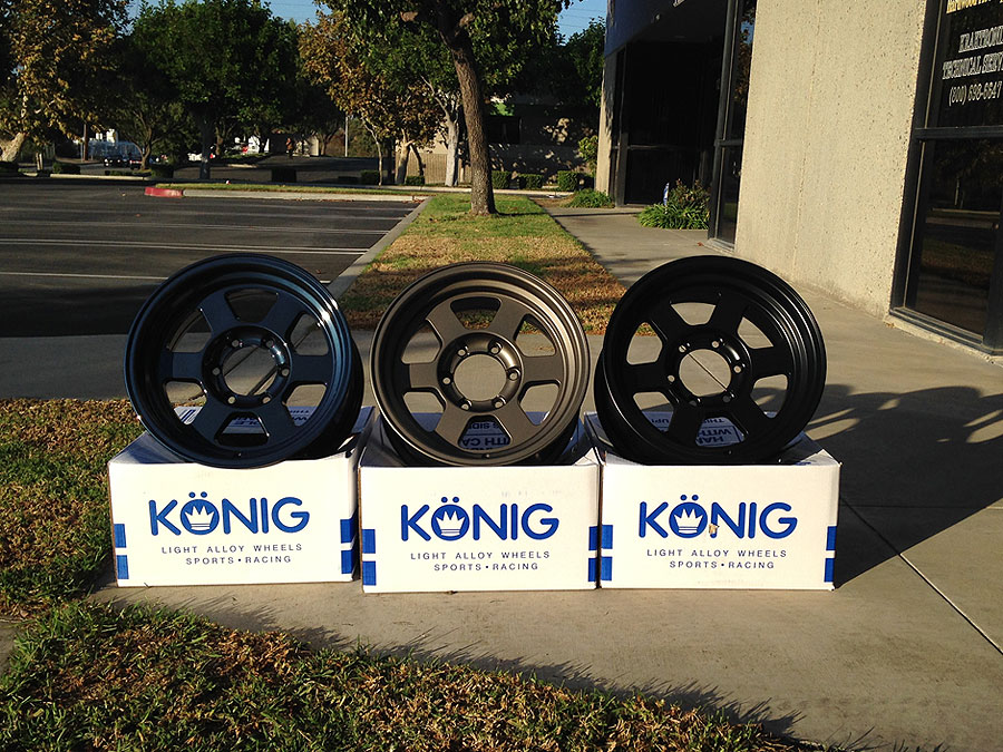

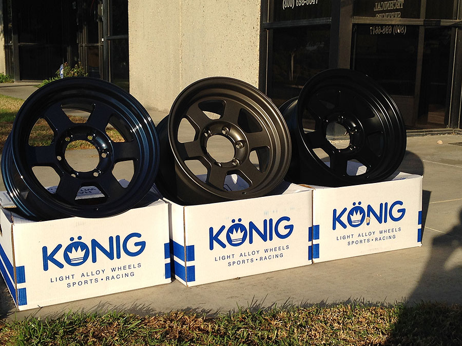

    Well fuck, the wheels I wanted are sold out and no restock for quite some time...
    I can get these in 16x8", -20mm off set...3.75" BS...what color? Matte Black or Matte Bronze?...really wanted the dark blue but they are only available w/0 offset.

    You want 16s right not stepping up to 17s

    Personally I'd go blue then a 1.25" spacer should be perfect to clear 2.5s and not look crazy where the -20 you'd be looking at a 1" or .75" spacer. Which you're limited in your choices of them

    Yeah, keeping with 16's...gotta keep my same tires for now.

    I think that might end up being too much poke and have lots of trimming to do or issues hitting the firewall.
    End goal is to fit 35's. Lots of guys are using 3.5BS wheels (F5's) and not having a lot of clearance problems.

    To fit 2.5s in the rear you need 3 or less of BS which is what I was talking about the spacers I gave would get the blue or the other 2 in that range.

    What’s the specs on your wheels? That’ll give me an idea on how much poke there might be with what you’re saying.

    I've got 17x9 -12 offset with 1.5" spacers so an effective -50 mm or ~3" BS so with an 8" wheel you'll have less poke than me
