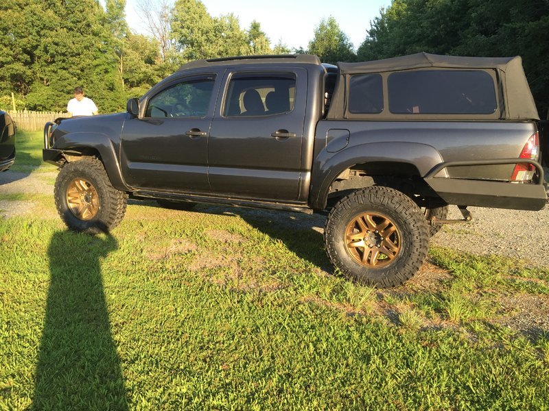

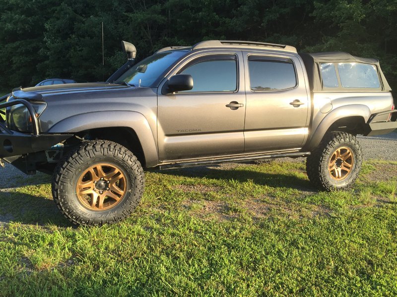

    Doing a little research I was able to utilize my 17" TRD Sport wheels (17x7.5+30) coupled w/ 1" spacers to achieve around a +4 offset. This resulted in an additional 11/16" clearance between sidewall and suspension when compared with the original 265/65r17 tires installed on the truck. We trimmed plastic, CMC'd and flattened the pinch weld. These were done to such a degree to accommodate future plans if so desired. However, this may not be the case for those considering this route due to a plethora of variables that would come into play. Furthermore, I am currently at the mercy of stock gearing, BUT that's not to say that I've noticed a dramatic change in performance. Yes, there is a considerable amount of increased rotating mass and yes, the rev/mile have decreased per the increased diameter of the tire when compared to the previous size installed. I took the liberty of reaching out to ECGS to determine what would be the ideal ratio when paired with these tires and it seems to be a 4.88. But, I believe to a certain degree end-user preference comes into play which is an entirely different bag of snakes. So, my my short n' dirty $0.02 is this, you're probably fine with stock gearing (like me :wave:) for the time being without going balls to the wall buckaroo bansai on the trails. Once the opportunity presents itself though, I'd say 4.56 if you're primarily highway (+65mph) and 4.88 if you're a 50/50 split. Overall, time will tell as things are dialed in.
