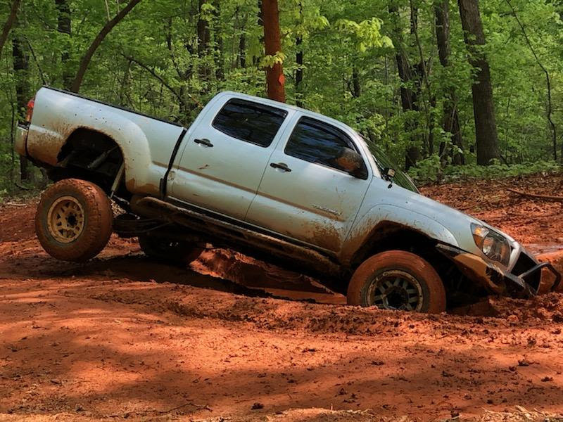

    I am really pleased with the results although there is some room for more droop, already planning some tweaks for that. Bump is perfect. Spring flat there is 1" of shock shaft left and the wheel isn't completely tucked in the wheel well unlike before which is good gives me a little more ground clearance. Droop I'm missing 2-3" possibly. But the rear tire gets out of the wheel well a good 3" which is amazing. about 6" lower than before easy. In the areas that didn't change as much I kept my tires on the ground where before I would hang one in the air made the truck more stable. Climbs the flex helped a lot keeping the wheels planted and moving. There was one drop that James and Brian were hanging a tire and both mine were still planted hard where theirs were off the ground about 3-4". Oh and the longer springs made for a much smoother ride along with the kings.
    I am going to go out there in the middle of the week and flex her out and take my time more and actually get some really solid measurements. I think 16" and rotating the lower mount down but keeping the same amount of shaft at ride height will get me the droop I'm looking for but the shock might not of been completely extended I just gotta measure. If not then I'm getting some binding in the bushings or shackles that's preventing full droop.
    All in all I think I need to do some more testing and have some time where I am not rushed maybe have a second set of eyes there to double check everything I am measuring.
    Slashaar and Casper66[QUOTED] like this.

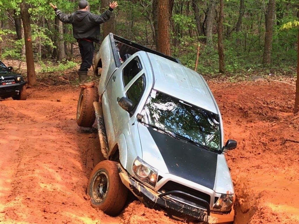

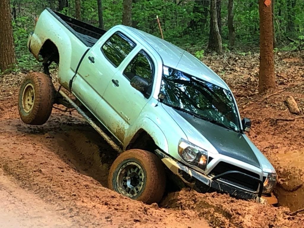

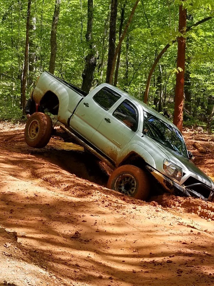

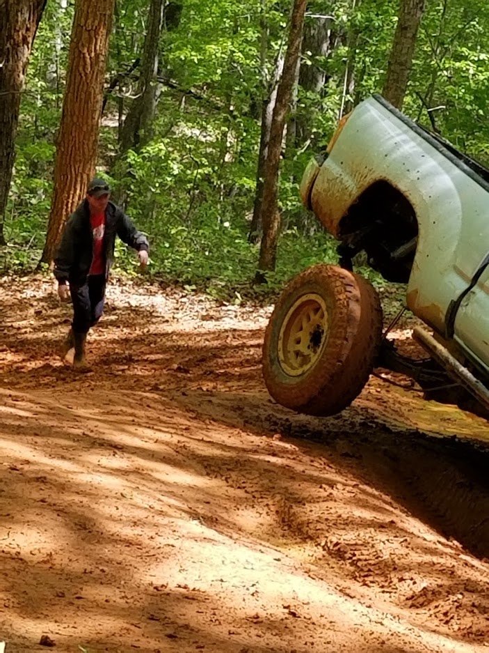

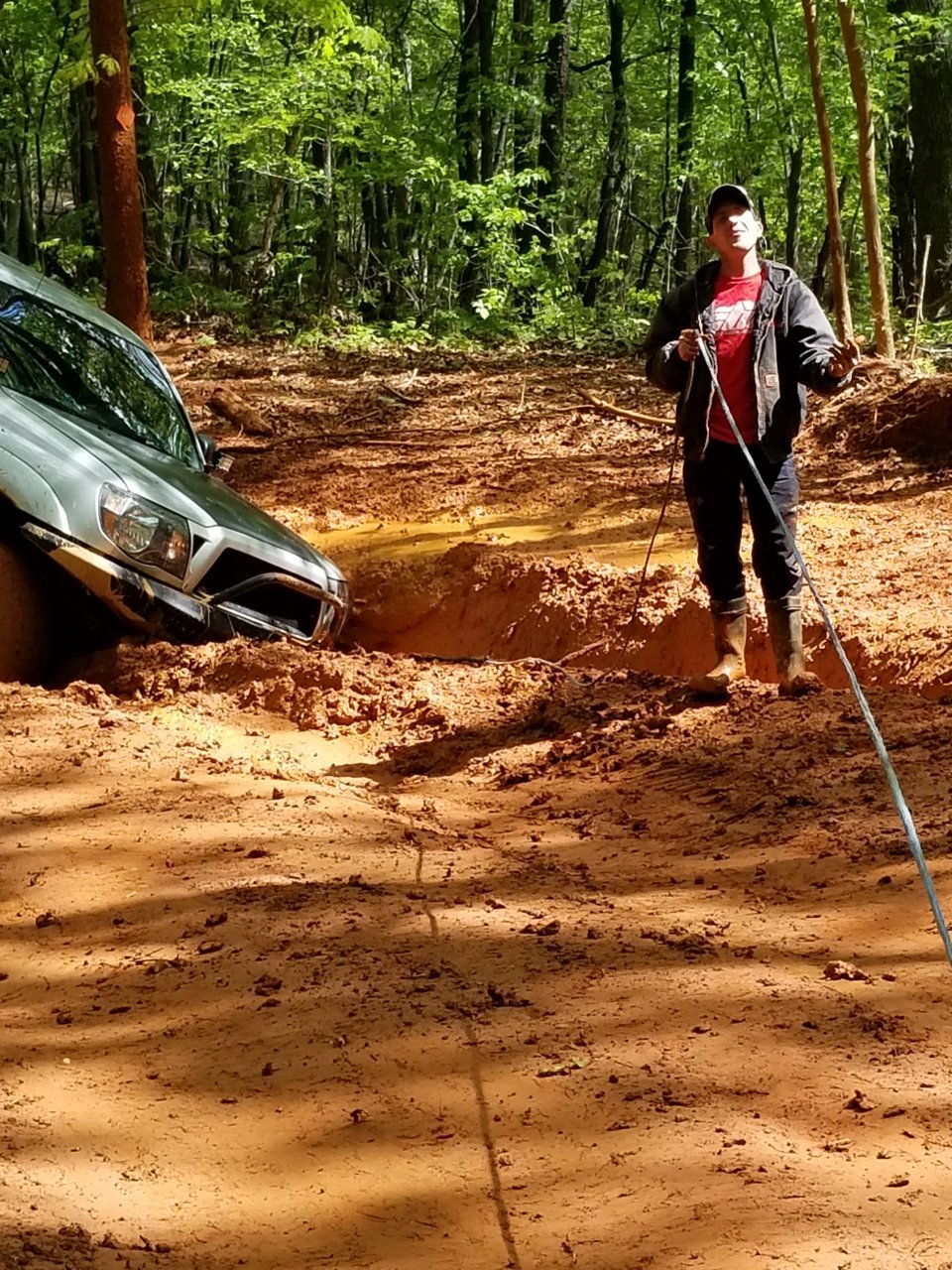

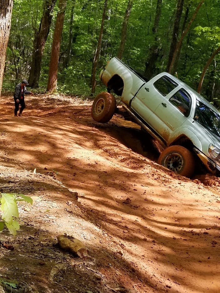

    More pics from today all that was take of me was the swan dive into the mud pit.

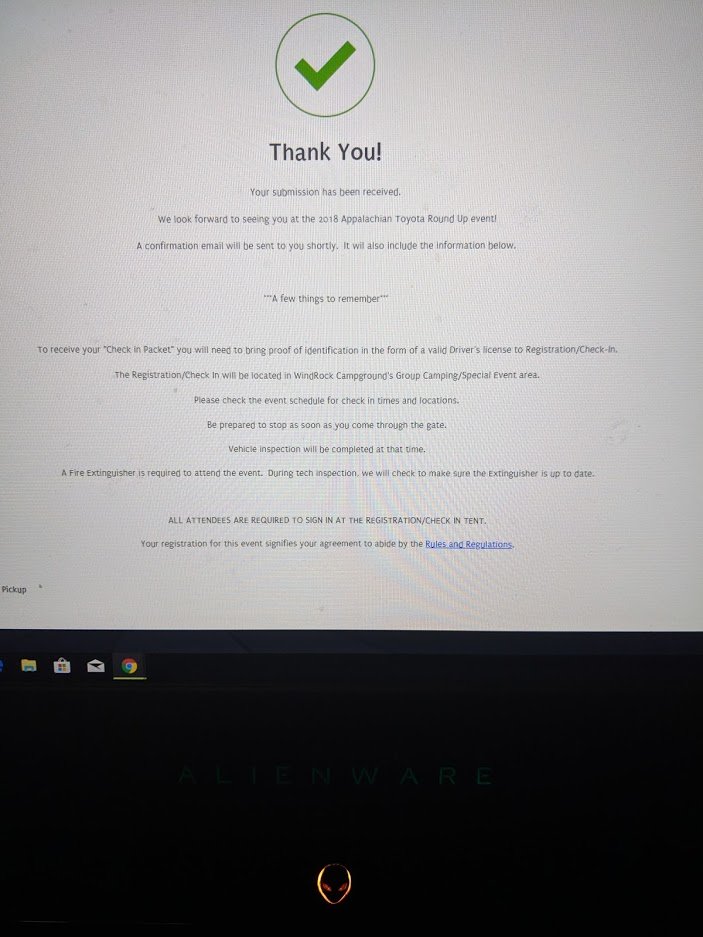

    Did a thing tonight ATR this yr.! But for whatever reason it is giving everyone a response of 2018!
