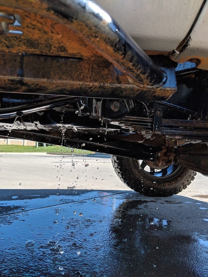

    So after taking my topper off I have not been impressed with the bed's ability to drain water accumulation well so I decided to remedy that. It's worked well so far may add a couple more holes to the back of the bed. I did this shortly after taking the topper off and been tweaking it ever since.
    Fist was to drill 2 more holes along the front of the bed the same size as the stock ones which made there 5 total holes that did ok still not completely satisfied. Then I drilled 2 1/2" holes in the back corners where my TC bed stiffeners are. Better but not great so then I enlarged the front holes all to 1/2" this works even better. Then I added another 1/2" hole in the center at the back even better. I enlarged the holes to 1/2" not only to allow the water to drain faster but these little acorns that fall in the bed just fall right through the holes and don't clog them up.
    The reason I have put holes in the back is I have a Rokblock tailgate gap seal that doesn't allow the water to run out through that gap. The nice thing about that is no debris falls in that crack and causes issues with opening the tailgate.
    Drainage results, not the best pic but it's pouring out pretty good after the car wash filled the bed with water.
