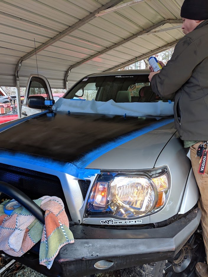

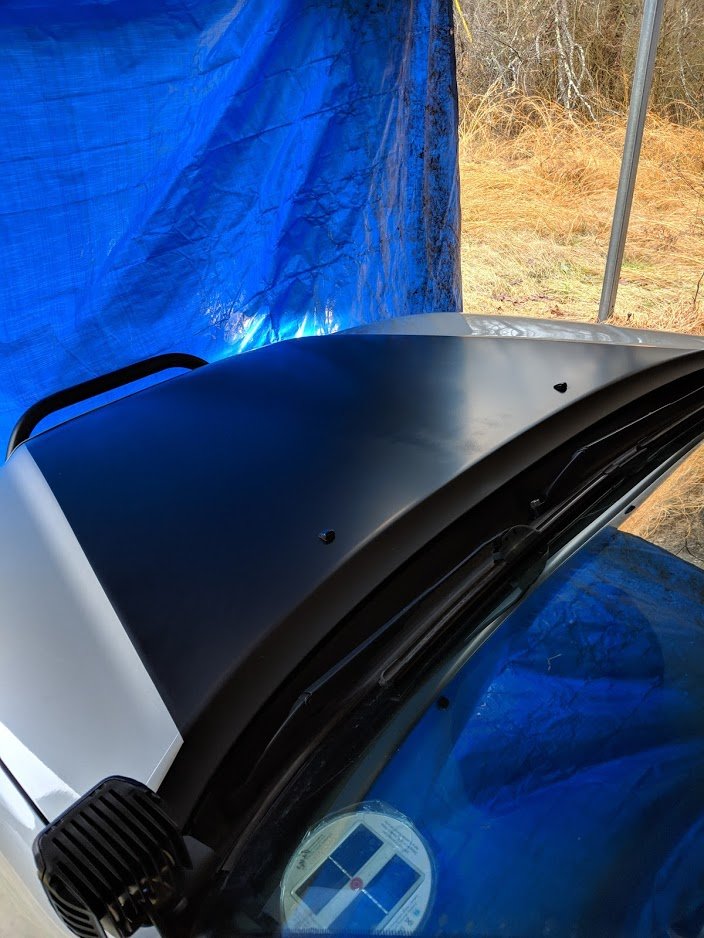

    Of course man, you should try to get a good pic to see the devil horns :devil:
    Glad that the cables were still good, I'll tinker with the old one and see if I can get it going but if not I'll have some spare parts.
    I really need to get my tie rods done now...

    Thanks brother, I know many hate derp but I'm a huge fan of how many things you can do with it. It's held up great for me on all my areas ( fender flares, two tone paint scheme, hood scoop, gas filler door, and my hood ) plus you can use it as a primer and top coat with what ever you want. Don't like it? Peel it off.

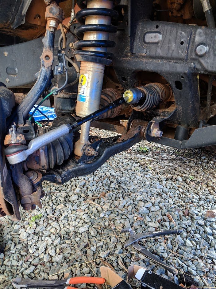

    Nice! I need to do my tie rods soon. Did you have to make a wrench for the inner ? What brand did you get? I have some moogs but a lot of people say they are not nearly as good as factory.

    I just got the upper level brand from Orielly's. I have used moog and other top level brands for decades as a mechanic IMO they work just as well. Now have I really tested them against the OE no. But a lot of people say the factory toyota oil filter is the best you can get well I've seen them cut apart and compared against others and they are not as good as a lot of aftermarket oil filters, just take that as you will.
    As far as the inner tie-rod wrench or tool, I own one but I did not use it. If you turn the wheel all the way to the side you are doing then you can use a pair of channel locks on the flats at the base to loosen and tighten them they aren't put on that tight. There is a little flat washer in between the tie rod and rack. Before you loosen it you'll have to bend the ears off the flats of the base of the tie rod. Then the new one should come with a new washer. There are 2 ears on the inner dia. those ears go in towards the rack as there are 2 relief cuts in the rack for them. After you tighten your inner up you knock the washer down around the flats of the base of the tie rod. Also count the # of turns it takes to get the outer off the inner this will get you really close alignment wise but you'll still need one after. Hope that helps
