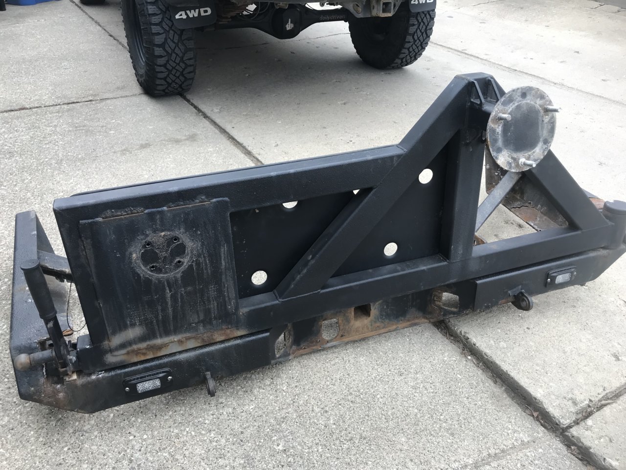

    Actually I have somewhat changed my opinion on lineX . Eddys guy that did my last bumper did an excellent job. Just be aware if you take a hard hit the linX is so tough it wont come off. It is possible that it gets a pinhole let's water in and starts rusting. LineX is really good at hiding imperfections which is a good and bad thing.

    That's kinda why I am a spray bomb kinda guy. I can keep an eye on everything. Not saying that the Line-x guy isn't good just that look isn't really me and for the reasons you stated.

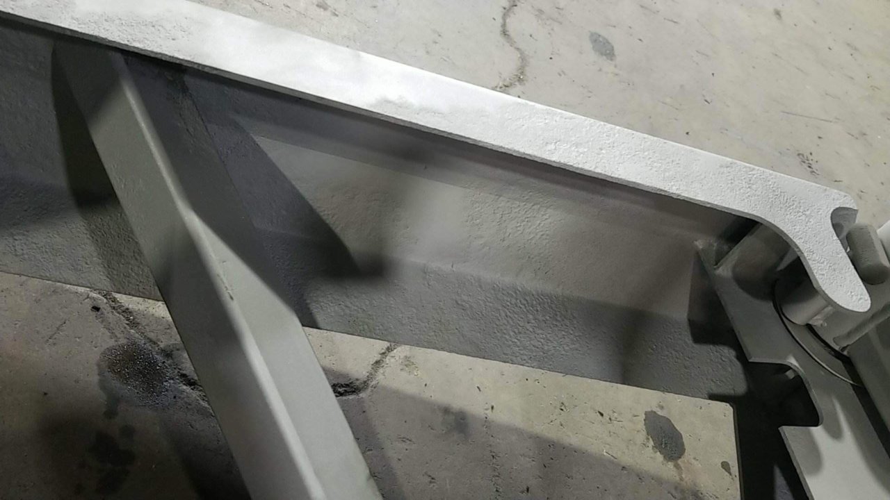

    My rear bumper was done in linex by the previous owner and it was flaky and rusting from the inside out
    It was so bad that the steel was pitted in certain spots

    O gawd dont post stuff like that now I'm going to be paranoid as shit that my trailer is slowly rusting away. Hopefully will be fine is was primed and rolled on plus it spends most of it's time in the garage.

    Midwest. Got it powdercoated so I should be good now.

    yeah I believe it. I wont be LineX anything, im just going to get my PC buddy to hook me up. if I ever wanted to modify or weld something onto the bumper it would be next to impossible with linex. and that shit holds in the moisture like crazy, if it does get in behind the linex ur dickered and will rot out the metal, and you wont even really know unless it happens to peel off or what ever hahaha could end up with just a linex bumper and no more steel hahaha
