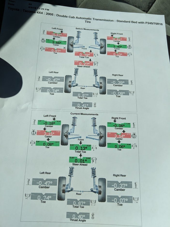

    First off found a shop to do an alignment the way I wanted it done and the guy did a good job. I am happy with the #s he got.
    czSgnzSFeYcculC7D6-03FXm47HMmJk-6Ut5uR-E_3f6979df47b9ac84bd7501cd874b266b93629873.jpg

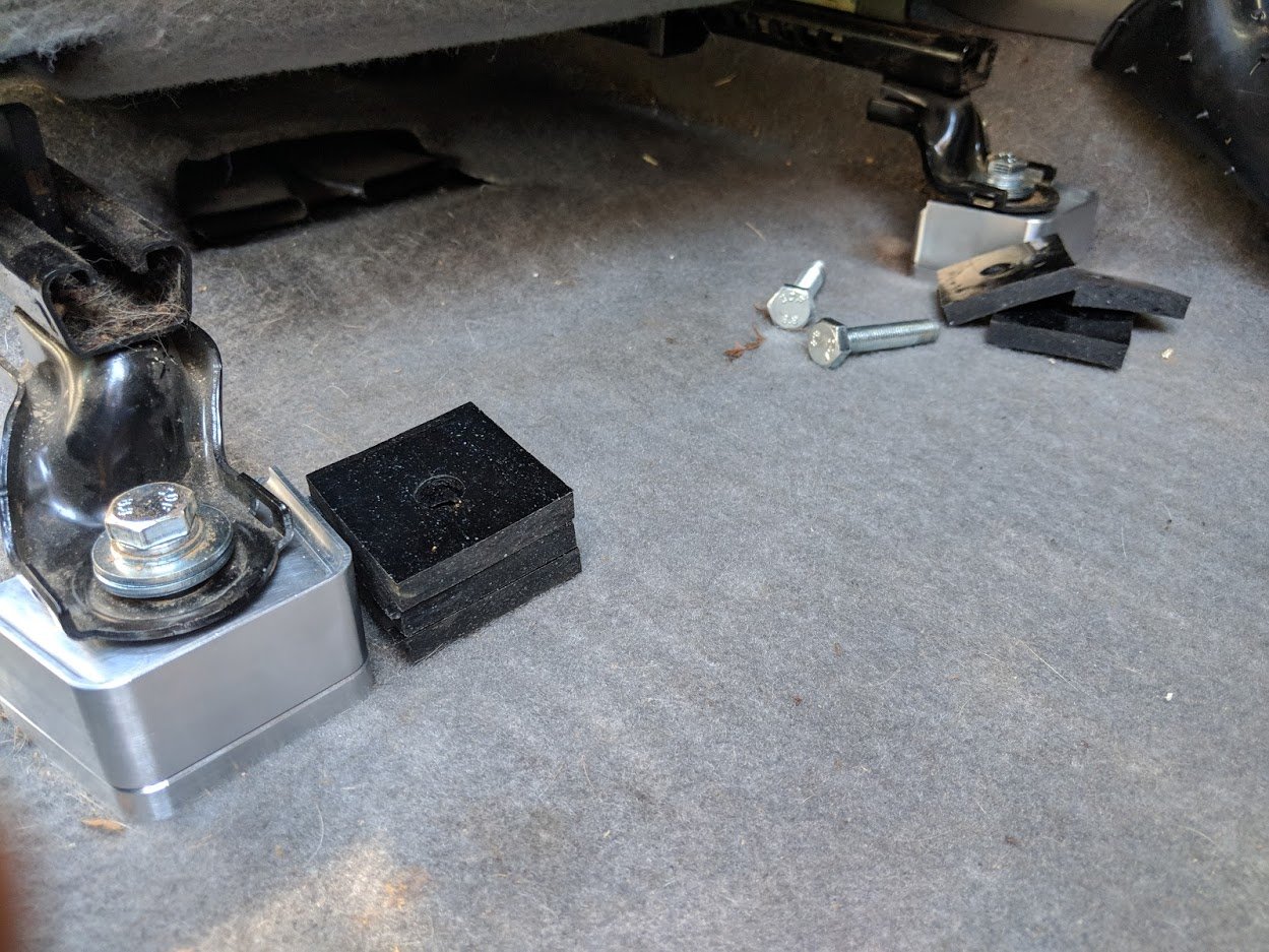

    Then put the new billet seat risers in yep had to have a couple of washers as spacers since no one local had any full thread or 60mm bolts or ones that were too small. So I had to settle for 70mm
    Out with the old spacers in with the new
    VGBO72v2LrwoTWDen6YBwCczujgpaY6k7mxt6_YF_4df383228c03f16c94c3f4956503f8c8fa269b80.jpg

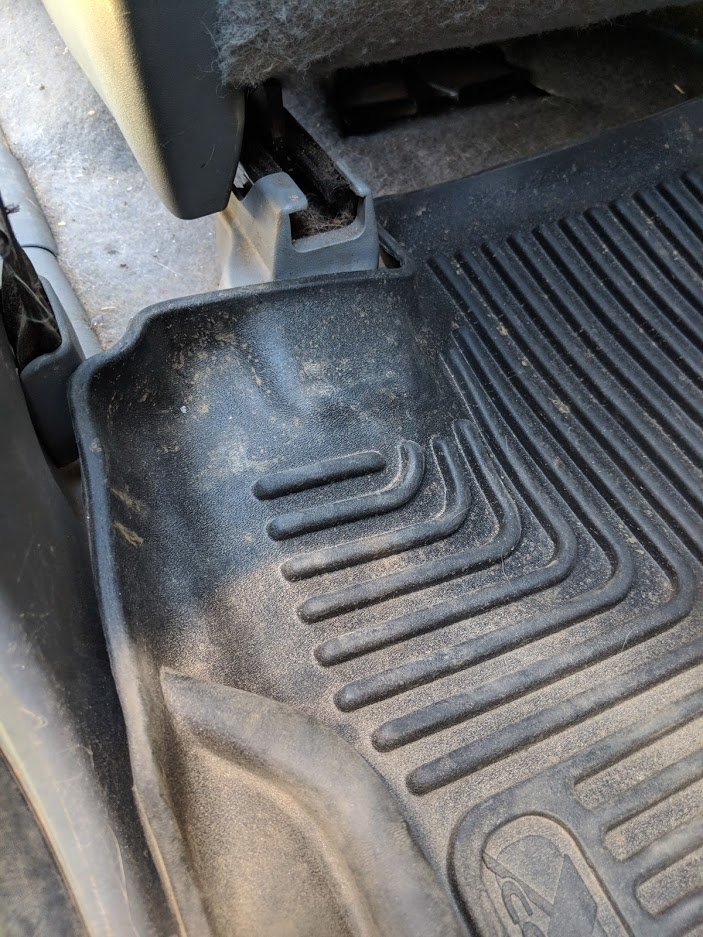

    Floor mat is a little wonky now but not terrible
    fJIFEQpuxZ52Vy2176PahnWoniBb7-RQaL2W-VPm_d7ff7678e197b17693d3bb3ce6388331e7a8824c.jpg

    Yeah, looks a little out of proportion, but whatever.
    16x8", 3.5" BS - same as F5's.
    HTF is your driver side rear toe so out of whack?

    I was more interested in the thrust angle after the 63 swap that was on the factory frame out at .7 before the swap now it's down to .4. That shows the relation of the front and rear axle and is the important measurement.
    Maybe a bent tube, poorly welded flange, worn bearing. I've seen some worse than that, sometimes it's just the machine notice how it's off a hundreth from before and after. Not going to worry about it till I start burning through bearings. It's been like that since I bought the truck. You should of seen what we ran on the circle track car. We purposefully added camber and toe to them and had to change bearings every 3rd race.
