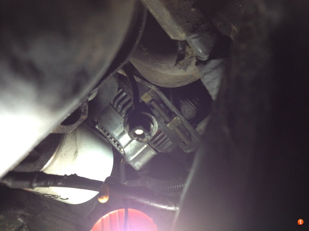

    Right there in the middle of the pic. It's an electrical connector or socket that's melted. Hangs down by the oil filter below the alternator. I looked above and am having a hard time tracing it. Anyone know what it is for?

    Ok, traced it to where it's wrapped with another wire that plugs in down by the thermostat housing. Any ideas what it's for?

    2002 Tacoma Double Cab 4x4 3.4l V6

    What size motor?
    It looks like the ground to your alternator but on my 3RZ, the alternator is no where near my oil filter.

    It's the 5vz engine. I getting no cel or any other odd electrical behavior either.

    View must be from the bottom looking up?
    I looked on mine and the only connection I found below the alt is for what appears to be either a knock sensor or a oil pressure sensor, right below the alternator in the block. Has just a single wire coming off it. Otherwise I have no clue what it is.
    There will be a few random unused connections in your wiring harness, nothing to worry about as these are meant for options that don't always come with the truck.
    If it runs fine and no CEL...:notsure:

    I took another look at mine from the top...
    Pop your hood and look at the spark plug wires on the driver side and see if the melted connection in question looks anything like those.
    Just a guess but looks like somebody changed plug wires and one fell down or wasn't removed for whatever reason.

    Yep, from the bottom looking up. Now that it's daylight I'll get a better pic from the top looking down.

    I thought plug wire too but the side it's on (drivers side) would have the boot on it and it's not that. Truck just had the original plug wires changed. I'm stumped!

    So it's wrapped with another wire. The wire it's wrapped with is plugged in to the block just below the tstat housing.

    How many wires go to the one that's just floating underneath the alternator?
    My geuss is that is the broken off oil pressure switch (the one that turns on the idiot light if u loose pressure). It seems pretty common for people to by accident break those off when doing a oil change. Take a pic of the portion of the engine just forward of the oil filter and I would be able to tell you.
    Actually I'm 80% sure that's what it is. Not many sensors are 1 wire sensors...

    Just one other wire that's plugged in to the block.
    I'll climb under the truck at lunch today and get a shot.

    ^^ This.
    There's only two plugs under the alternator. Crankshaft position sensor and oil pressure sensor. Crankshaft is 2 wires, oil pressure is 1 wire (green w/yellow stripe).
