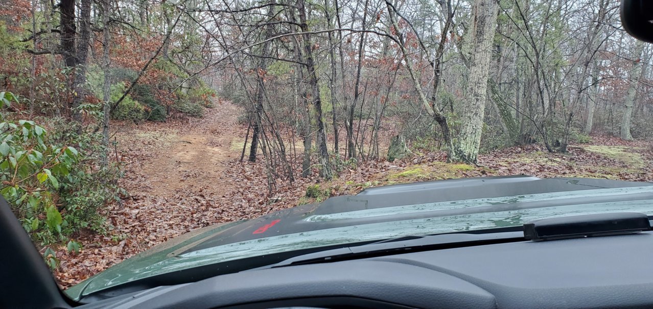

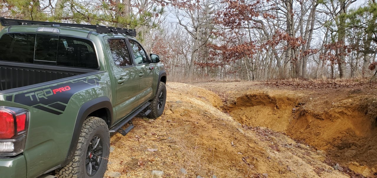

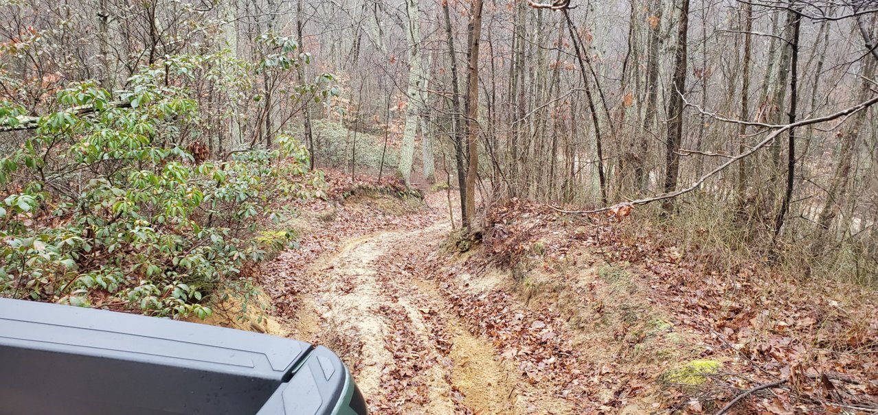

    Happy that I got the opportunity to use 4 Lo this morning. Had a blast going up some deep sandy hills (about 30% according to the uber accurate truck *scoff*)! Still have the warning stickers in my door like a nub.
    Super impressed with the traction on these tires in deep sand. This branch smacked the hell out of my roof, so I opted to back down the hill and take a path to the right of this ravine:

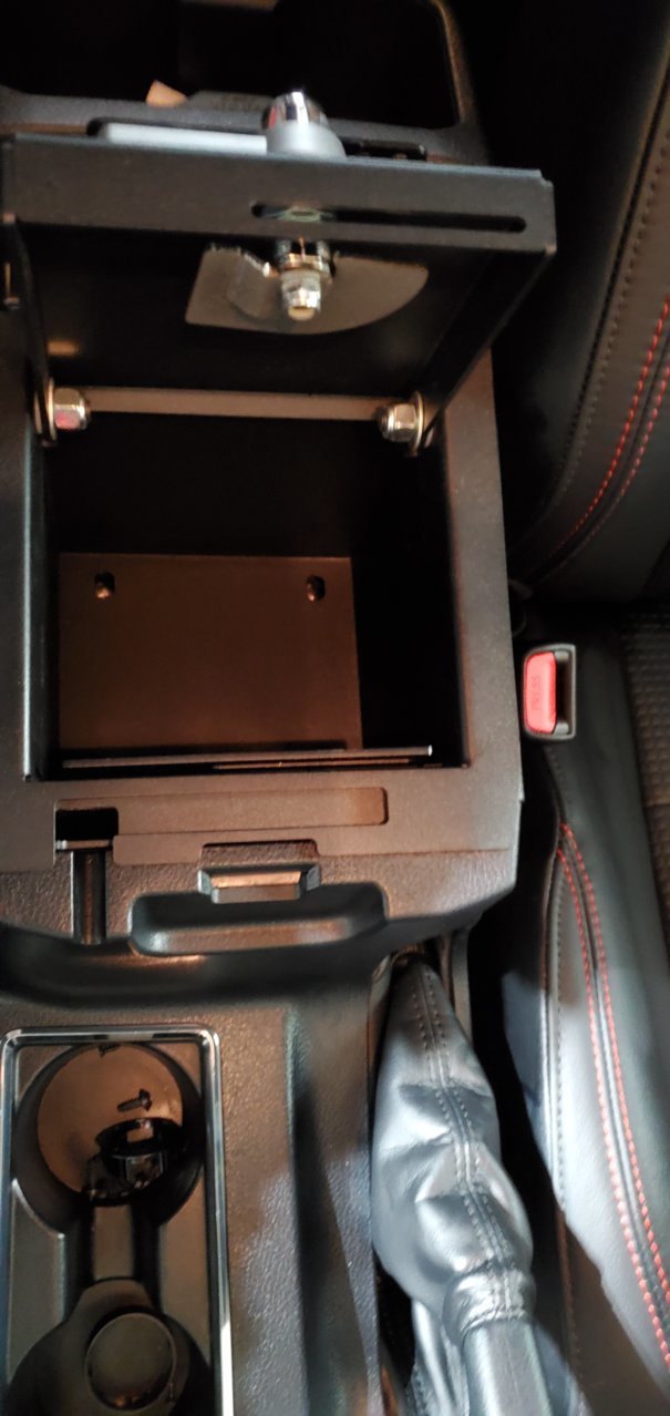

    Got a replacement console safe today and it showed up undamaged this time. Install was a breeze (total of 6 plastic screws and 2 10mm bolts). It fits exactly what it was intended to and has cutouts for cords as well as maintains access to the USB ports in the center console. HIGHLY recommend this for those looking for a bolt-in solution. Genuine Toyota P/N 00016-35874.
    You can see the cord cutout here in the lower left prior to installing the armrest again:
    Installed! Six plastic screws and some trim clips hold the center console inner to the armrest and four screws hold the armrest to the hinge:

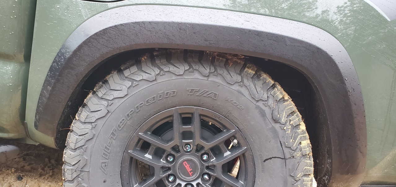

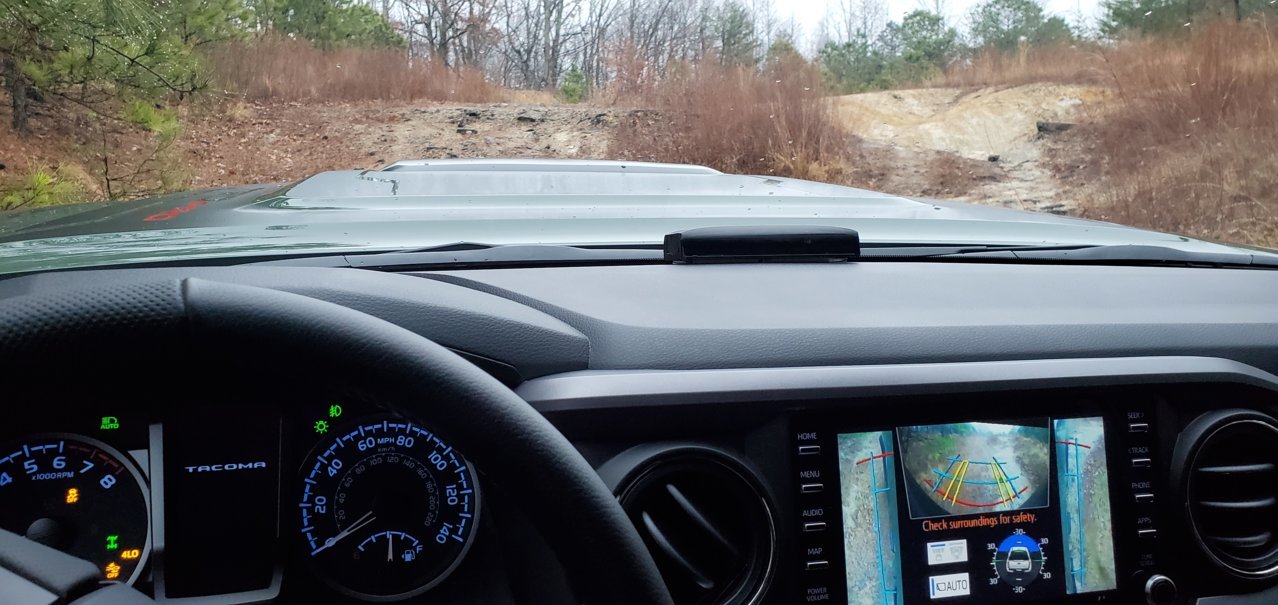

    Time for 4LO.
    Getting those K02s tucked!
    Can't have that many scratches, time to trim some branches.
    The cameras and pseudo-attitude indicator make me laugh every time. Must be for IG bragging rights.
    Water level is high today!
    The billy goat's hind after a South Jersey's finest wet sand bath.

    Very nice! You're seriously making me look at a UpTop Overland Bravo. Mind if I ask if you've had any rubbing on the trails with the 285's? I keep going back and forth between getting the 265/75's or just saying screw it and get the 285's. How's the daily driving on them too? Keep the updates coming! I'm anxious to see it once you get your Pace Edwards installed.
  7. Jan 3, 2020 at 9:18 PM
    #27
    TuRDLYFE
    TuRDLYFE [OP] Well-Known Member
    Nov 9, 2019
    #310230
    1,507
    An over-taxed town, county, and state
    2020 AG TRD Pro 6MT
    My gas mileage plummeted, but it's still very drivable for a daily. I was fully articulating the back today and had no issues with rub. YMMV. I'll keep posting as I continue to burn cash!

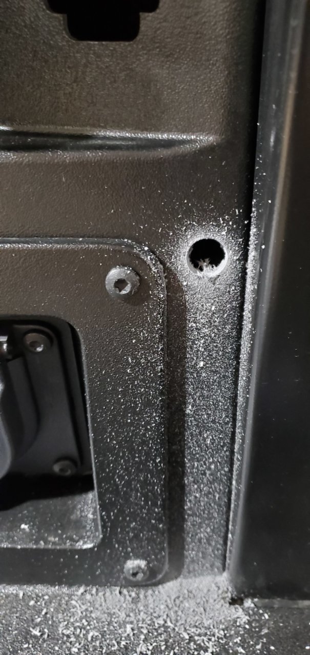

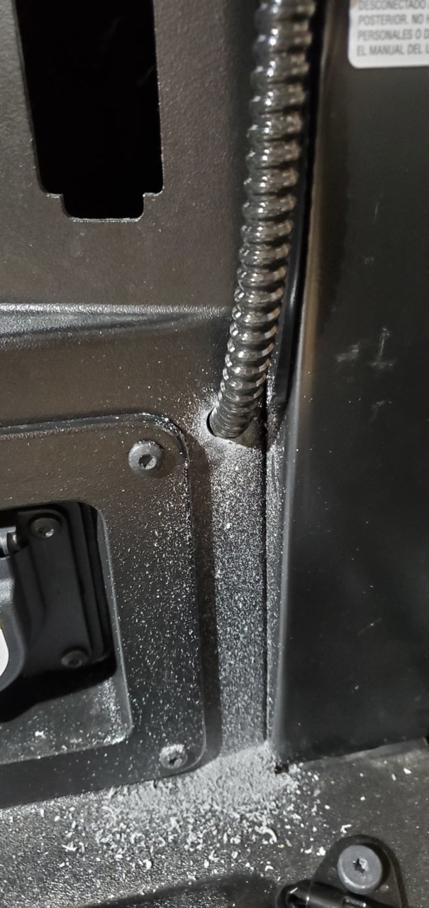

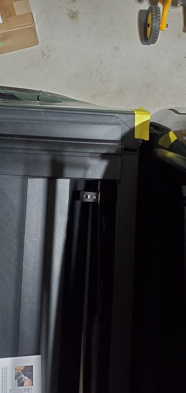

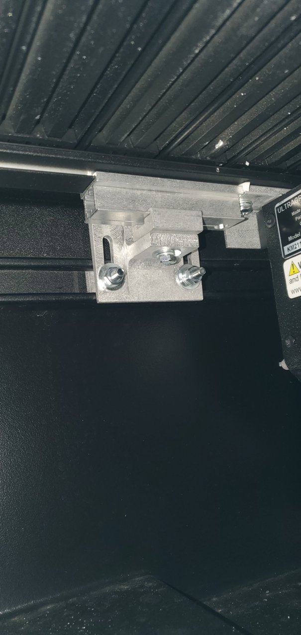

    Popped it open and started installing the Pace Edwards UltraGroove Metal cover (Model KMTA10A38). Pulled open the big box with my buddy and threw up the reel on jack stands to get it just above bed level. Everything was well marked (i.e. cab side, tailgate side)
    The side rails just tip into a slot on the side canister, slide forward towards the cab (with the canister remaining static), and are secured from the bottom with one each 1/4"-20 screw each. Once everything was lined up and seals on the tailgate were verified, I marked the front of the rails (on the cab side) with masking tape and pulled the whole assembly aft.
    Then install the gasket along the center of the front of the bed and slide the entire assembly forward. Once the canister and side rails are realigned with the masking tape, set the top cover in place and verify it mates on the underside with the foam gasket.
    Once that was done, I crawled into the bed and installed the hardware loosely.
    I fully closed the cover and REALLY crawled into the bed this time to tighten everything down.
    After opening the cover back up, I marked the aft portion of the bed insert (8" above the floor and 11/16" from the seam where it meeds the body), drilled a pilot, then used a 5/8" step drill to open it up for the rear drain lines on both sides.
    Then drilled out the factory drain holes at the front of the bed on the left and right side using the same 5/8" bit. The drain lines took some finagling to get installed into the canister, once they were in, give them a twist and run the drains down into the holes you drilled at the front of the bed. FYI, one sits right atop the muffler and the other atop the fuel tank. I recommend using a few zip ties on the right side to hold it to the frame away from the muffler. Also, if you fiddle with the one on top of the fuel tank, you can get it to bend enough so that it discharges off the side of the fuel tank rather than pools on top.
    Once everything was finalized, I threw on the canister cover, screwed it down and voila!
    This cover looks freaking amazing and operates like a champ. I'll post an updated review down the line, but my initial impressions are very good. Thanks, Leer!

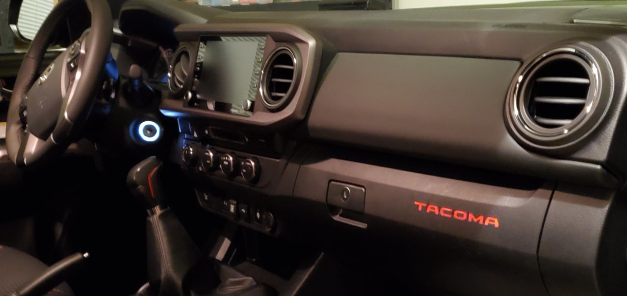

    After all that fun stuff, I went ahead and did some minor creature-comfort adds:
    Red Glove Box Letter Overlays
    Locking Fuel Cap
    Rubber Console, Door, Cup Holder Inserts
    If anybody wants the inserts for the front cupholders and tray, rear cupholders, phone bay (under the climate controls), and center console, let me know. THEY'RE ALL FOR THE AUTOMATIC TRANSMISSION! Otherwise, I'm just throwing the little pieces of rubber out. They're laser cut and fit perfectly.

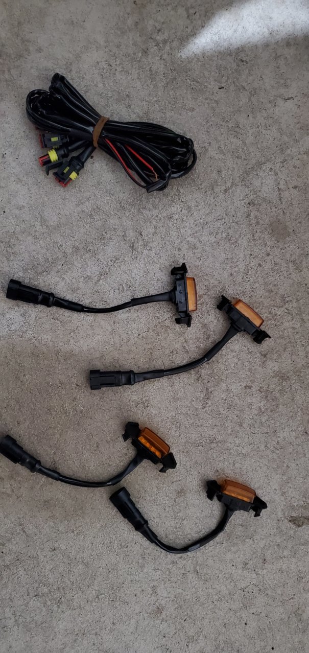

    @Btaco73 I told you I'd do it just for you.

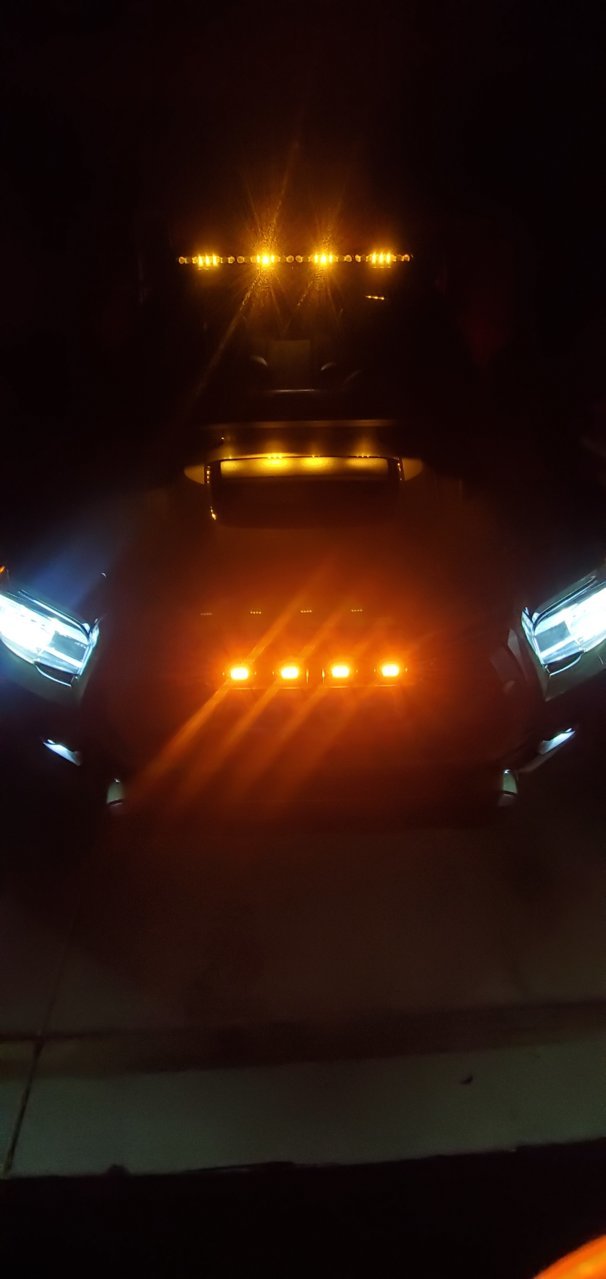

    Raptor lights installed (poorly as I have no intention of keeping them installed. The roof lighting is the backlight on my Baja S8.
    Overall approach to running the wiring was ziptie it randomly and often to fixed objects.
    Crimped on some terminals to the anemic wiring. I actually had to strip back twice the amount and fold the wire back on itself to get a good crimp. Sad.
    Wired into the same circuit as the S8 backlighting so they would trigger at the same time. The current draw is very small on both, I'm not worried about it. Although it looks less than great. Oh well, it's temporary-ish.
    The color has zero tone to it. It's just.. blah... like a c-list celebrity.

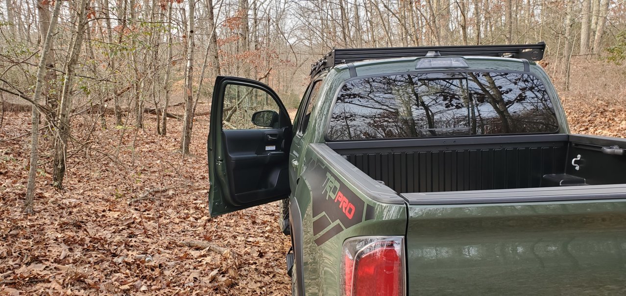

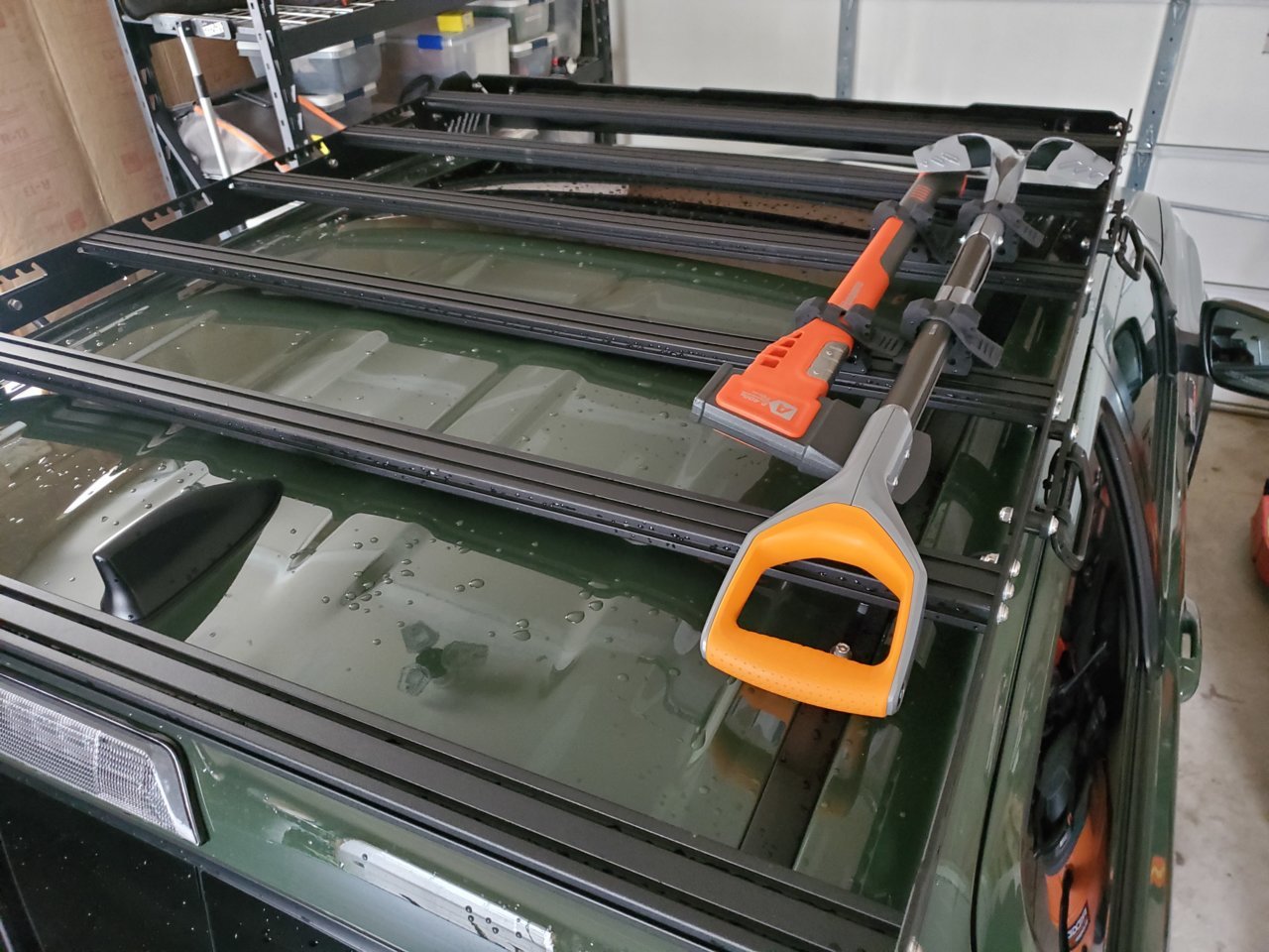

    Just got my Quick Fists installed into the Bravo rack today. Purchased the sliding T-nuts direct from the manufacturer and got some security screws to boot. Add in an axe and shovel and I'm just about ready to rock and roll. I'll probably slide the head of the axe aft so it rests on the crossbar and I don't risk it banging into my roof. Already used the shovel today in the terribly sandy soil around here.
